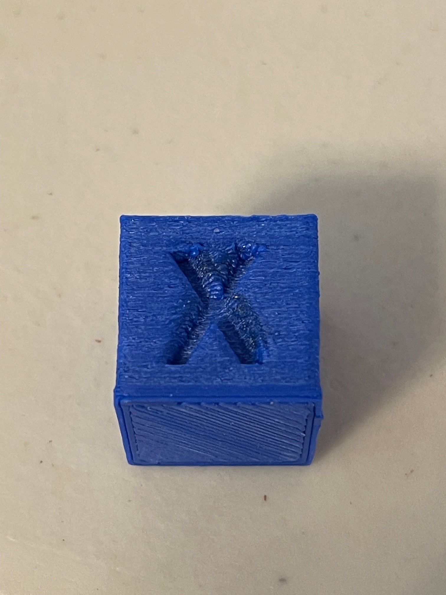

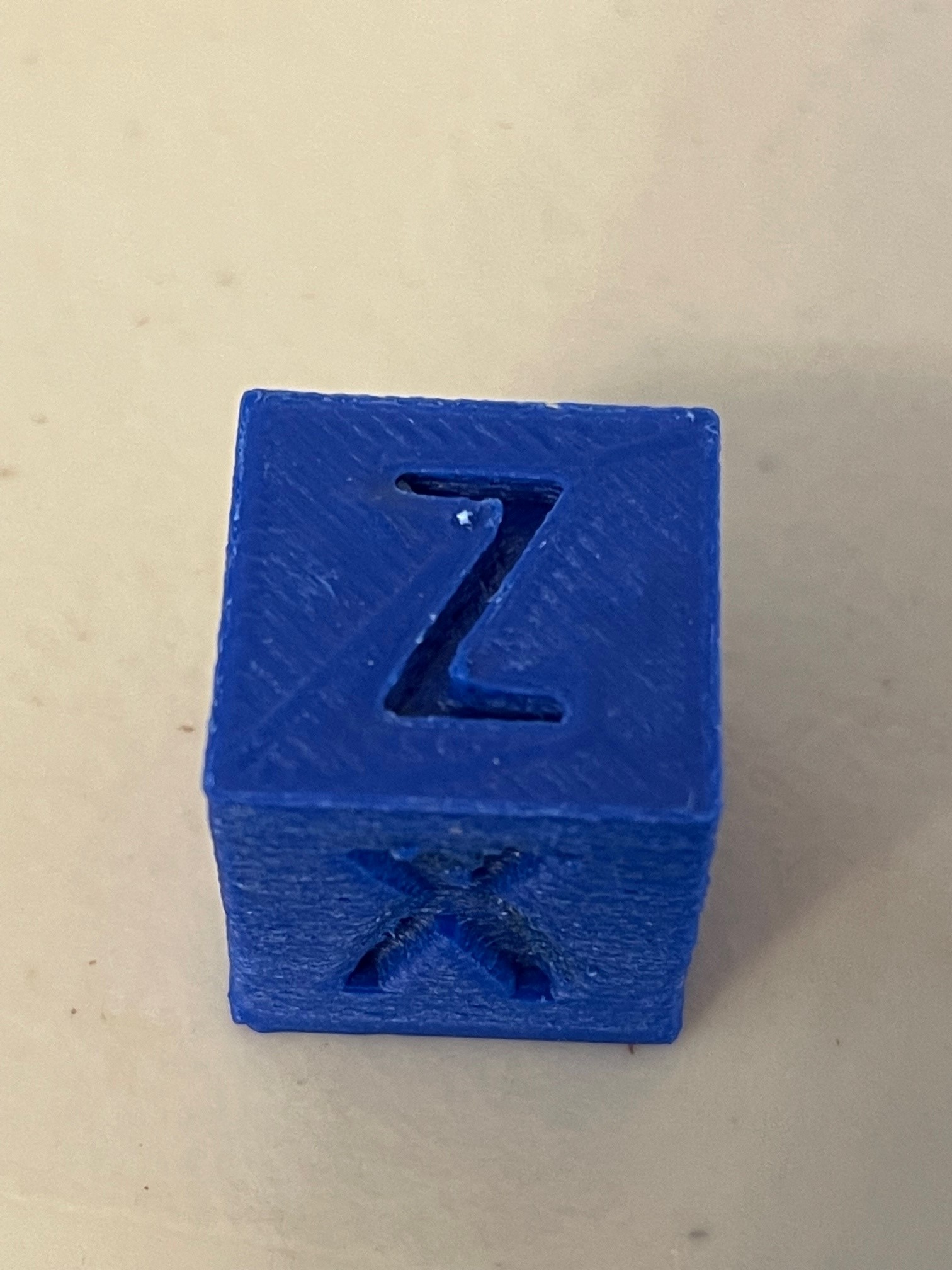

Here is a 20mm test cube I did. Machine is not in an enclosure yet. I need to work on that too.

Your cube looks overextruded. Check your esteps, that is not from a lack of an enclosure.

I know my Esteps are off. I do not understand why it lists 2 values and how to change it.
SENDING:M503
echo:Steps per unit:
echo: M92 X100.50 Y100.50 Z1600.00 E833.00 E1800.00
How do I change that value?
103.2 filament is fed when I tell it to feed 100mm.
**Post date:** [February 21, 2023, 7:00pm UTC](https://forum.lulzbot.com/t/my-first-3d-printer-journey-upgrades-used-taz-4-or-5/25053/26 "2023-02-21T19:00:34Z")
You change the value with an [M92](https://marlinfw.org/docs/gcode/M092.html) command, using the values you gave us and [this](https://www.th3dstudio.com/estep-calculator/) handy calculator the command you want is `M92 E807.17`.
As for the second E value, I have no idea where that comes from given we know very little about the firmware you have loaded. At the very least, the output of [M115](https://marlinfw.org/docs/gcode/M115.html) would help.

There is most definitely some strange firmware going on… unless he changed it without mentioning it in since the photos - [https://us1.discourse-cdn.com/flex020/uploads/lulzbot/original/2X/f/f85538a997773a74baba6825635465a0d2a9bf59.jpeg](https://us1.discourse-cdn.com/flex020/uploads/lulzbot/original/2X/f/f85538a997773a74baba6825635465a0d2a9bf59.jpeg) - it’s marlin from 2014. Documentation on that version is lost to an archive somewhere.
If it hasn’t already been changed, it can be updated to a completely up-to-date version of marlin. Load up Cura LE and load custom firmware, point it to Load firmware for a Taz 5. The one you probably want will be found at “Program Files (x86)\cura-lulzbot 3.6\resources\firmware\Marlin\_TAZ5\_SingleExtruder\_2.0.0.144\_aded3b617.hex”
That firmware will only do a single toolhead, so you won’t have to worry about multiple extruder esteps.

Yes, the firmware got updated when I installed the Cura LE. I did the M92 E807.17 and the filament pull was dead nuts on after that. My cubes still looked bad after and my friend said it looked like my nossel was dragging through what was printed smooshing it all around. That explained the weird look of the walls. And that started the discussion on what size nozzle is on there. Cube dimensions when done were still good so I know it is not my z steps.

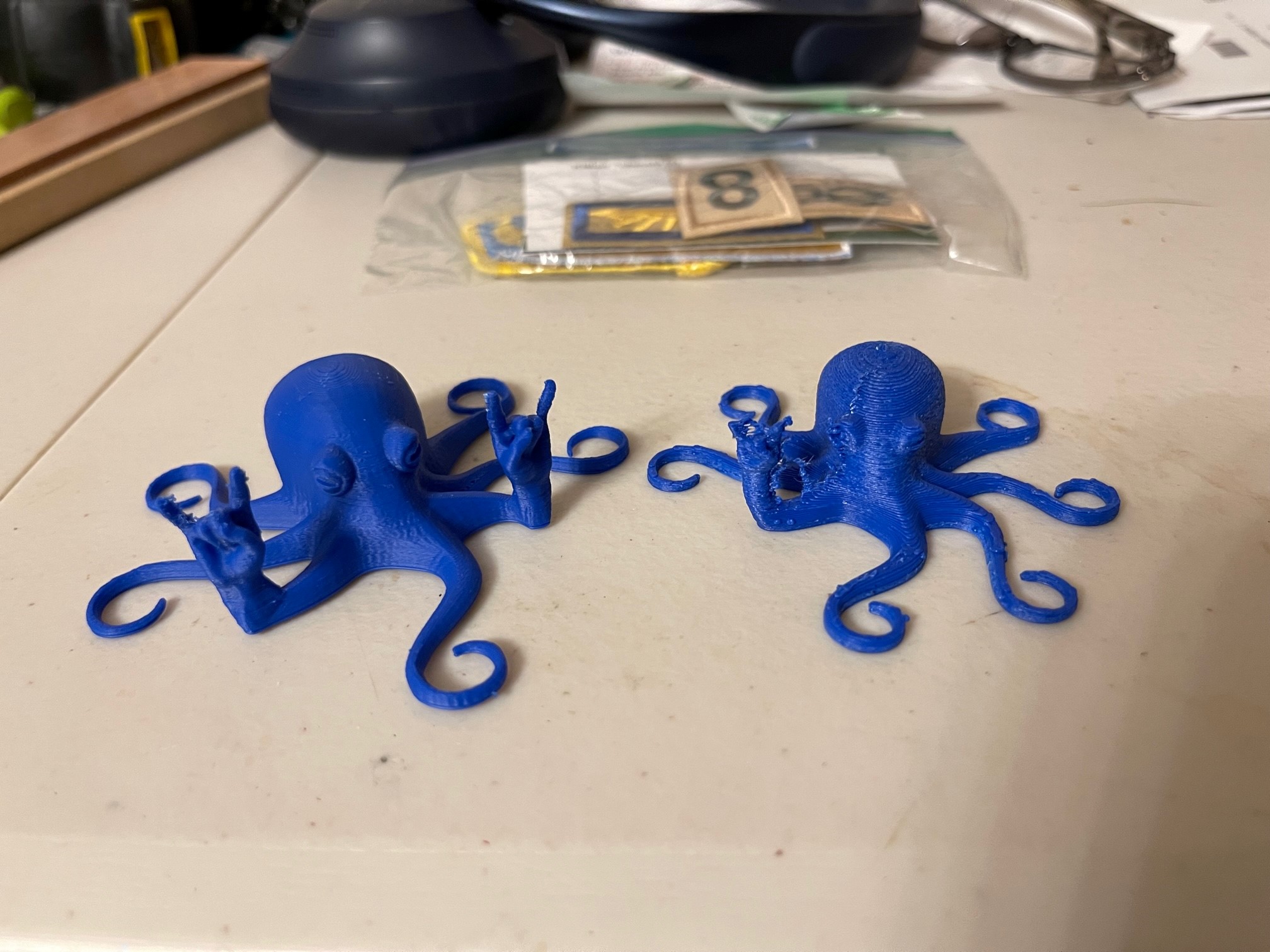

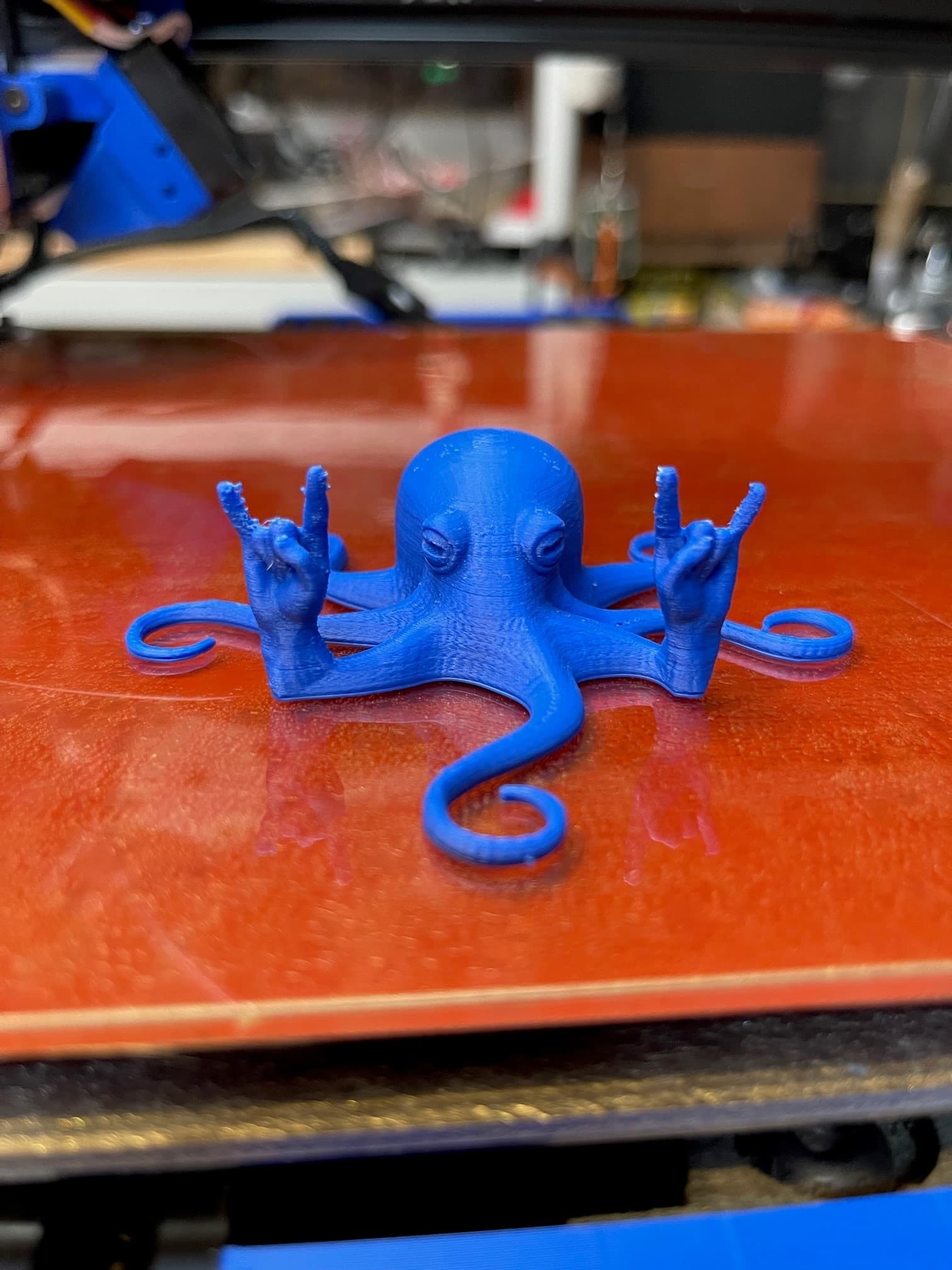

Rocktapus came out way better this time.

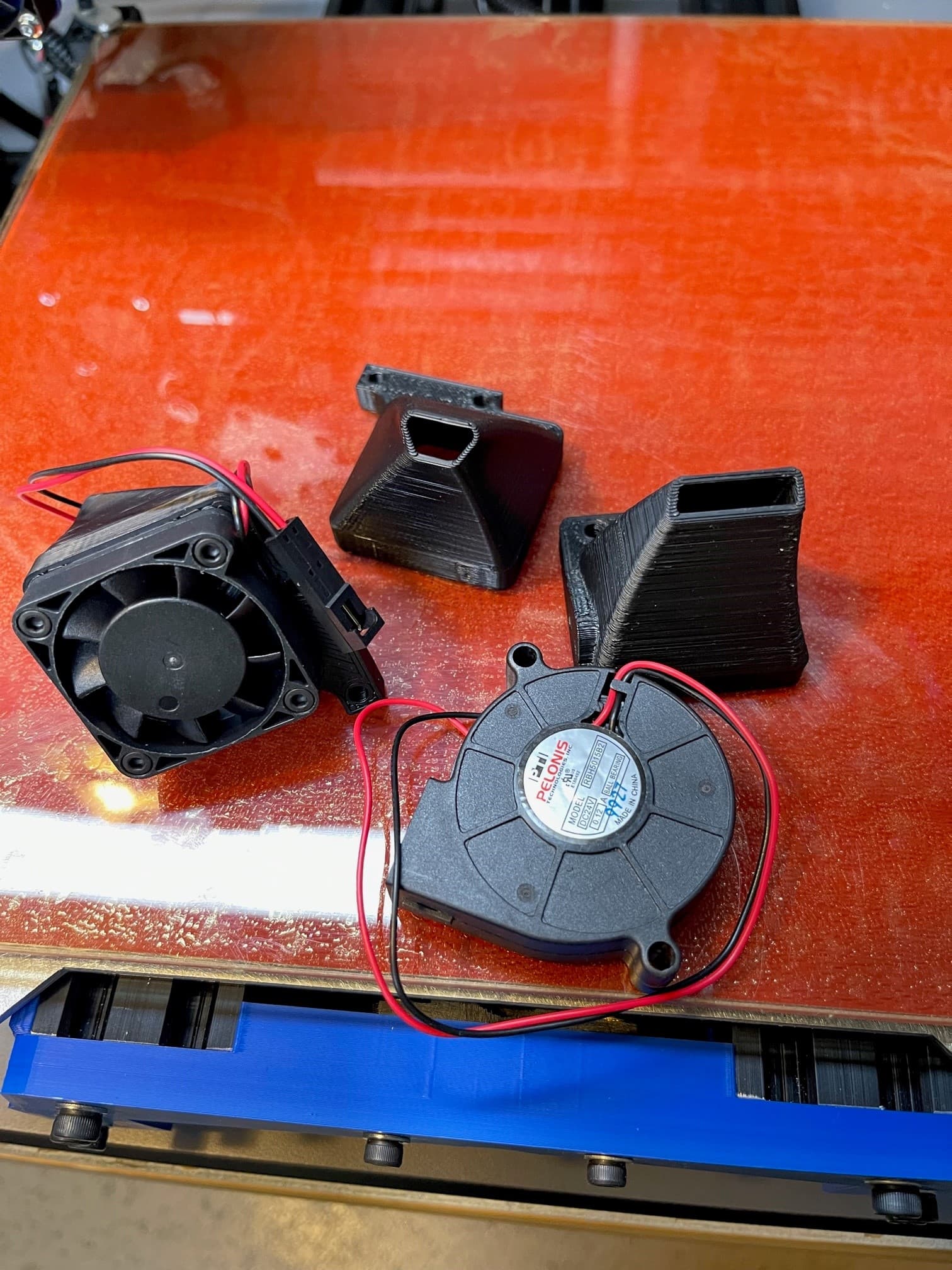

Here is what I have for Part cooling options that all do not work with the mount I have:
 ![Part cooling options](https://us1.discourse-cdn.com/flex020/uploads/lulzbot/original/2X/2/2623eb7b4d1a31e8dad675d4609cd1f8d8afe8a0.jpeg)

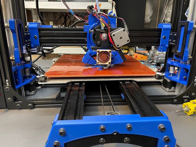

And here is the mount. This is how it was when I got it.
 ![Extruder mount left](https://us1.discourse-cdn.com/flex020/uploads/lulzbot/original/2X/a/a7aa4dd2b1c146873a6155b7bf199040bde512b7.jpeg)
 ![extruder mount right](https://us1.discourse-cdn.com/flex020/uploads/lulzbot/original/2X/7/78b8c28bc435fbe0cb5b3196463fb0c47eb8e48e.jpeg)
I am open for suggestions on where to go now. At least I think I can print parts now.
**Post date:** [February 25, 2023, 12:15am UTC](https://forum.lulzbot.com/t/my-first-3d-printer-journey-upgrades-used-taz-4-or-5/25053/35 "2023-02-25T00:15:06Z")
I haven’t seen anything pre-made for a 5015 on a Taz 5 head, but blower fans make enough pressure to get through most half-assed attempts at cooling ducts if you feel like busting out the CAD software.

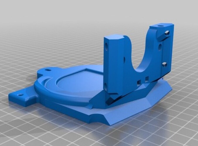

I want to print out this extrusion mount so I actually have some options to make a part cooling duct.
> **[TAZ 6 Upgrade and Modifications by keithjjones](https://www.thingiverse.com/thing:1499551/files)**
> If you are like me, you upgrade your TAZ any time new improvements are announced. Lulzbot has released the TAZ 6 parts at http://devel.lulzbot.com/TAZ/Olive/ and https://ohai.lulzbot.com/group/taz-6/
> I purchased my TAZ back around the AO and TAZ 1...
 ![extrusion mount pic](https://us1.discourse-cdn.com/flex020/uploads/lulzbot/original/2X/5/5db6eb0294ef5edd300e3b16f4244815bbb29c12.jpeg)
Will this work for me?

I have finally printed something for the printer. I have a little bottle of acetone with a needle applicator that I used to hit some of the layers to make sure they were nicely bonded to make sure there was enough strength to support the print head.
It fit nicely and seems sturdy printed with 80% infill. I do not know how much part cooling is needed for ABS printing. It seems to cool pretty fast. And I wonder if it would harm layer adhesion. I know other stuff likes being cooled so I figured I would get set up for it. Time to print a rock2pus and see how it works.
 ![dual coolers](https://us1.discourse-cdn.com/flex020/uploads/lulzbot/original/2X/6/6b2bbb5bab3b06493e47f725448df7cb15be76a4.jpeg)
I am going to attempt to make a new piece for the heat-brake fan. Right now it is only hitting the top half of the hexagon heatsinks. Might as well make the fan exit less restrictive and cover the whole heatsink.
So far so good.
**Post date:** [March 1, 2023, 4:53am UTC](https://forum.lulzbot.com/t/my-first-3d-printer-journey-upgrades-used-taz-4-or-5/25053/39 "2023-03-01T04:53:12Z")
With ABS, it’s generally _zero_ cooling unless you’re doing bridging, overhangs or layers that will be done too fast to allow any cooling. ABS is known for poor layer adhesion, and with a fan going, it’s really bad. I limit my fan to 3% max when doing ABS.
If you’re printing fairly well, you should look into doing some temp towers, fan towers, and other fine-tuning calibration prints

 ![double puss](https://us1.discourse-cdn.com/flex020/uploads/lulzbot/original/2X/d/d17eae1dac17c579e06b7874a0f4f6514c4096b8.jpeg)
Now that I have a fan setup I can tune the PID for the temp and some of those other fine tuning prints you are talking about Wrathernaut. I have seen examples of 2 towers next to each other. That should help with things like the fingers here.
 ![rock2puss front](https://us1.discourse-cdn.com/flex020/uploads/lulzbot/original/2X/c/c682aa4309a6442caa28ed88affa85be640c6d3d.jpeg)
Temp, retraction, and fans I bet all play a part in this. Ohh and an enclosure. I need to make one of those too. I have an idea using some openrail and clear vinyl sheet. Just something to keep the air still and keep in some heat while still being able to see what is going on.
I hear an enclosure helps a lot. I need to find it a home NOT on my workbench lol.
**Post date:** [March 1, 2023, 8:25pm UTC](https://forum.lulzbot.com/t/my-first-3d-printer-journey-upgrades-used-taz-4-or-5/25053/41 "2023-03-01T20:25:01Z")
That’s a huge improvement with just the rocktopus. Blobs are typically a retraction tuning issue, but can also be temperature. With it mostly on the fingers, I’d be inclined to go with general oozing. A combing option might help (can’t remember if this is part of Cura or prusaslicer, or both).
With a 2.85mm tool head, oozing is inherently going to be worse than 1.75, simply due to the higher volume of melted filament in the hot end at any given time.
