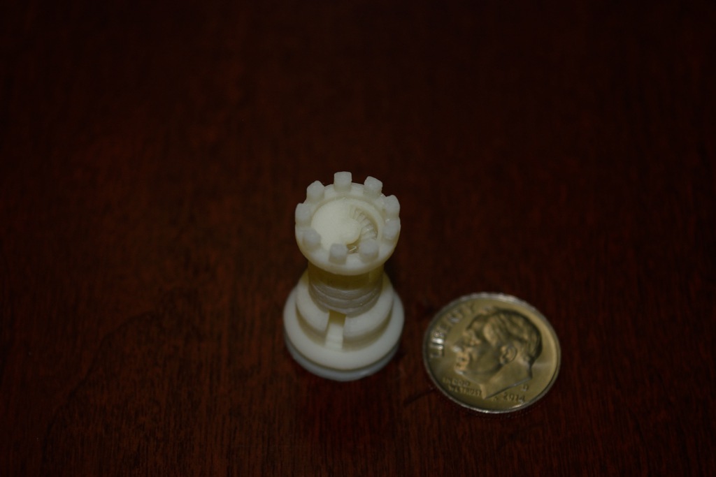

Here is a .08 layer print using a .25 nozzle I just finished. sliced and printed with Cura. I am very happy with the results!
The total height is 1", diameter is 19/32". The print was 317 layers printed in just over 1 hour.

Not too bad for a Kittaz!
Scott
