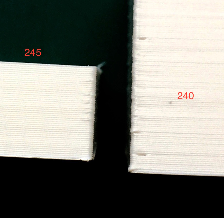

Crazy difference between 240’c and 245’c
 ![IMG_5987.jpg](https://us1.discourse-cdn.com/flex020/uploads/lulzbot/original/2X/0/09db208e60d2a220aa40cfef0c09c06ea86bf22d.jpeg)
**Post date:** [June 19, 2016, 1:09am UTC](https://forum.lulzbot.com/t/my-printing-journey/3606/26 "2016-06-19T01:09:26Z")
Yeah, white filament is weird with temperature, and it seems to vary by roll, but its either 5 over or under.
