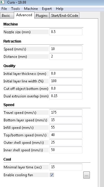

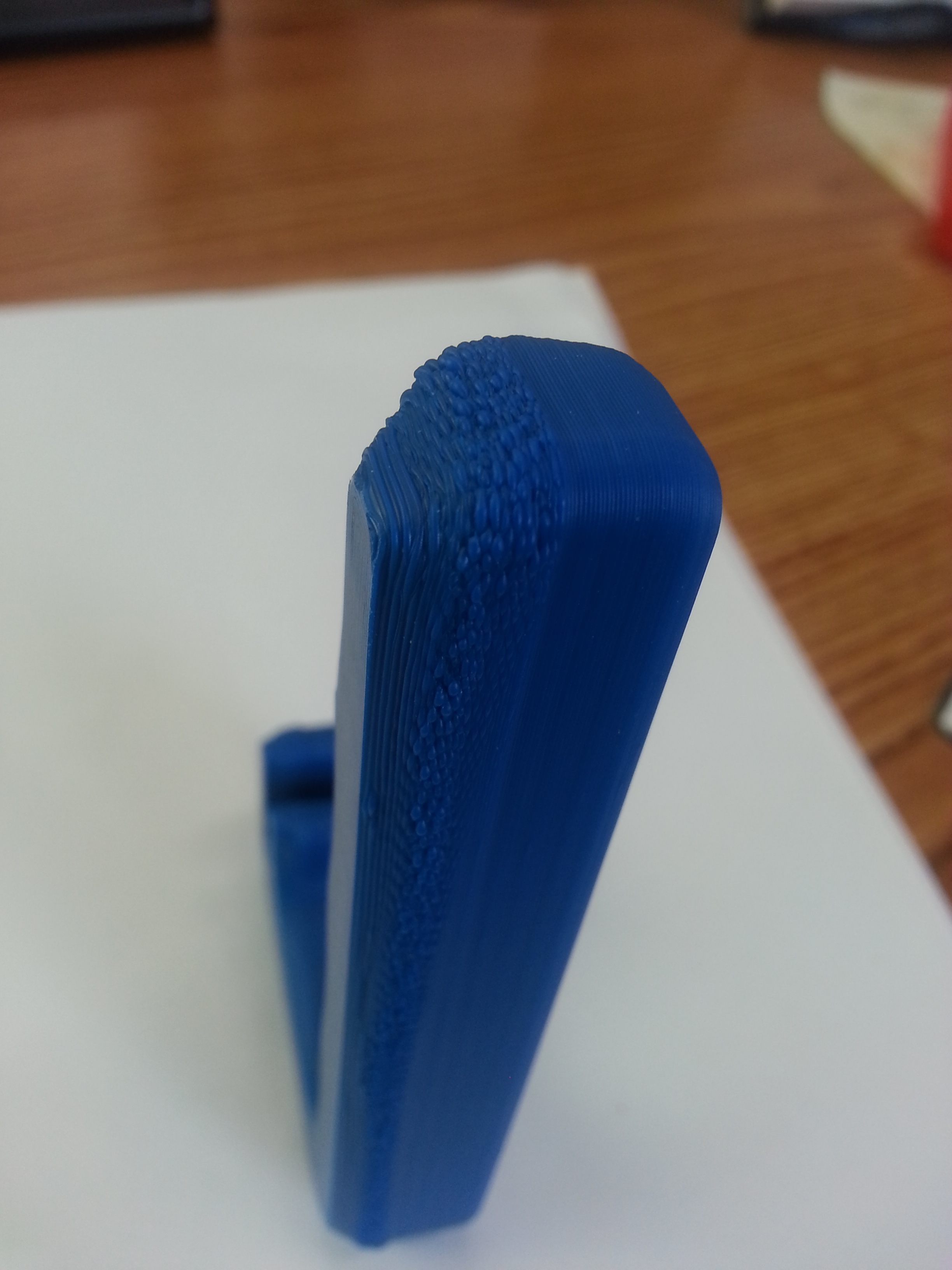

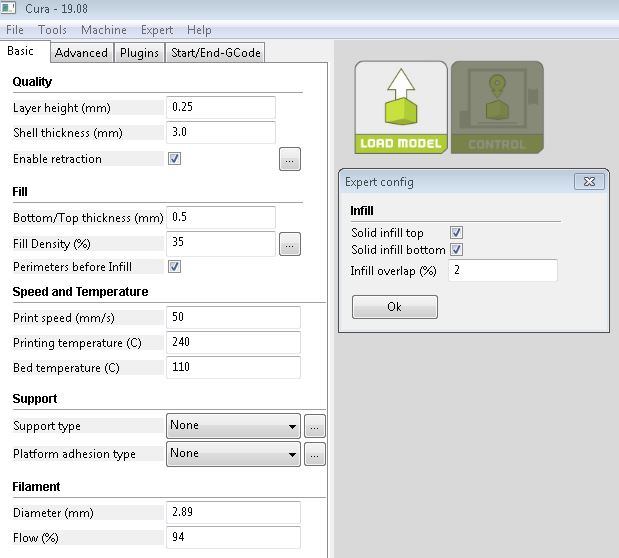

I’m at a loss. I’m making a handle but running into issues. I was making the handle into 2 halves and gluing them together, but ran into issues with bubbling/rough layers. I worked thru the calibration & setting to get the 2 part handle fixed.
Then I thought for now I’d just make the handle as piece and allow the Cura software deal with the infill. So I loaded my solid handle, used the same settings for it as I had the 2 piece version, but changed the infill from 20% to 35%. So why is the lower radius on this 1 piece handle soooooo bubbly/rough, but the upper radius look good??? I’ve attached pic’s of my settings too. Hope it helps.
 ![20160427_102042.jpg](https://us1.discourse-cdn.com/flex020/uploads/lulzbot/original/2X/a/a8f2ea80a364b5db190afd4e13da097acd5472a5.jpeg)
 ![04-26-16_Advanced.JPG](https://us1.discourse-cdn.com/flex020/uploads/lulzbot/original/2X/9/9a2e323e9f12ee40d23d11121d92a051df2ed43d.jpeg)
 ![04-26-16_Basic.JPG](https://us1.discourse-cdn.com/flex020/uploads/lulzbot/original/2X/5/5c0b6fab19c6c808dc0d29438897742e73e00c7e.jpeg)

I can’t see real well but it could be that the machine has to print in mid-air (overhang) at the bottom to increase the radius but when it has to decrease the radius, it does not have to do this because the wall it thick. If you could see inside the part, you might see the same thing on the inside when it decreases the radius.
**Post date:** [May 4, 2016, 1:25am UTC](https://forum.lulzbot.com/t/needing-cura-setting-suggestions/3306/9 "2016-05-04T01:25:39Z")
You need to turn on support. I don’t know Cura but that sudo rounded section needs it otherwise the printer is trying to print in mid air and that is why it looks bad.
**Post date:** [May 5, 2016, 1:44pm UTC](https://forum.lulzbot.com/t/needing-cura-setting-suggestions/3306/10 "2016-05-05T13:44:57Z")
The bottom radius doesn’t look as good because it’s an overhang. The first few layers are printing at an angle shallower than 45 degrees. In order to improve this, either print this part vertically so that the radius isn’t overhanging, use support in Cura, or the best way, I’ve found, is use the support method found in Meshmixer.
Either way, you need support if you’re going to keep the part in this orientation.
