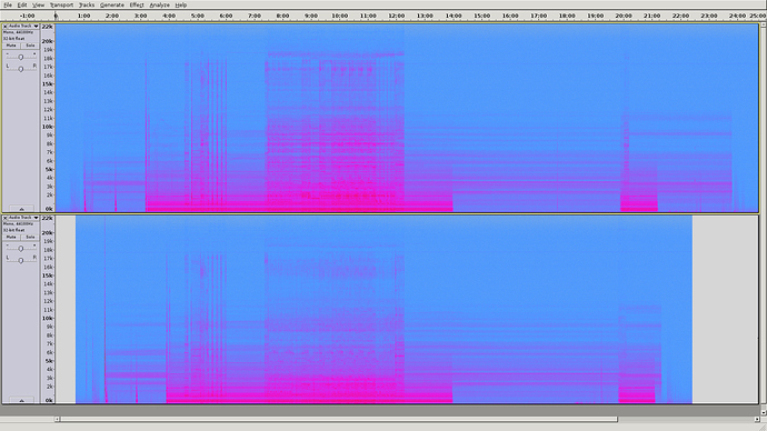

I installed a vibration dampener on my Y motor and it is significantly better. Moons Motors sent us this particular dampener. R&D has tested some others in the past. We also have a lot of cork dampeners. The one we have from Ultibots, IIRC, requires the pulley to be removed. But the Moons ones have a large enough center hole, that it isn’t required.
I did a before and after audio recording of a mustache ring print using Audacity (in a non-studio/homebrew setup).
 ![compare-moon-std.jpg](https://us1.discourse-cdn.com/flex020/uploads/lulzbot/original/2X/3/347f9f5239a32dbfcf97fc7078da7327d8d58097.jpeg)
