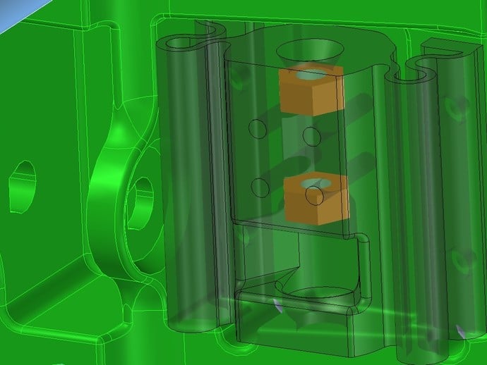

> **[Taz Z Motor coupler by jwest007](https://www.thingiverse.com/thing:162711)**
> Replace your existing z motor to all thread coupler and never ever worry about this part coming loose again! I have tried several different solutions including thing 117950 by 1013 (http://www.thingiverse.com/thing:117950/#files).
> Until now his...

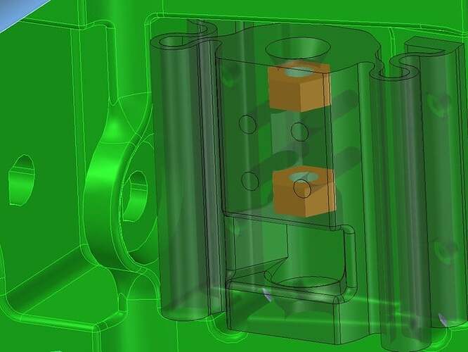

Replace your existing z motor to all thread coupler and never ever worry about this part coming loose again! I have tried several different solutions including thing 117950 by 1013 ([Lulzbot TAZ anti-backlash Z-nut and motor to M6 mount mod by 1013 - Thingiverse](http://www.thingiverse.com/thing:117950/#files)).
Until now his motor to M6 connector was the best option.
 ![image.jpg](https://us1.discourse-cdn.com/flex020/uploads/lulzbot/original/1X/1c19507506c1f7b9d1f53db1177f742e18dab5c7.jpeg)
**Post date:** [October 9, 2013, 4:37am UTC](https://forum.lulzbot.com/t/new-and-improved-z-motor-shaft-coupler/287/2 "2013-10-09T04:37:15Z")
Interesting. it’s certanly never going to accidentally come loose thats for sure. Is there enough flex in it so as to not induce slight part layer shifting? Or are the TAZ springs able to fully absorb that?

The new beefier springs by 1013 on thingiverse is the way to go and, yes, it can absorb the unwanted movements.

Not necessarily slipping, but there is rotational flex, which will mean Z-axis errors when it raises and lowers (hysteresis errors). you can see this yourself by rotating the threaded rods by hand while the motors are on and holding position. they will rotate 5 or 10 degrees in both directions.
In an Ideal motor coupler you want some flex in position and axial angle, but ZERO rotational flex…it is hard to get that in a coupler, especially a printed one.
This coupler does look a little stiff to me. but as long as everything is aligned and your threaded rods are very straight, it should work fine.

When I used the tubing I didn’t notice a huge concern. The torsion slip 1013 is talking about can be minimized with a reduced length of tubing. However, he is correct on this matter. On the other hand, a very strait threaded rod is good to have in theory, but I have a little “wobble” in the x-y plane and this is fully absorbed by 1013’s z-springs.

The threaded rods have a pitch of 1mm (1mm Z travel per revolution). so if you have a worst case scenario of 10 degrees of torsional flex (both directions) then you have a Z travel of 0.056mm ((1mm/360 degrees)\*20 degrees).
this is not much to worry about for most prints at 0.25mm layer thickness (22%). but if you try some 0.10mm layer prints, then it will likely become more of a problem…
