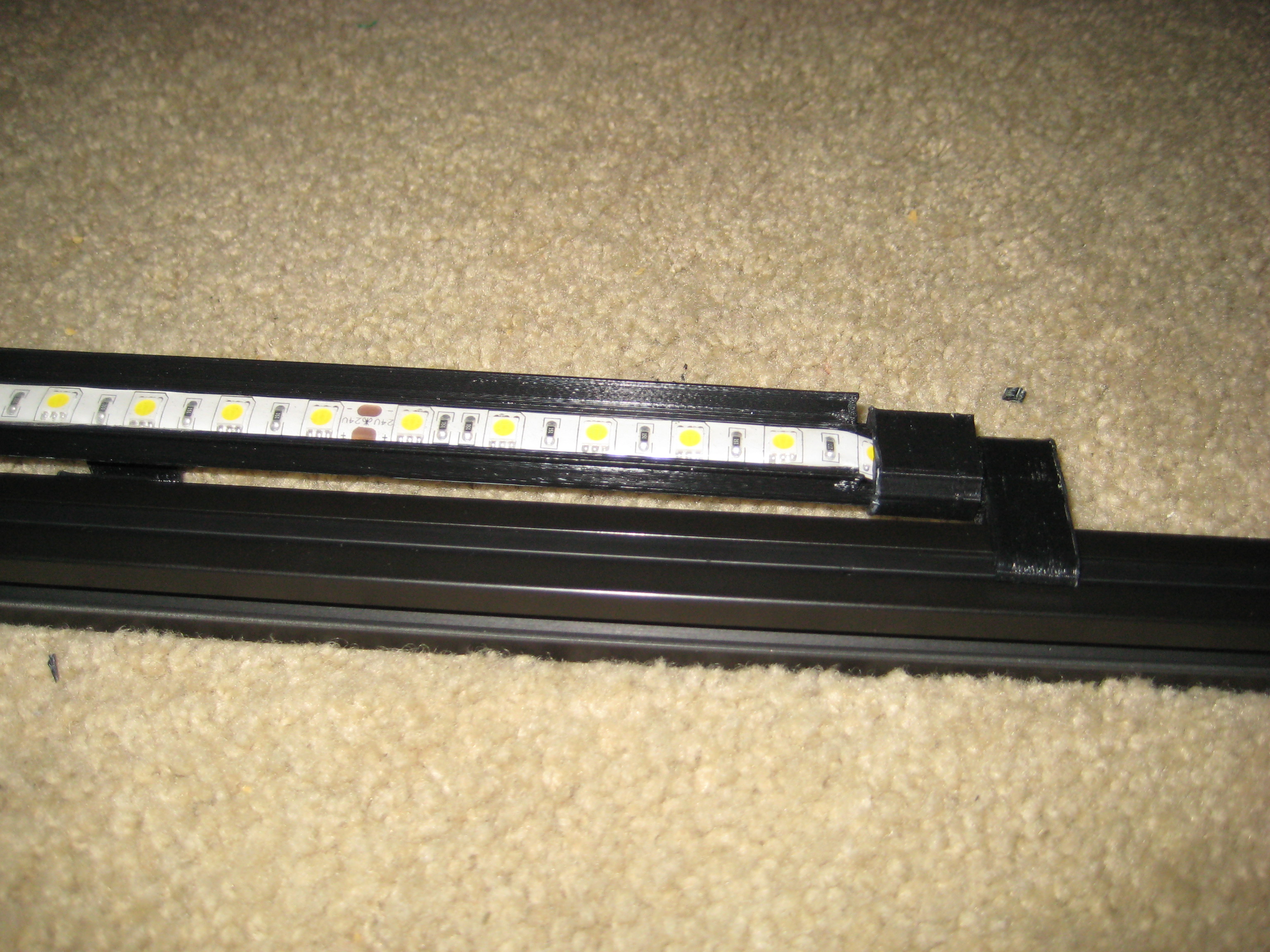

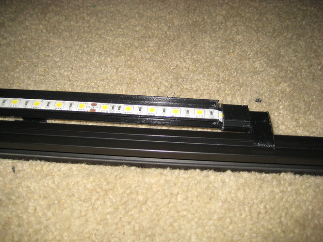

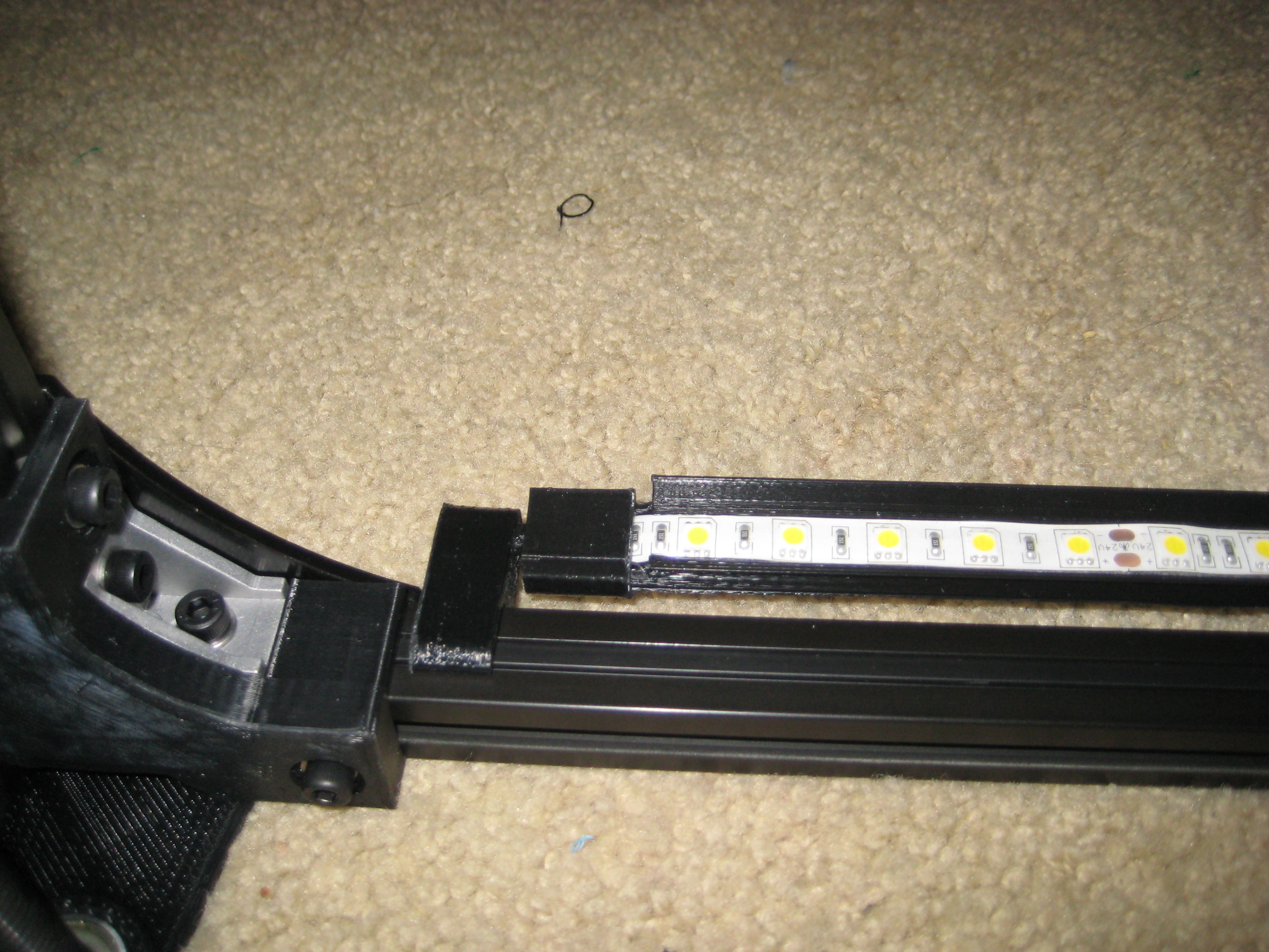

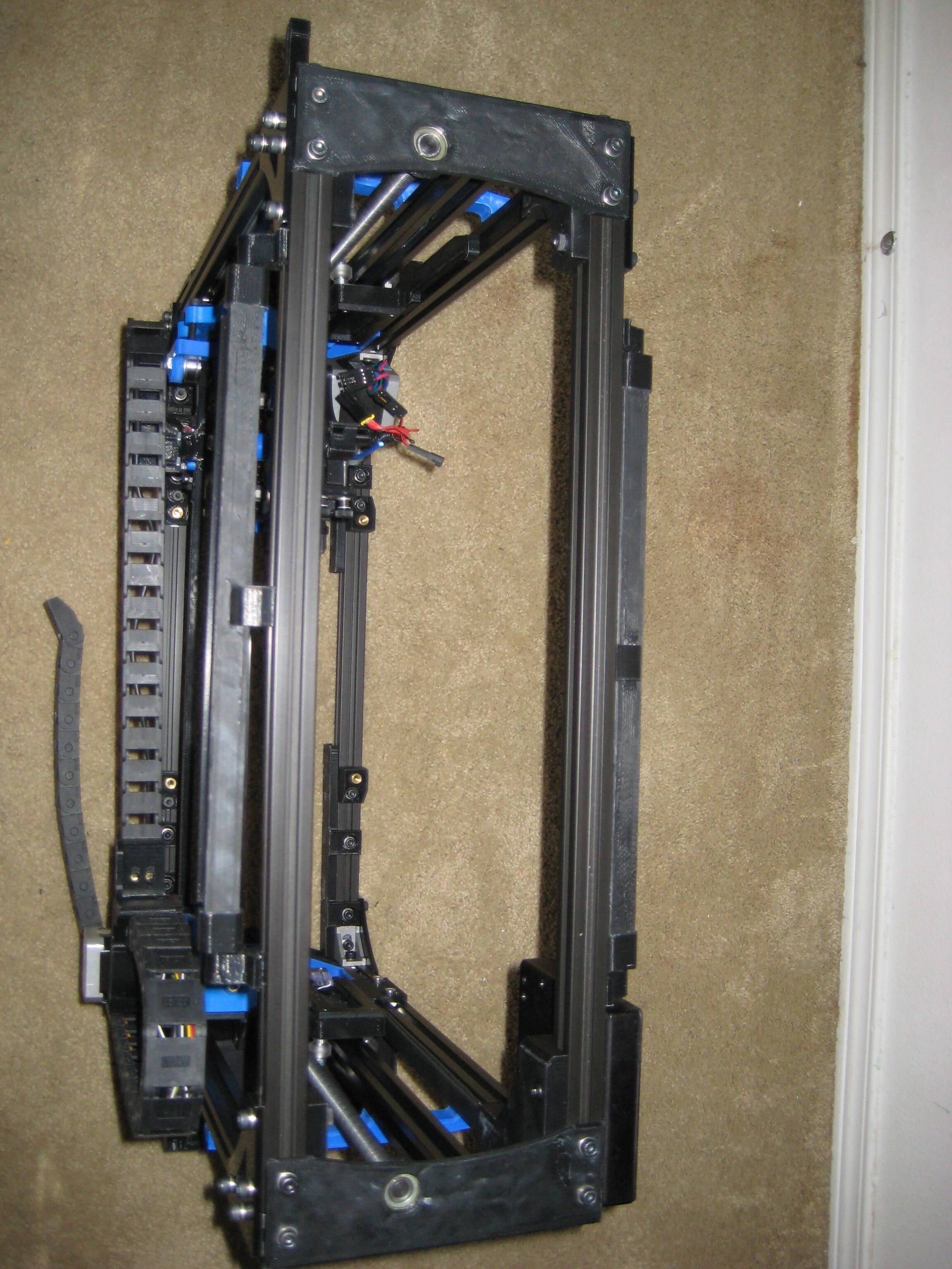

I finally got around to uploading my new lightbar version. You can find it here: [http://www.thingiverse.com/thing:1803781](http://www.thingiverse.com/thing:1803781) . This one includes some shorter bars for use with smaller printers as well.
 ![IMG_2529.JPG](https://us1.discourse-cdn.com/flex020/uploads/lulzbot/original/2X/a/ab2d84d1a44eea0bad04b72d88a56e74300a35cc.jpeg)
 ![IMG_2530.JPG](https://us1.discourse-cdn.com/flex020/uploads/lulzbot/original/2X/5/5159729e5bfc077dc4b815eab3cdc819d6604147.jpeg)
 ![IMG_2528.JPG](https://us1.discourse-cdn.com/flex020/uploads/lulzbot/original/2X/1/10485c34631da5e25790f294e33e1a05bce1b436.jpeg)
 ![IMG_2525.JPG](https://us1.discourse-cdn.com/flex020/uploads/lulzbot/original/2X/6/61396cd677fbe60cf0b93dc42e531f9880589343.jpeg)
also some new pictures of the bottom wire covers
