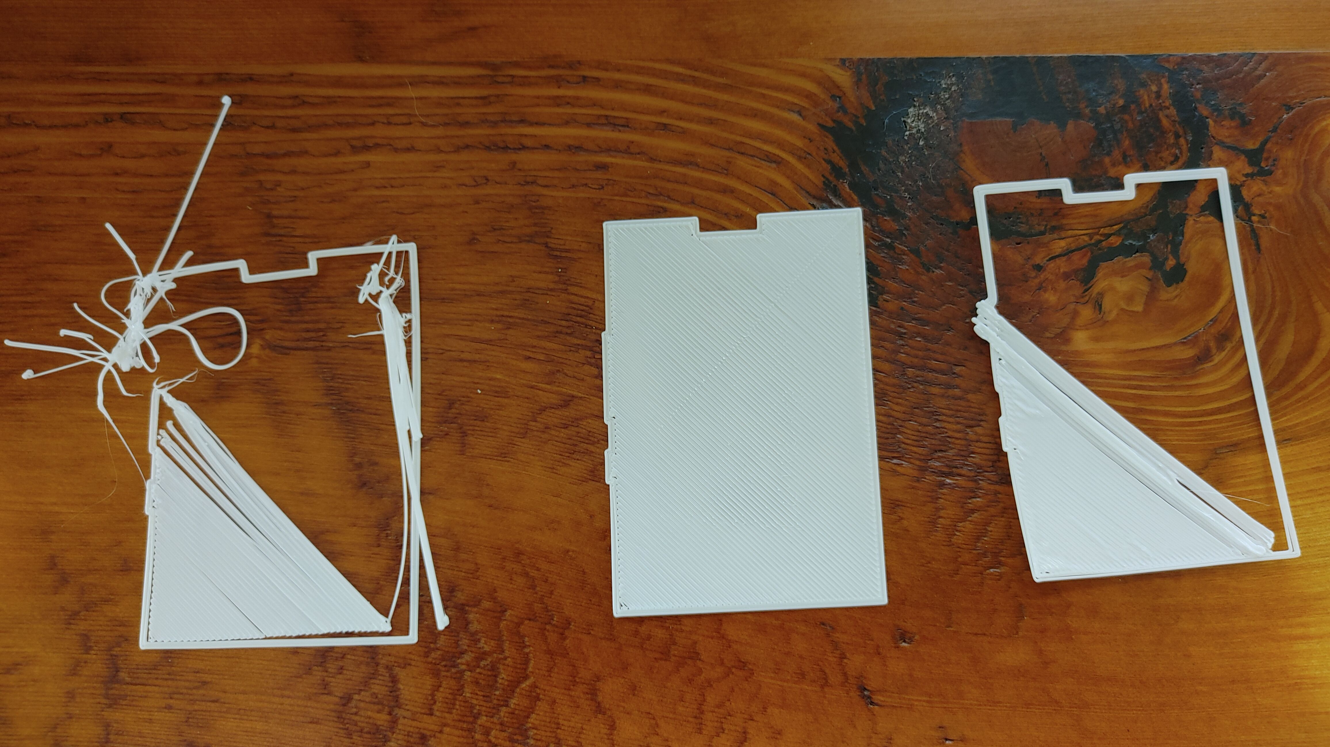

I received my new Mini 2 about a week ago. Out of the box the rocktopus printed perfectly. Using the same green filament, I then printed two small parts (the lid for a Raspberry Pi case, so about 4" x 2", and the faceplate for a Raspberry Pi camera, maybe 1" x 1"). These also came out perfectly, and that mostly used up the green filament.
Before I go on, I’ll explain that experience-wise, many years ago (10? more?) I had a little Cube3D but got tired of the vendor-lock-in filament. We upgraded to a factory-built printrBot that never really worked right so I sold it – probably 5 years ago. But I’m reasonably familiar with casual-hobbyist basics, although it has been awhile.
I switched to the included white sample filament, same make (Polymaker Polylite PLA). I extruded until it ran white and extrusion looked smooth so I tried to print. So far I haven’t had a single successful print. The first three tries, it didn’t stick to the bed at all and just made a tangled mess on the hot end. It wouldn’t even complete part of that outline it starts with (which I assume primes the extruder).
I cleaned up the bed really well (just a damp cloth, had no alcohol on hand at the time) and it seemed to work. I was trying to print the bottom part of that Raspberry Pi case, so most of the print was another flat 4" x 2" rectangle with some walls at the end. It laid out the perimeter ok and started the infill, and about a quarter of the way through it started pulling up the infill and was soon dragging the whole mess around the bed again.
More cleanup, and this time I used the glue stick. I know it isn’t supposed to be needed with PLA but I had no other ideas. The next try seemed to be going well. I got two completely filled layers down. I still have that piece, for just two layers it looks pretty good. But the third layer didn’t stick at all and soon I had another mess dragging around.
Cleanup again, this time with water for the glue, then alcohol pads. No glue this time. It laid down the perimeter fine, but the infill was looking sort of blobby and lumpy. About a third of the way through the first infill layer, the infilled corner started curling upwards, and the extruded plastic started partially tearing previous passes away, so I aborted it. Here are pictures of all three that made it to various stages.
 ![20200721_144013](https://us1.discourse-cdn.com/flex020/uploads/lulzbot/original/2X/e/e5f56e88058f064d455a13c5df6013e0589d71ac.jpeg)
Since it’s new, Support suggested I check belt tension, screws, etc. so I’ll be fiddling with that this afternoon. Also some settings changes they offered because the wipe process isn’t aligned correctly with the pad.
For the adhesion problems they suggested I adjust my z offset down a little bit. I’m not sure what constitutes “a little bit” and I’d like some advice on that. I still need to dig around in Cura and figure out exactly how to do that, too.
Initially they suggested maybe I needed to bump the heat up, although I didn’t get answers to a follow-up question for clarification. The Cura presets for this material show a hot end temp of 205 but I’ve noticed when printing Cura always sets the temp to 210. The quick start guide says PLA shouldn’t exceed 220 so I’m not sure about that suggestion – or why Cura doesn’t use the preset. I’m also not sure if Support perhaps meant I should increase the bed temp. Cura sets that to 60 which I think matches the preset.
Very frustrating to have three picture-perfect prints in a row, then nothing but trouble. That old Cube3D was small, slow, and expensive to operate, but that little bugger just ran flawlessly year after year. I kind of miss it.
Suggestions and advice are greatly appreciated. I have 14 Raspberry Pi camera setups that need a home!

So I’ve got my wiping process sorted – center of the pad is Y182 whereas the off-the-shelf start code is 176-178 – kind of wondering if that variance is normal. My pad was also sticking way up out of the bracket thing. Had to actually remove it and trim the end to get it to sit flush. Seems sloppy to ship it that way.
Found the Z-offset commands (M501 / M851 / M500) and I know that’s in mm … setting was -0.98 but I have no clue what a normal “tweak range” might be. I played it safe and tried -0.99 with no luck. A fresh wipe-down with isopropyl and the material just skated off the plate without sticking at all.
**Post date:** [July 22, 2020, 6:48am UTC](https://forum.lulzbot.com/t/new-mini-2-various-adhesion-problems-pla/22042/3 "2020-07-22T06:48:40Z")
It really seems like the problem is with your Z-offset. If it is in fact -.99 that is too far away from the bed. The closer you are to 0 the further you are from the bed. 0 is the top of the washer on the 4 corners of the bed. The lowest you can go is to the bed itself, which of course is too low. The point is your range is the thickness of the washers. The washers are 1.5 to 1.6mm thick. Mine measures to be approx. 1.6mm and I use a Z-offset of 1.45 to 1.35. I suggest you set your z-offset to a value around those and fine tune from there.
60C bed temp is normal for PLA. 60C seems to stick too well for me, I print PLA at 55C on my bed. I prefer printing my filament at a hotter temperature than a cooler one. If your filament can handle it crank it up! I print PLA at 230C.
Once you work out the nuances you’ll see it’s a good reliable machine!

Thanks. So you’re using a positive Z-offset? It makes sense that is added to Z 0, now that you say it. Default print height is 0.2mm, I think, correct?
Is it normal for Cura to print at a different temperature than the filament profile specifies? (210 vs 205, in my case.)
I anticipate printing with ABS due to UV resistance (surveillance camera cases), so I figured on some fine tuning, I was just surprised to have so much trouble out-of-the-box.
**Post date:** [July 22, 2020, 1:59pm UTC](https://forum.lulzbot.com/t/new-mini-2-various-adhesion-problems-pla/22042/5 "2020-07-22T13:59:37Z")
No, those numbers should’ve been negative, sorry. I think the default height goes to -1.2mm.
The values in Cura are values they found to work good and is generally safe. PLA is very forgiving and will work for a wide range.

Thanks. I meant what is the default layer height, but I’ve found it in the custom print settings (0.25mm).
Looks like that 210 temp is the first-layer temp. I bumped that up to 220 and regular layer temp to 215, slowed printing to 50, and set the Z-offset to -1.40 and still no luck. I read somewhere that 70% alcohol isn’t great for cleaning so I have some 99% coming in a couple days and I’ll try again.
I feel like not much filament is coming out right at the start, like it takes longer to get started than it should, it moves maybe 10 mm along that priming perimeter line before anything flows, and the start of the flow looks thin at first. Once it gets going the flow looks normal. Maybe I should look into tuning the priming?

Is the filament curling up and sticking to your nozzle? That’s common and troublesome. Ensure your nozzle is clean. Don’t clean it with a wire brush with power on else you’ll blow a micro fuse that’s used in the auto-leveling tests.
**Post date:** [July 22, 2020, 7:31pm UTC](https://forum.lulzbot.com/t/new-mini-2-various-adhesion-problems-pla/22042/8 "2020-07-22T19:31:17Z")
On my TAZ 6, I use 70% alcohol and its fine. I (carefully) use Scotch Brite pads on a hot nozzle if the auto-leveling sequence has problems. I have a brass brush but I have insulated the thermistor and heater wires with hi-temp silicone to avoid blowing the fuse (or worse).
I use a skirt on most of my prints and I have increased the number of lines and the minimum length. It is not uncommon for the first line to be incomplete but if the last line isn’t perfect, then something isn’t right and I abort the print and adjust settings until it is. I also don’t run the part cooling fan on the first layer but it is usually going 100% by layer 3 for PLA. I also use maybe 5 degrees more nozzle temp on the first layer.
Careful examination of the lines in the skirt can tell you if the Z-offset is correct. You can find pictures and explanations on the internet that would be better than my attempt, so I’ll let you look that up.

Yes at the initial extrusion the filament is very thin and tends to curl and stick to the nozzle (often, not always).
I’ll do some searching for examples of how to examine the skirt lines relative to Z-offset. Although I haven’t gotten a good-enough print (without using glue) lately to even have anything to examine yet. Good to know about 70% alcohol though.

It sounds like you did not blow the fuse and the auto leveling is still working. In my experience the blown fuse knocked out the LCD display (TAZ 6), the mini 1 doesn’t have a display but you have a mini 2 so you do have a display. I don’t know what we’re to happen on the mini 2 if you were to blow the fuse. It’s just a hassle to do _and_ the mini fuses aren’t easy to come by at your local store. Cost of new fuses are approx $10 or so for 3. Search Amazon or e-bay. Seems everything on Lulzbot site is always out of stock.
Yes auto leveling is where it touches the washers, the electrical path continues up through the nozzle.
I don’t think the skirt would stack, instead I think it will lay down another perimeter line until it pushes out 250mm of filament.
Run tests manually. Move the nozzle up, heat up the filament, extrude it in the air. How’s the flow? Does it flow freely? Or does it seem like there’s a clog impeding the flow? Printing in the air it will probably curl up on the nozzle, pull it off, let the weight of the filament pull it down.
Where’d you get this filament? Is it quality? 2.85 mm width?
Did you print with a different filament with a higher melting temperature prior?
It may be worth trying to do a purge. Remove the PLA filament, heat up your extruder to 260c. Some filament may come out. Insert the PLA manually, push it down and push through the residual filament. Read up on doing a cold pull to clean your nozzle. Can even try cleaning filament as that has a large working range and is designed to clean your nozzle between filament types.

When I changed the filament I did extrude in the air, and it does curl and stick, but eventually flows freely. This is how I purged the old filament color after changing to another. All I’ve used are the sample filaments shipped with the printer (mentioned in OP), both are same brand/type/size, just different colors
Interesting, hadn’t heard of cleaning filament. I’d noticed the “cold pull” button in Cura and have been meaning to look it up.
**Post date:** [July 23, 2020, 9:29pm UTC](https://forum.lulzbot.com/t/new-mini-2-various-adhesion-problems-pla/22042/13 "2020-07-23T21:29:32Z")
@JoeBowler300 is correct, the skirt just keeps going around until 250mm is laid down. I use line count 3 and 500mm min length (probably don’t need to increase the min length).
I highly recommend the eSun cleaning filament. A cold pull (lowering the temperature below the melting point and then pulling the filament out) should give a nice imprint of the inside of the nozzle. On my TAZ 6 Single Extruder, I can shine a flashlight through the filament path when I’m done.
You can cold pull PLA at around 110C. The eSun cleaning filament down to about 90C. I can’t remember if I approached the best temperature from above or below. Too high and the filament stretches out and can break before pulling the inside of the nozzle. Too low and it just won’t pull.
With PLA the PEI sheet on the bed should work very well. I clean mine with 70% isopropyl alcohol regularly and hit it with a 3200 grit [Micro-Mesh](https://www.amazon.com/Sanding-Stopper-Polishing-Perfect-Materials/dp/B000H6EC4C) pad ([or 2 of each](https://www.amazon.com/Micro-Mesh-Assortment-Pack-18-Pieces/dp/B00HJC156U)) occasionally.
