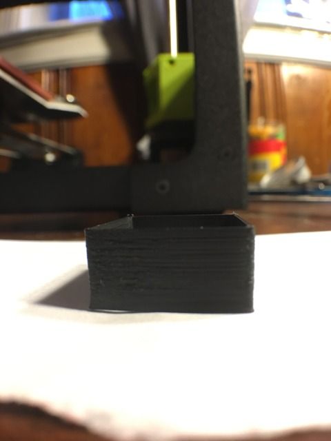

Hello all, recieved my Mini last week and i can say that ive been quite pleased and impressed with what ive been able to make thus far. so the last few nights ive been trying to get the extrusion calibrated as perfectly as i can before i get too ahead of myself and try and print things that end up not fitting together as they should.
for starters i did the esteps calibration for the extruder. got pretty darn close when measuring as i called for 100mm to extrude and i was getting just a bit over, 100.6 to be exact. settling in at E860 for the extruder steps measurement.
next up was the calibration cube. i am using simplify 3d, and in the posts ive read there seems to be a bit of an issue with the software if you try and extrude thin single wall prints such as this, but i got it figured out and off i went.
now heres my issue. first print, extrusion width set to .8mm, extrusion multiplier set to 1.00, i got a cube…with 4 different wall thicknesses.
.80/.86/.94/.94
[![](http://i39.photobucket.com/albums/e164/zerrb/E0A72F89-E123-4F56-9568-CC301B08C2D3_zpsrpwkz1yj.jpg)](http://s39.photobucket.com/user/zerrb/media/E0A72F89-E123-4F56-9568-CC301B08C2D3_zpsrpwkz1yj.jpg.html)
[![](http://i39.photobucket.com/albums/e164/zerrb/AA781289-ECE8-4370-AC39-43CFBE831871_zpsofoljbn0.jpg)](http://s39.photobucket.com/user/zerrb/media/AA781289-ECE8-4370-AC39-43CFBE831871_zpsofoljbn0.jpg.html)

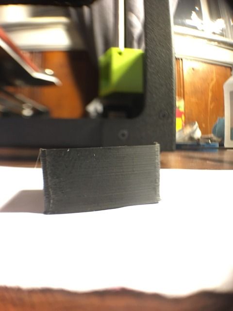

changed the extrusion ,multiplier down to .88 after doing some math and got this cube.
.80/.89/.84/.76
[![](http://i39.photobucket.com/albums/e164/zerrb/E57C9B13-254C-4DEA-8684-D5A49B681BC2_zpszxyseuer.jpg)](http://s39.photobucket.com/user/zerrb/media/E57C9B13-254C-4DEA-8684-D5A49B681BC2_zpszxyseuer.jpg.html)
[![](http://i39.photobucket.com/albums/e164/zerrb/5B4B609D-6DE1-4AED-814C-505B65C980EB_zpsksocfisu.jpg)](http://s39.photobucket.com/user/zerrb/media/5B4B609D-6DE1-4AED-814C-505B65C980EB_zpsksocfisu.jpg.html)
[![](http://i39.photobucket.com/albums/e164/zerrb/F58A3CCC-6C8F-46E1-93AC-CD4684498433_zpstlfdxxtf.jpg)](http://s39.photobucket.com/user/zerrb/media/F58A3CCC-6C8F-46E1-93AC-CD4684498433_zpstlfdxxtf.jpg.html)
shouldnt these walls all be even? is there some sort of other issue going on here that im missing? id like to get this extrusion stuff dialed in as best i can before i go and start to print things that are actually going to matter size was going together and fitting up properly. any help is greatly appreciated. thanks!

> [@zerb](#):
> now heres my issue. first print, **extrusion width set to .8mm** , extrusion multiplier set to 1.00, i got a cube…with 4 different wall thicknesses. …
This sort of jumped out at me.
First, I don’t use S3D – tried it and returned it so I’m not extensively familiar with it, but the setting I highlighted sounds somewhat like the “initial layer width” setting in Cura, but possibly for the whole object. I presume you have 0.5mm nozzle on your machine. In Cura, the initial layer default is 125% of the normal line width, and 0.5 mm \* 1.25 is a line 0.625 mm wide. You’re going for a 0.8mm line width with a 0.5 mm nozzle meaning that the printer has to pump a lot of plastic through the nozzle to create enough side-ooze to try to give your desired results. This might account for why some of the sides look like they are over-extruded. If you have replaced the 0.5mm nozzle with a smaller one, the effect will be even more pronounced.
I would suggest this:
1. Make or find a cube with wall thickness equal to your nozzle diameter.
2. Using Cura or Slic3r (my S3D prejudice is showing here), see how the piece prints.
Once it looks right:
3. See if S3D will also print it correctly. If not, and you are in the two week window of purchasing S3D, you can return it for a refund.
edit: looks over extruded: [Photo Storage](http://s39.photobucket.com/user/zerrb/media/5B4B609D-6DE1-4AED-814C-505B65C980EB_zpsksocfisu.jpg.html)

Thank you for your reply. And your highlighted text is correct. I noticed it as I was proof reading my post and re reading over a post on another forum about calibration cubes, etc.
I redid a print with the extrusion width set to .7 and it came out much smoother. I will do one more tomorrow closer to the nozzle diameter because I’m pretty sure that .7mm is still calling for it to be too big.

I tend to leave the extrusion width on “Auto”. But I do use the horizontal dimension adjustment setting to get accurate fitting parts.
**Post date:** [February 4, 2016, 5:38am UTC](https://forum.lulzbot.com/t/new-mini-owner-calibration/2892/5 "2016-02-04T05:38:36Z")
I’m using S3D with my Mini and it’s finally working well. I will say, there was a huge learning curve for me as I’m new to 3D printing and just started out in late December. I went back to Cura until I got that totally dialed in then went back to S3D, and with some help from the folks here, I was much better armed to get it dialed in as well.
Zerb, a couple of things jumped out at me about your situation. Both Cura and S3D set the Primary Layer Height to .20-.25 mm for medium print settings, so .8 mm sounds really large to me. It does look like over-extrusion but it may be due to the larger layer size that you’re using. Also, have you measured your filament diameter and entered that? Filament diameter and Primary Layer Height are critical to getting a good first layer to build on. Extrusion Multiplier is more of a fine tune adjustment. These are just some ideas from my limited knowledge, but it might help.

I think someone mentioned it earlier… but .8 for the extrusion width seems very off. It’s typically 120% of the nozzle diameter. So for a .5 nozzle it should be about .6
EDIT: Sorry, bad reading comprehension on my part. 🙂 I see that you’ve adjusted it down in your recent prints…

Extrusion width and the multiplier are not the same thing. S3D has both settings available.
You might want to adjust the width manually as well. If you have the stock 0.5mm nozzle, S3D in auto mode gives you 0.6mm width. If you have a part with a 1mm wall, that becomes problematic.
