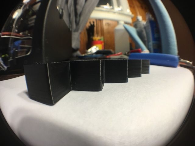

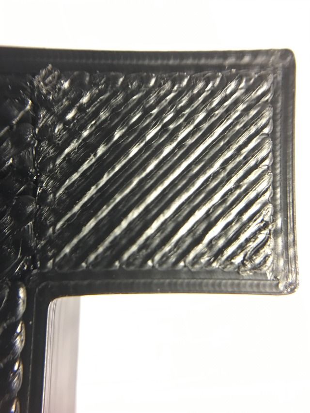

so after getting my esteps with the slower manual extrusion i printed out some more cubes.
.6mm manual extrusion width
.1 layer height
got the 4 walls of .63/.65/.65/.65
took those numbers, did the math and it came out to be .93 on the extrusion multiplier. so did 93% of current esteps (821) and got 763.5 printed another cube and it was all pretty much dead nuts .60 wall thickness.
then went on a printed another of of the 5mm calibration cubes at a 95 percent infill and .1 layer height and pics are below.
esteps @ 821
[![](https://us1.discourse-cdn.com/flex020/uploads/lulzbot/original/2X/c/cd61b44765df9eb8a4adb1bf9a870aedf25ae92d.jpeg)](http://s39.photobucket.com/user/zerrb/media/3D%20Printing/BD396A9A-10F2-4851-9196-B26D44B696FC_zpswjabqahd.jpg.html)
esteps @ 763.5
[![](https://us1.discourse-cdn.com/flex020/uploads/lulzbot/original/2X/a/a567e65341b7ef9dce104d114cbef6e2f64de8ee.jpeg)](http://s39.photobucket.com/user/zerrb/media/3D%20Printing/1BF40461-7177-481F-9154-4EAABDD097BA_zpspsizhgol.jpg.html)
im not exactly sure what to look for with this test to be honest other then according to the wiki there should be just the slightest of gaps between the lines with a 95 percent infill. i will say that the lower estep value seems to have much sharper corners.
these cube steps are nice to see since you print it at 250% size as per the wiki, but to do an entire steps print would be a few hours so tomorrow im going to do a few of the solid 20mm test cubes and see what that does since those wont take so long to do, and i want to be able to see how the top layers come out.
**Post date:** [February 7, 2016, 5:40pm UTC](https://forum.lulzbot.com/t/new-mini-owner-calibration/2892/26 "2016-02-07T17:40:38Z")
That is looking quite a bit crisper than your earlier photos. Looks like a bit of effort on this is really paying off for you.
**Post date:** [February 7, 2016, 5:58pm UTC](https://forum.lulzbot.com/t/new-mini-owner-calibration/2892/27 "2016-02-07T17:58:09Z")
What you’re looking for is for there to be a very small open space between the lines in the infill, and just enough extrusion to not have gaps for solid layers. For that 5mm step pyramid, the best place to watch is when the outside steps start getting their solid layers. You can see solid and infill at the same time. At 0.2mm, when scaled up, that’s about an hour of printing to get there. Using more solid top layers will help there. Maybe not scaling it up so much as well.
Remember to give it a layer or two for the change to take effect. Your pictures look like you’re going in the right direction. Maybe try some other small test prints to make sure everything else looks good.

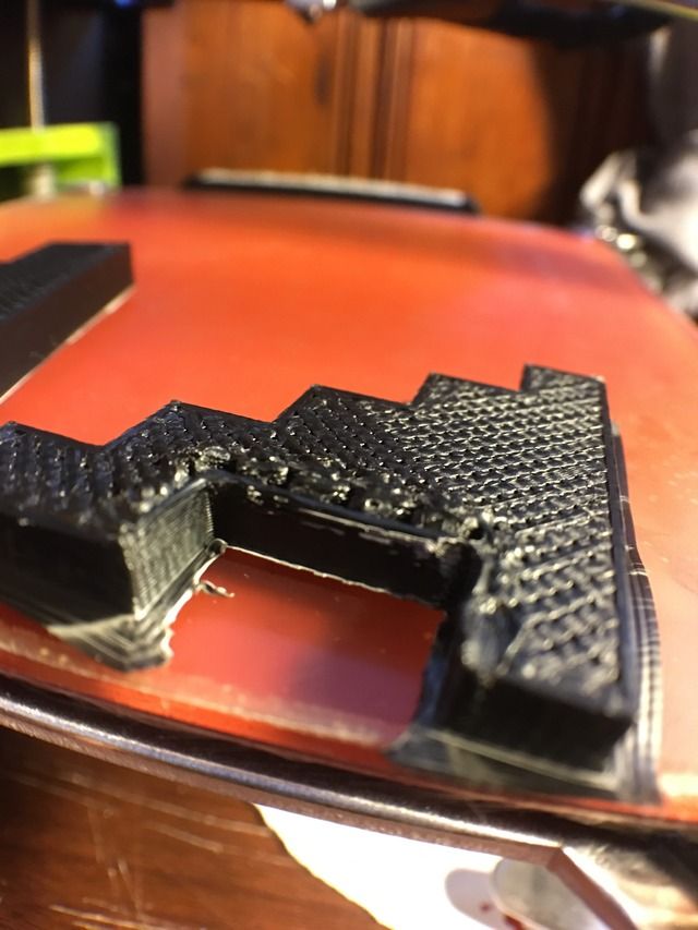

**Post date:** [February 7, 2016, 9:14pm UTC](https://forum.lulzbot.com/t/new-mini-owner-calibration/2892/29 "2016-02-07T21:14:53Z")

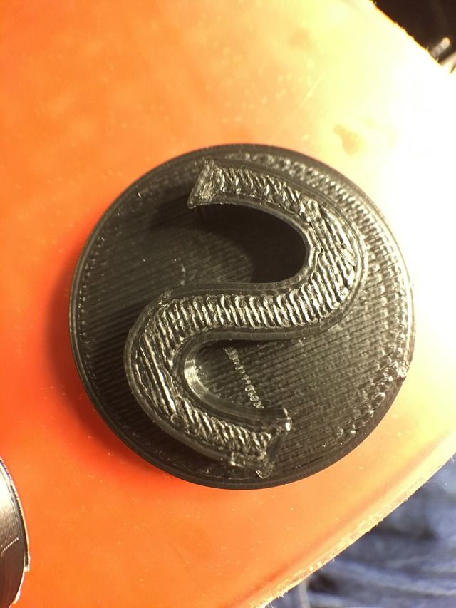

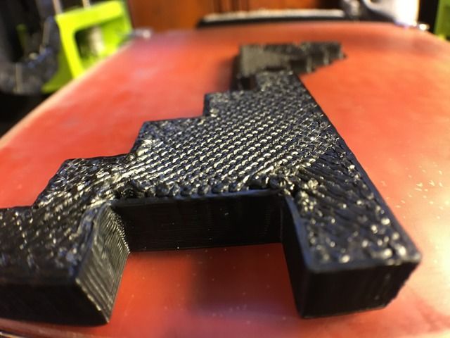

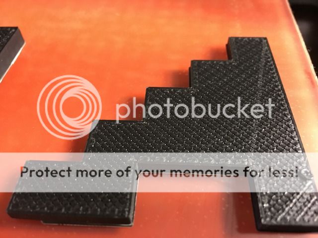

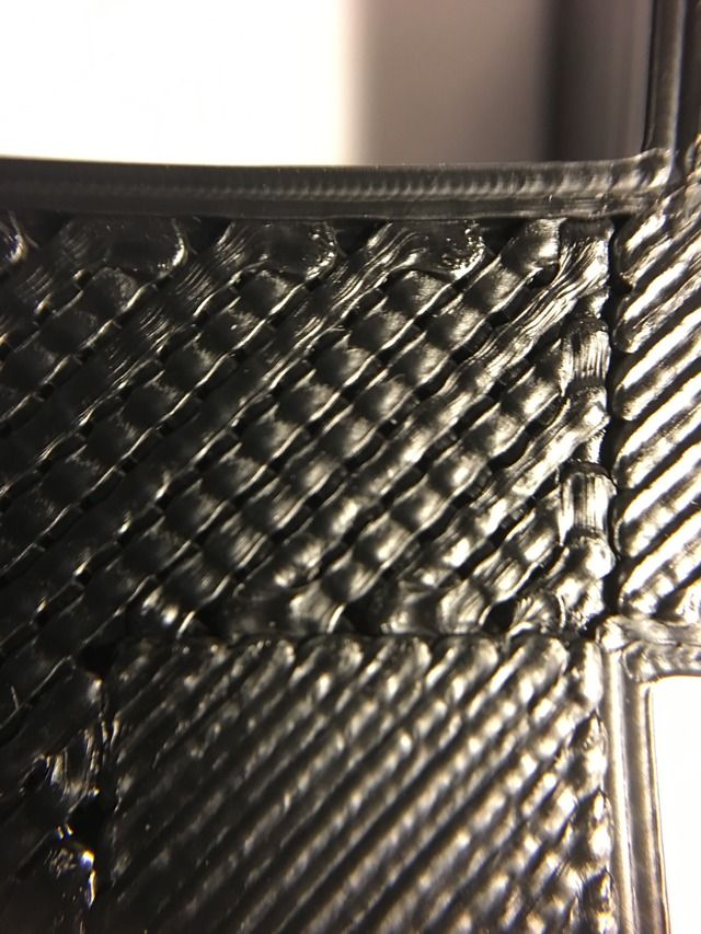

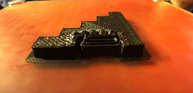

attempted to do the cube steps at just 150 percent scale and i ran into this issue. same thing happened when i tried it at 200 percent scale as well.
[![](http://i39.photobucket.com/albums/e164/zerrb/3D%20Printing/0AABE005-102D-4550-BE38-3076DF6DDD76_zpso92gisrf.jpg)](http://s39.photobucket.com/user/zerrb/media/3D%20Printing/0AABE005-102D-4550-BE38-3076DF6DDD76_zpso92gisrf.jpg.html)
[![](http://i39.photobucket.com/albums/e164/zerrb/3D%20Printing/89D02AC5-FBCB-4A61-842C-6D12FC66FDE1_zpsdwl3vq00.jpg)](http://s39.photobucket.com/user/zerrb/media/3D%20Printing/89D02AC5-FBCB-4A61-842C-6D12FC66FDE1_zpsdwl3vq00.jpg.html)
[![](http://i39.photobucket.com/albums/e164/zerrb/3D%20Printing/F275AB03-491A-4E4F-8A31-10BF72A170DF_zpswogn7apm.jpg)](http://s39.photobucket.com/user/zerrb/media/3D%20Printing/F275AB03-491A-4E4F-8A31-10BF72A170DF_zpswogn7apm.jpg.html)
same issue with 200 percent scaling
[![](http://i39.photobucket.com/albums/e164/zerrb/3D%20Printing/E35B7DBC-512F-4405-8DC1-932D251BFED9_zpst6yd4pbh.jpg)](http://s39.photobucket.com/user/zerrb/media/3D%20Printing/E35B7DBC-512F-4405-8DC1-932D251BFED9_zpst6yd4pbh.jpg.html)
rest of the print looks fine
[![](http://i39.photobucket.com/albums/e164/zerrb/3D%20Printing/A69BB1A3-01F8-452E-A4FC-EBC1D664F884_zps6fxwavgh.jpg)](http://s39.photobucket.com/user/zerrb/media/3D%20Printing/A69BB1A3-01F8-452E-A4FC-EBC1D664F884_zps6fxwavgh.jpg.html)
**Author:** ![zerb](https://avatars.discourse-cdn.com/v4/letter/z/53a042/32.png) [@zerb](https://forum.lulzbot.com/u/zerb)\

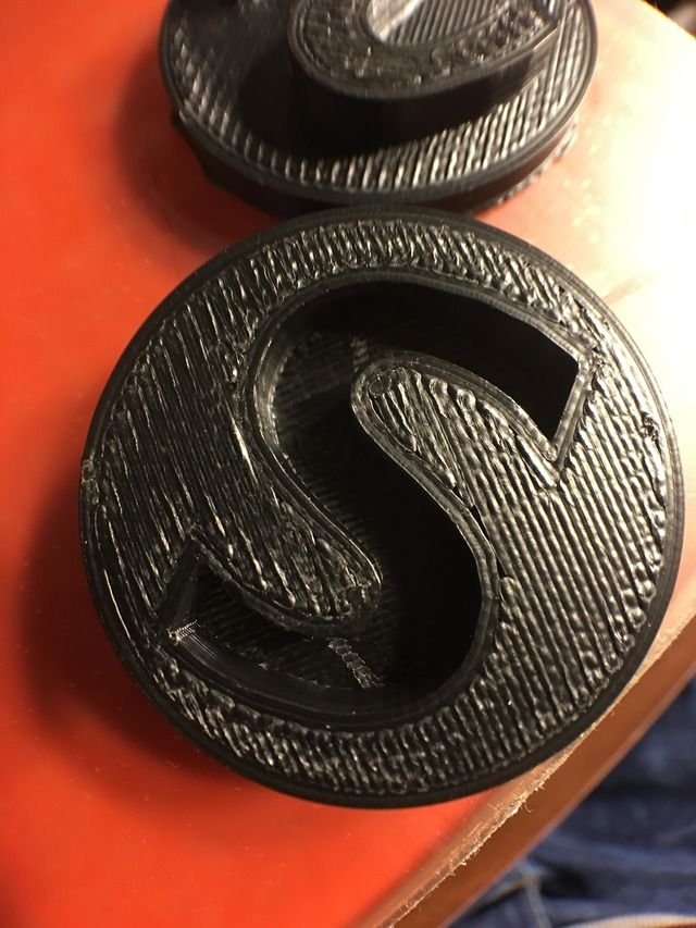

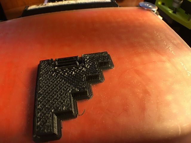

**Post date:** [February 7, 2016, 10:50pm UTC](https://forum.lulzbot.com/t/new-mini-owner-calibration/2892/30 "2016-02-07T22:50:42Z")

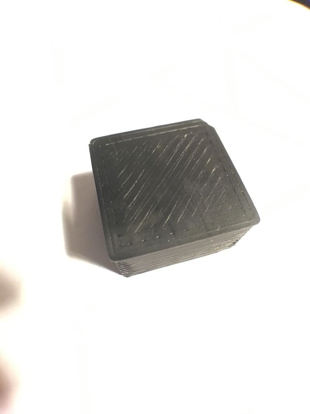

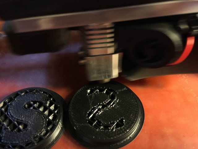

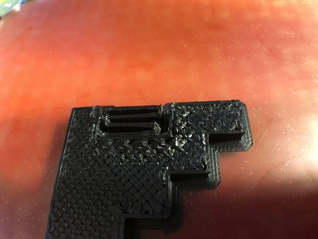

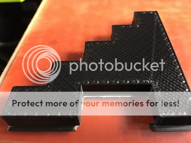

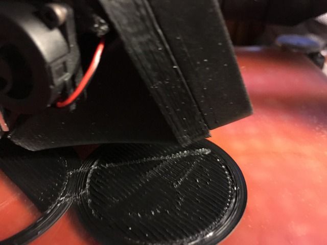

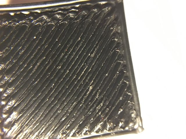

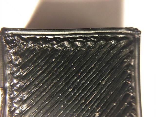

First question. on the infill layers it seems as if the nozzle is dragging on the last extruded layer, what could be the cause of that problem? overextrusion? retraction?
[![](http://i39.photobucket.com/albums/e164/zerrb/3D%20Printing/902D5A1E-03C5-4F0A-8D10-2CBBDB81D681_zpsq3938lgd.jpg)](http://s39.photobucket.com/user/zerrb/media/3D%20Printing/902D5A1E-03C5-4F0A-8D10-2CBBDB81D681_zpsq3938lgd.jpg.html)
[![](http://i39.photobucket.com/albums/e164/zerrb/3D%20Printing/D1065E72-FD42-4B85-9CC3-8D64417556F7_zpsnxnwkjyw.jpg)](http://s39.photobucket.com/user/zerrb/media/3D%20Printing/D1065E72-FD42-4B85-9CC3-8D64417556F7_zpsnxnwkjyw.jpg.html)

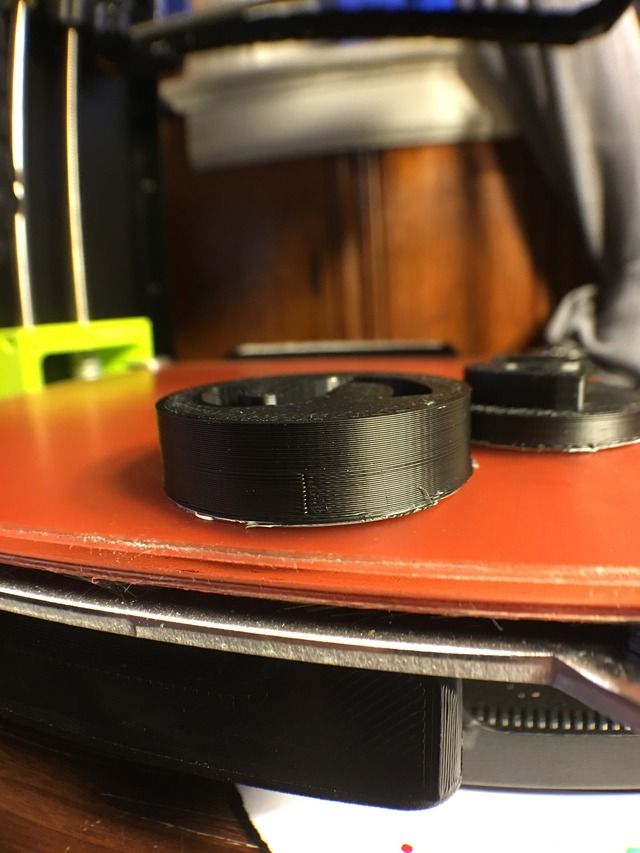

printed a test fit part and it doesnt fit, not even close actually. although i do think the top layer looks pretty good. at least much better then my top layers were when i started out this calibration process. measuring the center of that S the plug is 5.23mm and the piece it should pop into measures 5.03mm
extrusion width set on auto.
multiplier at 1
layer height at .2
shells at 2
[![](http://i39.photobucket.com/albums/e164/zerrb/3D%20Printing/76AD89F3-DB08-4305-BF50-B959C0A2A6E3_zps6ou8rd48.jpg)](http://s39.photobucket.com/user/zerrb/media/3D%20Printing/76AD89F3-DB08-4305-BF50-B959C0A2A6E3_zps6ou8rd48.jpg.html)
[![](http://i39.photobucket.com/albums/e164/zerrb/3D%20Printing/9F29D4C0-C0FD-464A-B286-AF567793D3AD_zpsx6qhf45f.jpg)](http://s39.photobucket.com/user/zerrb/media/3D%20Printing/9F29D4C0-C0FD-464A-B286-AF567793D3AD_zpsx6qhf45f.jpg.html)
[![](http://i39.photobucket.com/albums/e164/zerrb/3D%20Printing/A74689C4-F8FB-4AC6-BBBC-68CA7F88307B_zps5p5es6kv.jpg)](http://s39.photobucket.com/user/zerrb/media/3D%20Printing/A74689C4-F8FB-4AC6-BBBC-68CA7F88307B_zps5p5es6kv.jpg.html)
**Post date:** [February 8, 2016, 1:17am UTC](https://forum.lulzbot.com/t/new-mini-owner-calibration/2892/31 "2016-02-08T01:17:18Z")
The nozzle dragging across the top layer is usually over extrusion. That could also explain the parts not fitting together. Over extrusion makes holes smaller and outside dimensions larger. So that seems to make sense based on the pictures. On the step part, it seems pretty good overall. The issue you note around the cutout is new to me though.
What slicer are you using, and did you change any other settings? Perhaps we can narrow it down.

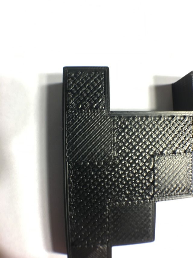

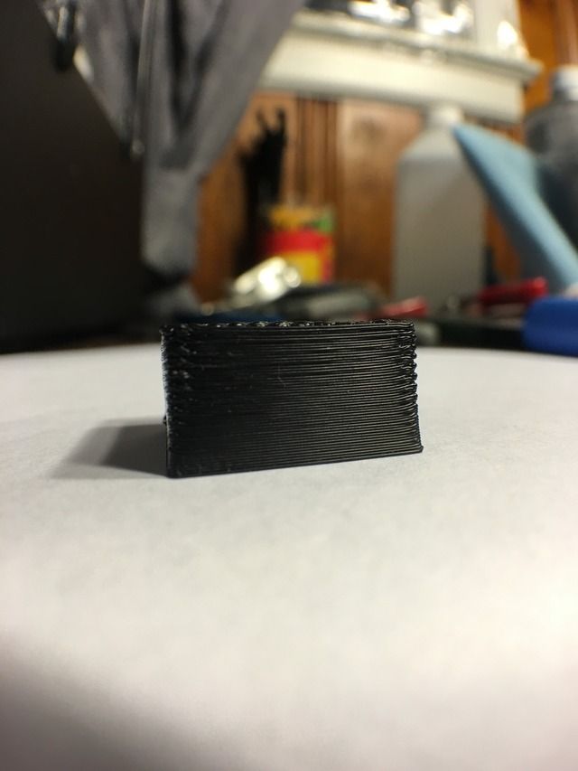

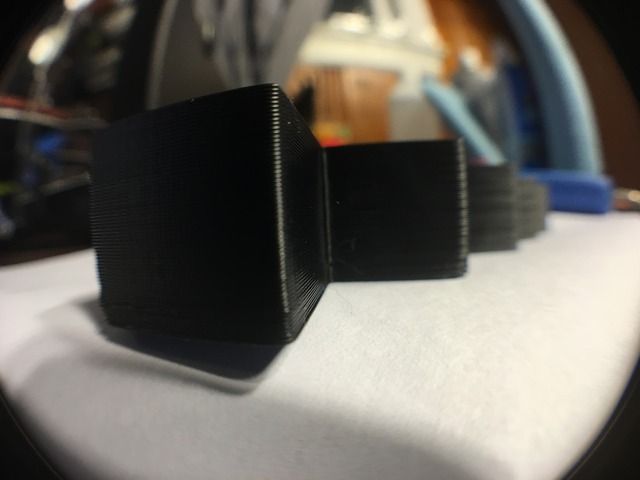

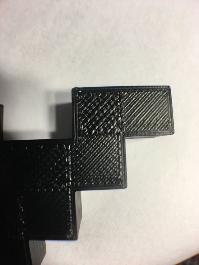

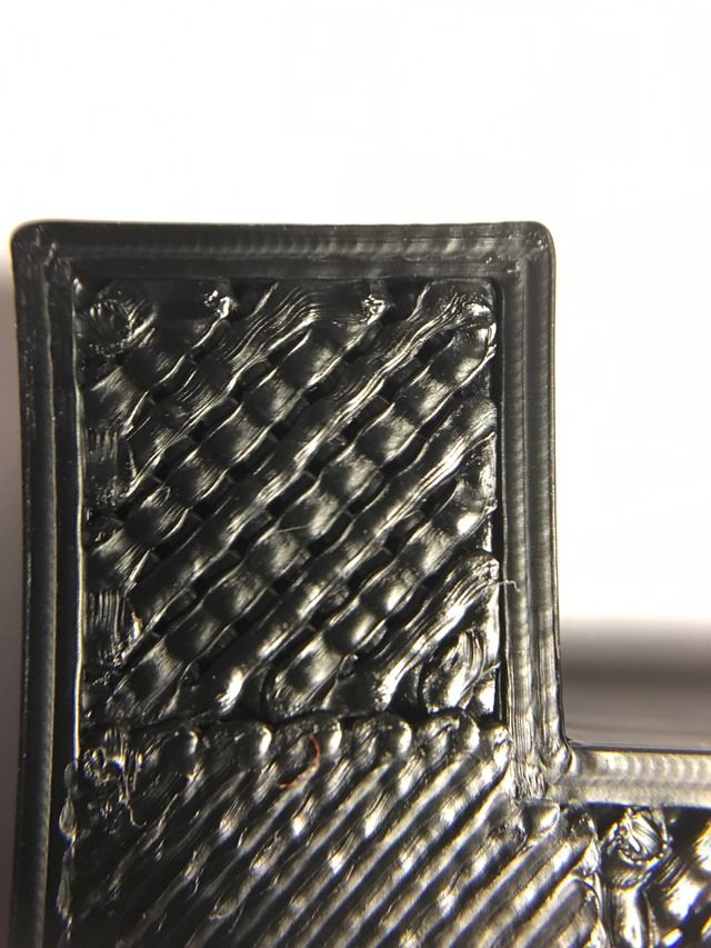

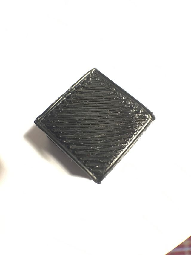

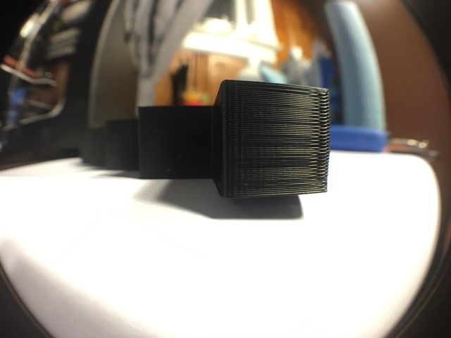

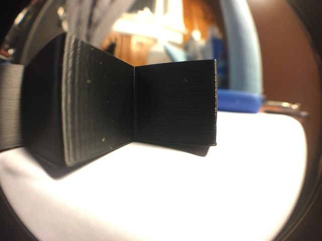

**Post date:** [February 17, 2016, 1:11am UTC](https://forum.lulzbot.com/t/new-mini-owner-calibration/2892/33 "2016-02-17T01:11:46Z")
so, i stumbled upon a PDF file on here that had a bunch of Simplify3d profiles to start off with on a Mini. i added in the values in that it had for ABS and i came out with these prints. needless to say, im quite happy, a few more tweaks (with the help of some pros on this board) and i think i will be right on the money!
only issue i see, using my olloclip macro, is
-the infill doesnt quite touch the outter shells
-the corners, some, look a little jagged, droopy
calibration cube, measured 19.99-20.02mm depending on where you measure it, so not bad there. height, which i think should be 10mm, ends up at 10.75mm, so im not sure what thats all about. (overextrusion?)

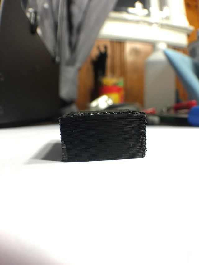

and heres the steps that ive been doing in the previous posts, cutting off right as they get to the first set of top layers
[![](http://i39.photobucket.com/albums/e164/zerrb/3D%20Printing/FBD25FAC-AE72-41B4-964F-A73F48798E9F_zps4jlbiied.jpg)](http://s39.photobucket.com/user/zerrb/media/3D%20Printing/FBD25FAC-AE72-41B4-964F-A73F48798E9F_zps4jlbiied.jpg.html)
[![](http://i39.photobucket.com/albums/e164/zerrb/3D%20Printing/5CFE078A-7FA6-486F-A370-94C3526ED828_zps5m0lopuc.jpg)](http://s39.photobucket.com/user/zerrb/media/3D%20Printing/5CFE078A-7FA6-486F-A370-94C3526ED828_zps5m0lopuc.jpg.html)
[![](http://i39.photobucket.com/albums/e164/zerrb/3D%20Printing/FC8EC87E-B072-4580-AD32-354074BE88C3_zps7s62fsni.jpg)](http://s39.photobucket.com/user/zerrb/media/3D%20Printing/FC8EC87E-B072-4580-AD32-354074BE88C3_zps7s62fsni.jpg.html)
[![](http://i39.photobucket.com/albums/e164/zerrb/3D%20Printing/5708E299-63AD-4849-BC81-3B7F419EE431_zpsqgbxpaaw.jpg)](http://s39.photobucket.com/user/zerrb/media/3D%20Printing/5708E299-63AD-4849-BC81-3B7F419EE431_zpsqgbxpaaw.jpg.html)
[![](http://i39.photobucket.com/albums/e164/zerrb/3D%20Printing/2221ED6D-BDF6-48F4-BA22-063B7BB6A9D7_zpsd5fosacy.jpg)](http://s39.photobucket.com/user/zerrb/media/3D%20Printing/2221ED6D-BDF6-48F4-BA22-063B7BB6A9D7_zpsd5fosacy.jpg.html)
[![](http://i39.photobucket.com/albums/e164/zerrb/3D%20Printing/F7053BA5-499F-4833-887D-80E67CAEE58D_zps2t9x6itz.jpg)](http://s39.photobucket.com/user/zerrb/media/3D%20Printing/F7053BA5-499F-4833-887D-80E67CAEE58D_zps2t9x6itz.jpg.html)
[![](http://i39.photobucket.com/albums/e164/zerrb/3D%20Printing/853CDF0E-0664-4A9B-8198-BC967F2380B6_zpsjytnujmq.jpg)](http://s39.photobucket.com/user/zerrb/media/3D%20Printing/853CDF0E-0664-4A9B-8198-BC967F2380B6_zpsjytnujmq.jpg.html)
[![](http://i39.photobucket.com/albums/e164/zerrb/3D%20Printing/DA4E832A-B703-494C-97D4-C4AE8F7BBD00_zpsj2sxamsc.jpg)](http://s39.photobucket.com/user/zerrb/media/3D%20Printing/DA4E832A-B703-494C-97D4-C4AE8F7BBD00_zpsj2sxamsc.jpg.html)
[![](http://i39.photobucket.com/albums/e164/zerrb/3D%20Printing/2F10A567-E47F-4EED-9AE8-5851998CA287_zpsnty9rzer.jpg)](http://s39.photobucket.com/user/zerrb/media/3D%20Printing/2F10A567-E47F-4EED-9AE8-5851998CA287_zpsnty9rzer.jpg.html)

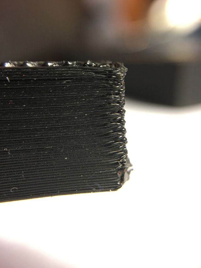

its odd some of the corners on the steps calibration look nice and sharp, others look droopy as you can see.
**Post date:** [February 17, 2016, 2:16am UTC](https://forum.lulzbot.com/t/new-mini-owner-calibration/2892/34 "2016-02-17T02:16:31Z")
It looks like you are getting a bit of lifting on some of the corners, I’d bump the bed temperature up a bit possibly. What layer height do you have set? the initial laer you want a 0.40ish layer, and then a 0.35mm layer for subsequent layers for starting, then adjust from there.
It looks to me like you are underextruding a bit, check the diameter of your filliament with calipers and adjust the value in Cura as needed to match. Also turn off the fan entirely for ABS if you have it on at all.

primary layer height is set at .20mm, first layer height is set to 150% of that (so .30)
the diameter of the filament i have checked, its set at 2.74 currently.
now, just out of curiosity here. it looks to me as if its underextruding as well, i assume that from the gaps im seeing between the outter shells and the infill. but other things ive printed, such as a male/female plug before, dont fit together easily (as id assume they would if i was underextruding)
fan is not on at all. bed temp as 100
**Author:** ![Rhoderman](https://avatars.discourse-cdn.com/v4/letter/r/3bc359/32.png) [@Rhoderman](https://forum.lulzbot.com/u/Rhoderman)\
**Post date:** [February 17, 2016, 5:01am UTC](https://forum.lulzbot.com/t/new-mini-owner-calibration/2892/36 "2016-02-17T05:01:23Z")
Have you tried slowing down your print speed by say 30%? Give it a shot, print a test piece.
That should reduce the overshoot loops at the corner. Once you get it perfect, then you can try for faster, although faster may never be better. You have to decide which is more appealing for the job…
It looks like you’re getting very close. What fill percent are you using in the last couple prints?

another question. when doing the estep calibration, telling the printer to extrude 100mm of filament and seeing just how much it does extrude, should the values be spot on each and every time? i feel like i have a good number for the esteps and then itll underextrude by a few MM, next pass its spot on, pass after that it may overextrude a few MM. is that normal?
**Post date:** [February 18, 2016, 3:06am UTC](https://forum.lulzbot.com/t/new-mini-owner-calibration/2892/38 "2016-02-18T03:06:15Z")
so after playing with the estep calibration again due to underextruding. i tuned it in and printed another cube. im assuming here, that this is overextruding, so i took a little video since im new at this and i just want to make sure for future reference. it seems as if the next layers are almost ‘pushing’ the layers below it around, thats why im assuming its overextruding here.
[https://www.youtube.com/watch?v=o-AuPruKTrM](https://www.youtube.com/watch?v=o-AuPruKTrM)
**Post date:** [February 18, 2016, 3:33am UTC](https://forum.lulzbot.com/t/new-mini-owner-calibration/2892/39 "2016-02-18T03:33:58Z")
Yeah, you are overextruding there.
**Post date:** [February 18, 2016, 4:15am UTC](https://forum.lulzbot.com/t/new-mini-owner-calibration/2892/40 "2016-02-18T04:15:01Z")
> [@piercet](#):
Cool. If I know what I’m looking at and what’s happening, I’ll be better suited to fix it whilst it’s happening next time.
