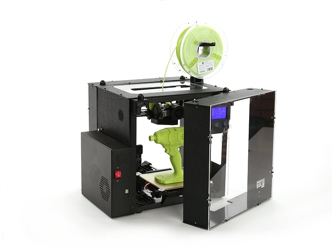

ABS is a more difficult filament because it warps. It’s not the printer… it’s the filament.
Warping happens because the filament contracts as it cools. The bed warmer allows the bottom to stay somewhat warm, but the upper layers will cool more. Since they cool more, they contract more than the bottom and that results in warping.
To print ABS, you need an enclosure around the printer to keep the build chamber warm. Here’s an example:
> **[LulzBot® Mini Compatible ABS+ Safety Enclosure by Printed Solid](https://www.printedsolid.com/collections/enclosures/products/safety-enclosure-lulzbot-mini-abs?variant=32412215214165)**
> A flat packed kit of acrylic panels and fasteners to assemble a safety enclosure for the Lulzbot Mini 3D Printer.
There may be other filaments you can use that have properties you need without the warping issues … but this really depends on what you are printing and how you plan to use it.
