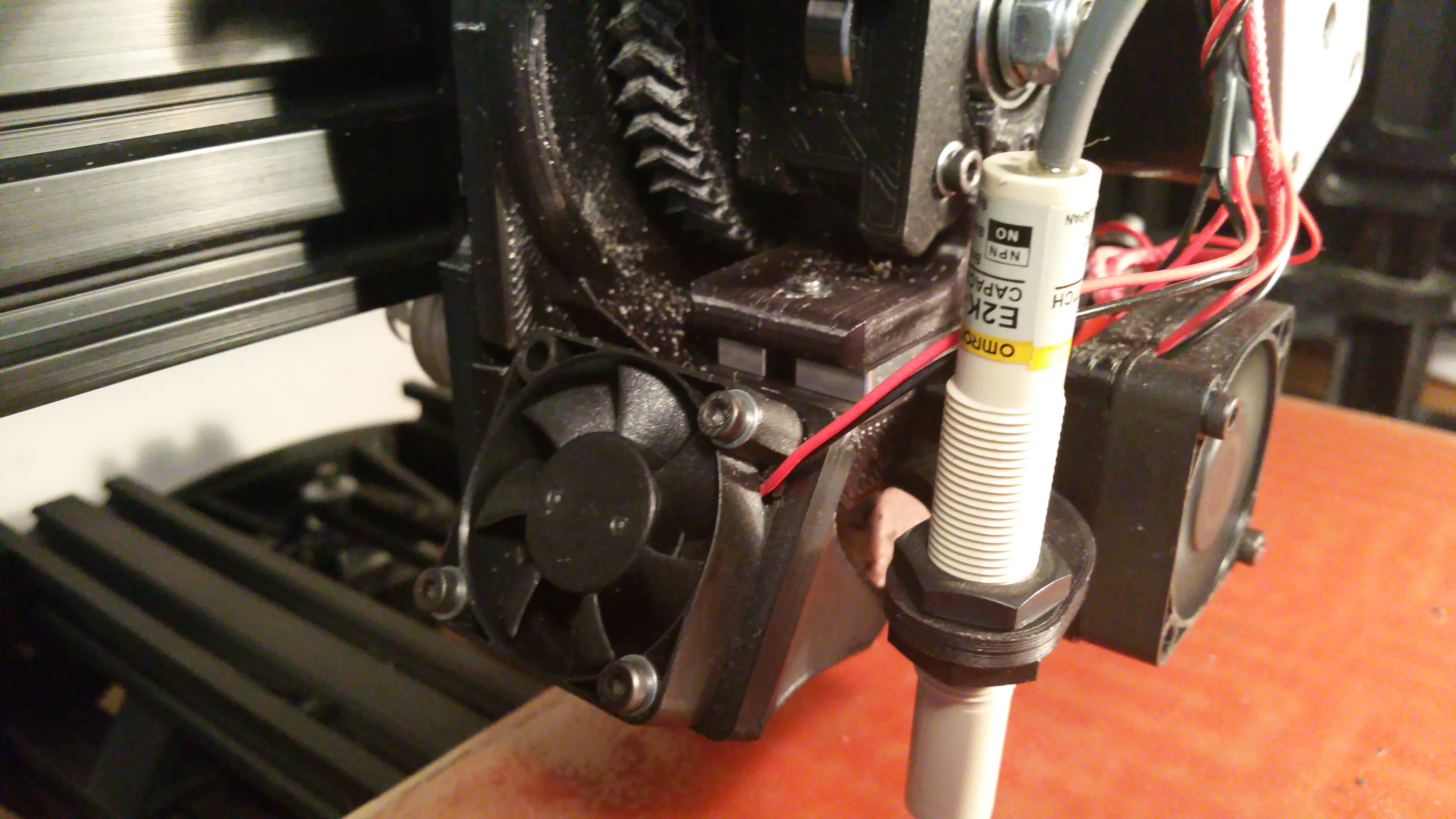

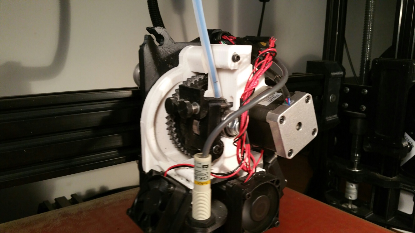

**Post date:** [March 6, 2016, 2:28pm UTC](https://forum.lulzbot.com/t/new-taz-5-modification-path/3071/7 "2016-03-06T14:28:49Z")
Here is the olive (Taz 6) extruder carriage and the reinforced mount modified to work with it. Dual 24v cooling fans in parallel, inductive auto leveling sensor, and 40mm cooling fan. I also have all three axes converted to open beams (piercets parts) and have made acrylic endplates to reinforce it all.

**Author:** ![jballard86](https://avatars.discourse-cdn.com/v4/letter/j/f19dbf/32.png) [@jballard86](https://forum.lulzbot.com/u/jballard86)\
**Post date:** [March 7, 2016, 3:37am UTC](https://forum.lulzbot.com/t/new-taz-5-modification-path/3071/8 "2016-03-07T03:37:43Z")
> [@discojon](#):
Nice! I foresee doing the extruder carriage and the taller extruder, along with the open beam axis.
Any idea if anyone has ever used dual 12v fans in series on the 24v line?
