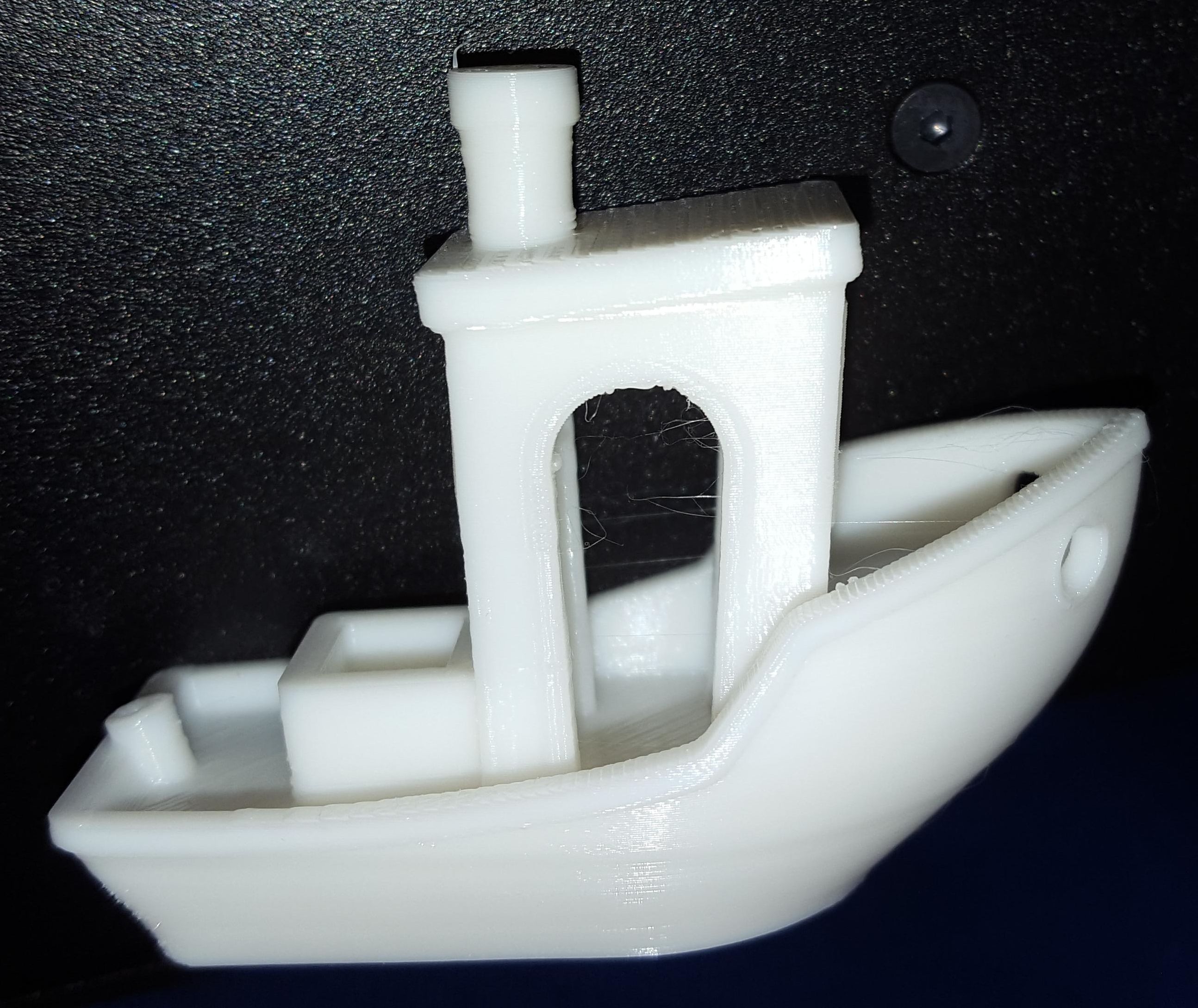

With the new settings, I printed 3DBenchy [http://www.thingiverse.com/thing:763622](http://www.thingiverse.com/thing:763622) next. It printed beautifully.
![](http://i.imgur.com/8Q2pyh2.jpg)
I know there are probably printers out there that are capable of printing in the high precision required for the first PLA model I printed, and I don’t expect that from the Mini. I’m just trying to figure out what I should expect from this printer.
So my question is this: Is there an established benchmark model, something that would be used for dialing in settings for new filaments and troubleshooting, that the Lulzbot Mini - as it is out of the box - should be able to print in any compatible filament type? Maybe even something specifically tailored to the Mini’s capabilities?

As for standard models I think most people pick something they like or reflects the type of stuff they normally print.
Cropped and rotated Benchy. I really wish manufactures of cameras and computers would agree on how to define which way is up.
 ![8Q2pyh2-C&R.jpg](https://us1.discourse-cdn.com/flex020/uploads/lulzbot/original/2X/7/739b16e38ff33700f3663d38401bd8636da6bf41.jpeg)
**Post date:** [June 21, 2016, 3:15pm UTC](https://forum.lulzbot.com/t/newbie-quest-to-get-a-decent-print-from-a-brand-new-lulzbot-mini-using-inland-pla-filament/3628/3 "2016-06-21T15:15:02Z")
Your Benchy looks good. Every filament will have little tweaks you are going to want to do. Even some for each model. I have a couple simple, fast to print STLs I use for basic filament settings to make sure I get good layer adhesion, feed rates, etc… This is one of my favorites as it’s quick, even in 0.1mm layers, and tests a few different things. [http://www.thingiverse.com/thing:1023717](http://www.thingiverse.com/thing:1023717)
I find if I can print that with a new filament, I can print most models. A few things need to be changed depending on the model sometimes, but that gets me in the ballpark. Models with little islands or really small models need more cooling or other tricks like printing more than one at a time. Otherwise they can overheat and deform. The small bits on your Benchy look good, so I think you’re good there. Sometimes I change various settings based on what the preview looks like.
Note that thin walls are a big problem in most slicers. Slic3r seems to work the best for those. Simplify3D, which I like for many things, completely fails on those. Cura is hit and miss.
Frankly, Benchy is a pretty tough print. That you got good quality there, makes me think you’re doing pretty well.
If you browse the forum here, you will find lots of recommended settings for various filaments and for various slicers. Cura and Simplify3D seem to be the most common, but others are around. Just keep in mind that 3D printing and slicing is still a bit of an art, not a science. You will likely need to adjust settings for some models, particularly more detailed complex models. And some of the models out there have errors and aren’t actually printable. Sometimes the slicer can fix them, sometimes not.

Benchy is a good standard guide. Yours is pretty good. The stringing you are seeing between the columns indicates that your retraction setting is off. Other things to check are the writing on the stern and the writing on the bottom. If you can read both of those, you are pretty well dialed in. There is a bit of heat wobble on the thinner columns, the smoke stack, etc. That may be due to cooling. You may want to increase your fan a little bit, and potentially look at adding an opposite side fan.

Test 2 Settings (same as Test 1 with these changes):
Increased Print Temp to 180 C
Increased Flow to 70%
Results: Not much different from test 1
Test 3 Settings (same as Test 2 with this change):
Increased Flow to 80%
Results: Strength greatly increased - actually had to work at tearing it apart
Test 4 (same as Test 3 with this change):
Increased Flow to 85%
Results: Stringing is just visible, very strong, bed adhesion also much more noticeable, printed the spike test from earlier and it was the best yet - I could almost read the text on the bottom!
Encouraged, I printed the some assembly required tetrahedron:
![](http://i.imgur.com/ttyotCJ.jpg)
It went right together with no issues whatsoever!
![](http://i.imgur.com/klcg81u.jpg)
Further encouraged, I printed the partly assembled version:
![](http://i.imgur.com/5sehwzL.jpg)
It works!
![](http://i.imgur.com/BrWwZYR.jpg)
I’m currently attempting to print that adjustable wrench with the new extrusion and temperature settings… maybe this time the screw won’t fuse to the body. That awesome platform jack may actually be within reach!
