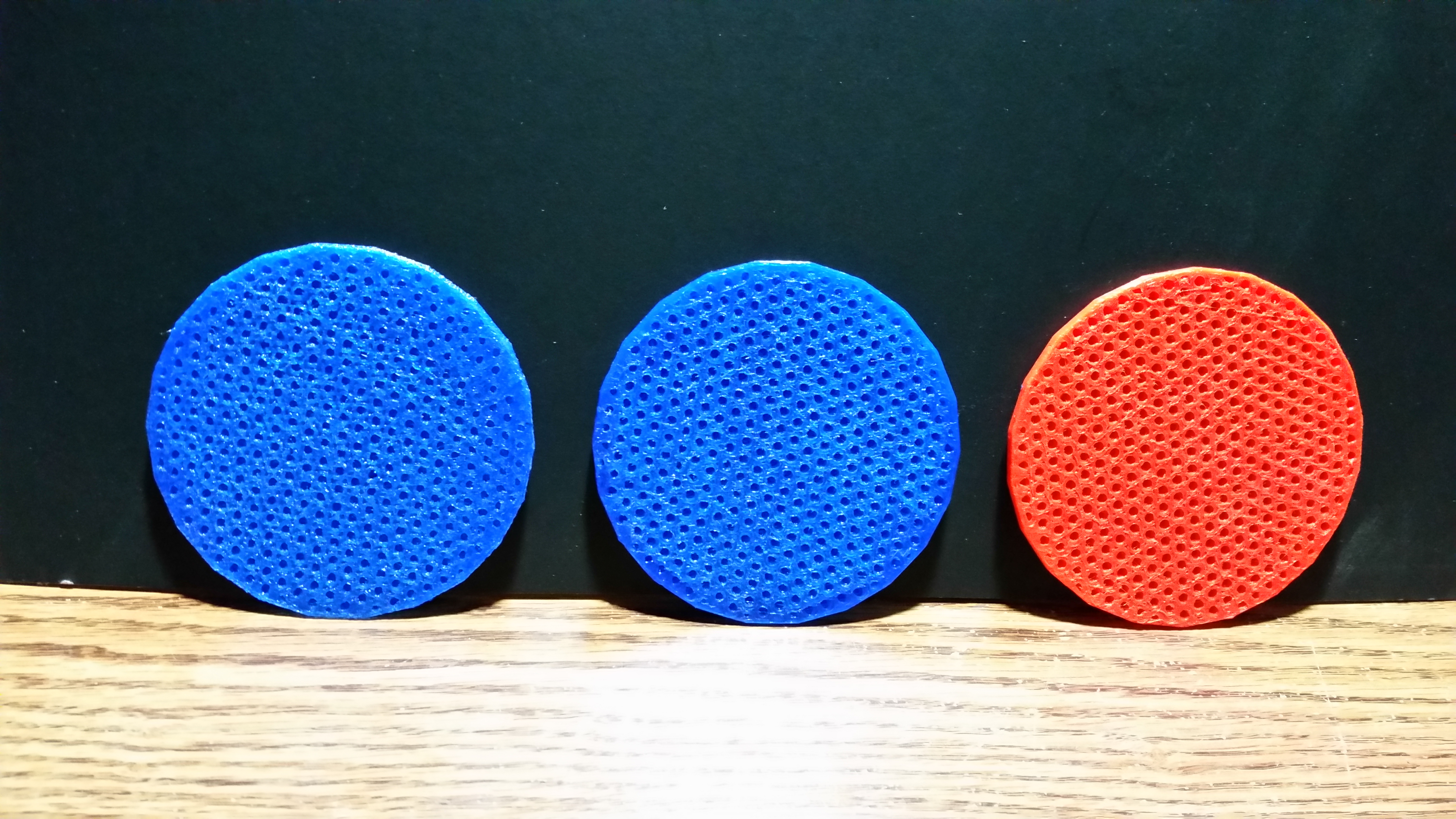

Left most was printed just 6 C higher but can see the difference. Right is SemiFlex, all with same speed and extrude/retract settings.
