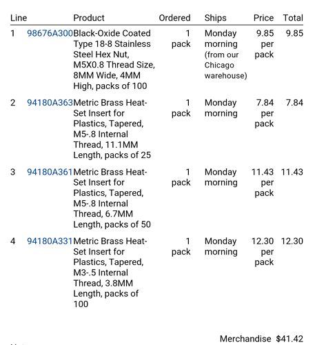

Can you post a screen of the Mcmaster Carr order as well? I was unsure of the size of the heat set insert for the Y-axis mod.

Her is what I ordered. Its a shame you have to order so many. I’d be willing to split up my order of inserts and sell what you would need to do the upgrades.
Thanks for posting the order. 🙂
No worries about splitting up the order. I think having a box of extra inserts will only inspire me to try to use them in some way. Thanks for the offer though!
