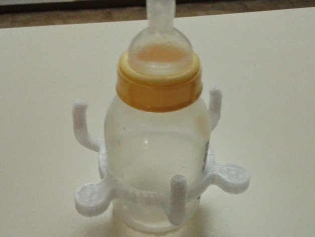

**Author:** ![DawgBone](https://avatars.discourse-cdn.com/v4/letter/d/f07891/32.png) [@DawgBone](https://forum.lulzbot.com/u/DawgBone)\
**Post date:** [April 7, 2015, 3:55am UTC](https://forum.lulzbot.com/t/petg-vs-abs-filament/1600/5 "2015-04-07T03:55:00Z")
Here’s a print I got from Thingverse… Thought it was a kewl print for our 6 month old… and has actually helped…
> **[Training Grips for Medela Baby Bottles by DrewTM](https://www.thingiverse.com/thing:569229)**
> These two little grip rings go on a 5oz Medela baby bottle, to help tiny hands learn to grasp and manipulate. One just wedges onto the bottle, the other gets locked on under the lid. The one that goes under the lid has little crush tabs on top to...
It’s hard to see the detail of the “neutral ABS”… I smashed my phone in my truck’s door, and it has a hard time focusing… but ABS kind of hides any ugliness… Whereas the PETG does not… You can probably see some of the “stringy” stuff I was talking about…
 ![4.jpg](https://us1.discourse-cdn.com/flex020/uploads/lulzbot/original/2X/0/0294e73dd8a31122f06c8997fc21ef4aa5108f11.jpeg)
 ![3.jpg](https://us1.discourse-cdn.com/flex020/uploads/lulzbot/original/2X/b/b8674488270f5c6ca6f481ae9e8bd138c1e04cc6.jpeg)
 ![2.jpg](https://us1.discourse-cdn.com/flex020/uploads/lulzbot/original/2X/9/97c5462bbffbff4ce6126581fcc739a4880d809f.jpeg)
 ![1.jpg](https://us1.discourse-cdn.com/flex020/uploads/lulzbot/original/2X/4/4f56338fde23f47de6fd41a2713ca040e9516406.jpeg)

Well for one the reason that the white abs hides the problem areas is nothing to do with it being abs, it’s because its white. White filament hides stiff the most where as black shows everything. 2 petg is cheaper than abs, and esun petg works very good and is much harder and flexible than abs. 3 if printed properly petg can look just as good if not better. It does have a wet look, but its a welcomed sacrifice for having a part that is 3 times stronger and does not delaminate. 4 abs delaminates easily, whereas petg seems to have 100% bonding where the end product is one solid piece, instead of the typical layers.

Personally I like ABS over PETG, but when the temperature is too low in my garage ABS fails about 100% of the time, whereas PETG looks and performs better the colder it is – seriously, it prints like a dream if the ambient temperature is in the mid to high 30s (F). This echoes the comment above about stringiness being less with the fan on.
With respect to ABS hiding artifacts of 3D printing, or even defects, I totally agree that it is true. While the example above also has the color issue, PETG is inherently shiny while ABS is matte or at most semi-matte – this means that even in a same color scenario, ABS is going to hide things more. It’s the age old preference between glossy and matte/semi-matte – monitor screens, photo prints, plastic parts. Some people like shiny, some don’t. I’m in the don’t camp so aesthetically speaking, ABS kills PETG IMHO.
