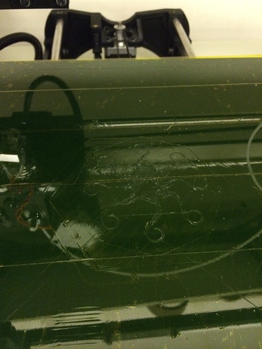

No I’m not using any solution. I even tried sticking the teflon tape but somehow the filament does not stick to the bed anymore. I tried adjusted the Z level at different levels (distance between the nozzle and the bed), it doesn’t work as well. Just to confirm, is it 0.1mm?
I hereby attached the image of the printing bed when the printer started printing during the first 2 levels. Do you advise that I get the acetone solution?

I don’t think the heat of the bed has anything to do with it (yet), as it doesn’t even look like anything is getting laid on the bed. Perhaps it is just hard to tell in the photo. It almost looks like it may be too low, and nothing is coming out. But I really can’t see to well in that photo, but it appears nearly nothing is extruded (?).

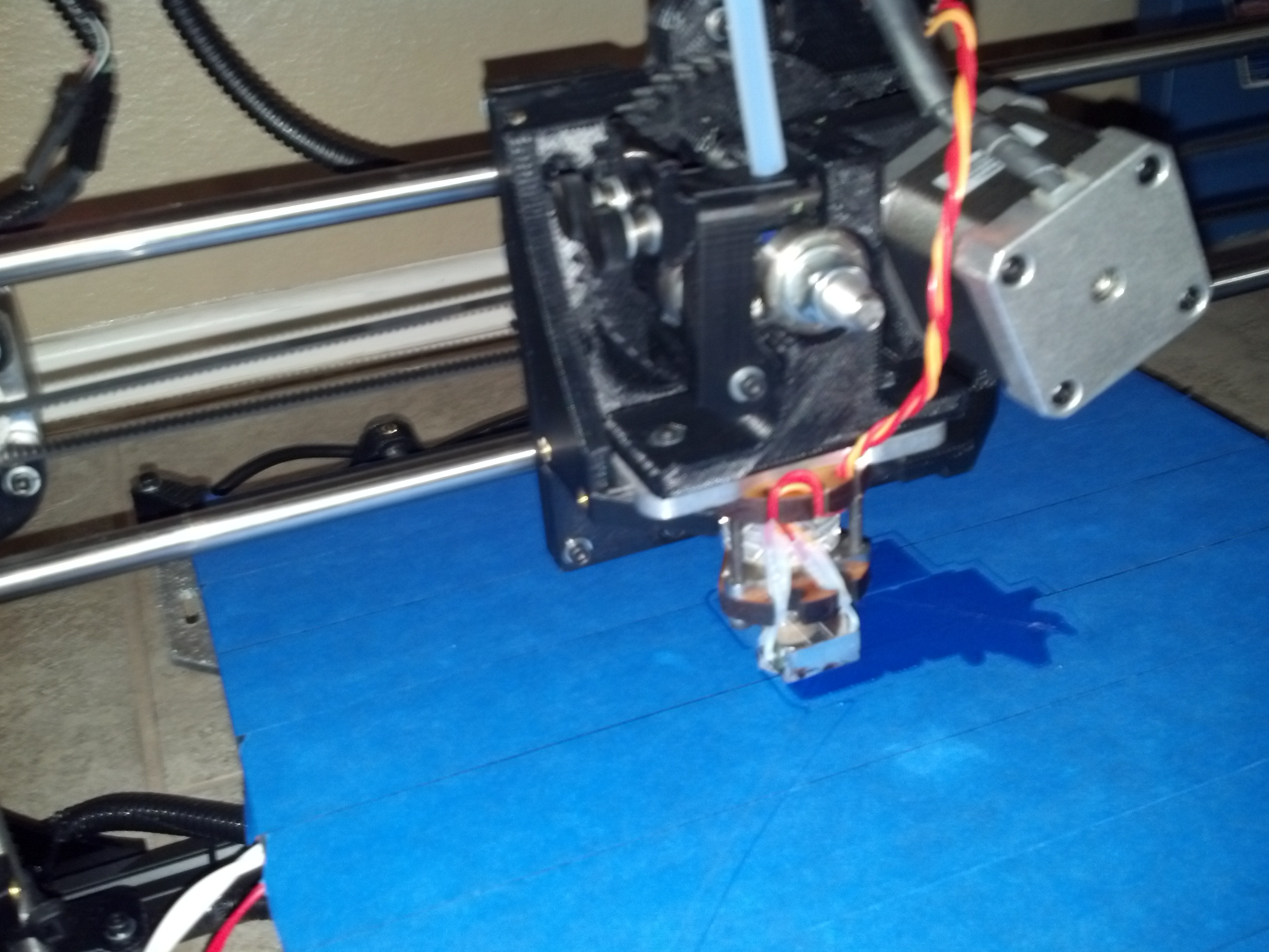

Hi, I had the same exact problem that you did and found your post while trying to find out how to fix this. I went from a badly clogged nozzle using HIPS filament to PLA. After clearing the clogged nozzle, I used the blue painters tape and got the extruder just as close to the print bed as you would with ABS. I also used CURA instead of prontrface and slic3r. I was able to print INSIDE the CURA program using ultimaker settings. It set the temperature at 220C (which I thought was way too high at first) and the bed at 50C (bed not sure if needed to be heated) but it worked this way. I’m able to print a fast print of a Grand Theft Auto5 sign. I know how frustrating this can be because it took me all afternoon to get some kind of result, so I hope this helps anyone else out there. Here are some pics in progress:

Thanks for the image, that helps. It looks like your first layer is too low. When printing with PLA, while it does like/help to be squished into the bed you should still be able to see the extrusion path, similar to the middle extrusion in this image: [http://download.lulzbot.com/TAZ/3.0/documentation/current/source/images-1600x1200/1st\_layer\_adhesion.jpg](http://download.lulzbot.com/TAZ/3.0/documentation/current/source/images-1600x1200/1st_layer_adhesion.jpg)
Try turning the Z axis endstop trigger adjustment screw clockwise one whole turn and see how that improves things.
