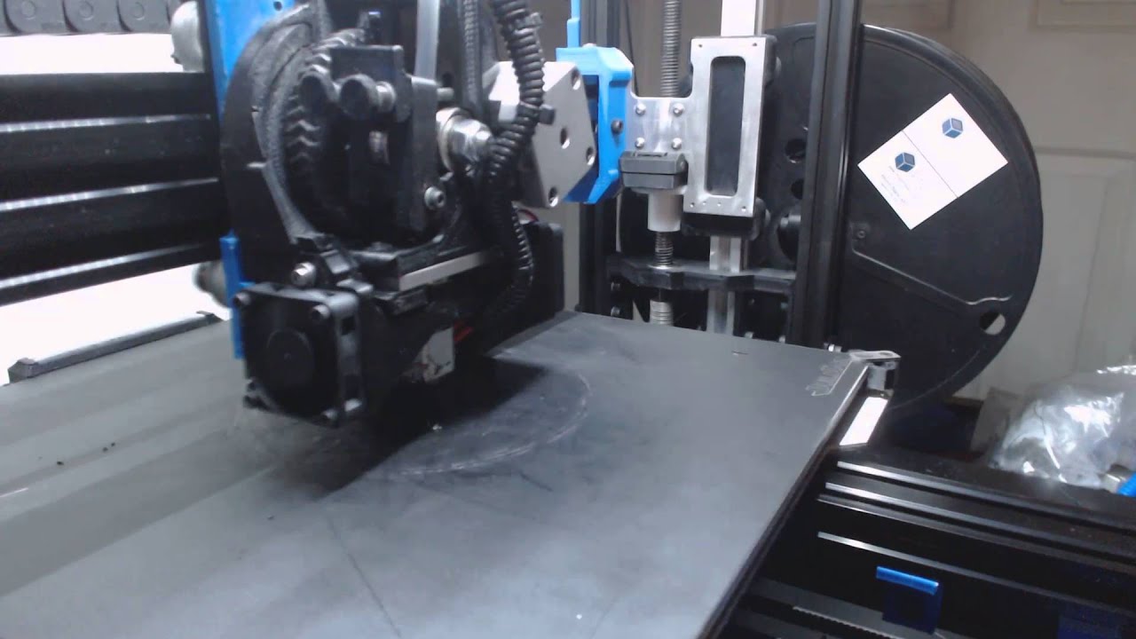

A modified Taz can print significantly faster than just about anything. Out of the box with stock units and a person that knows how to ensure good Bed Adhesion they both can print about the same speed. the Taz belt path may be able to go slightly faster, but the lower mass of the UM2+ head may allow it to travel faster.
Here are 2 overly long and quite boring videos of my modified Taz printing at maximum speed. The second one was the Ludacris speed attempt.
