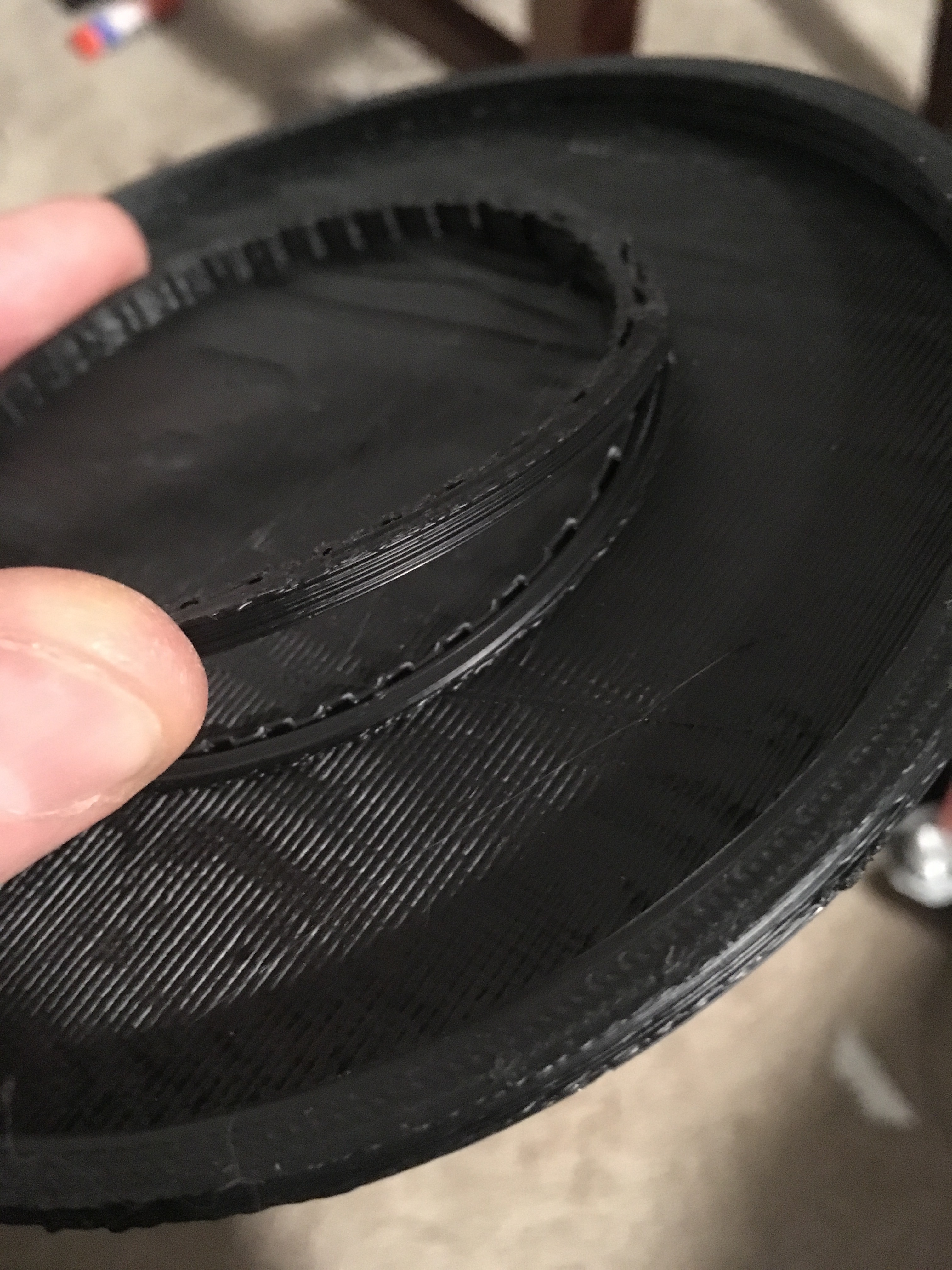

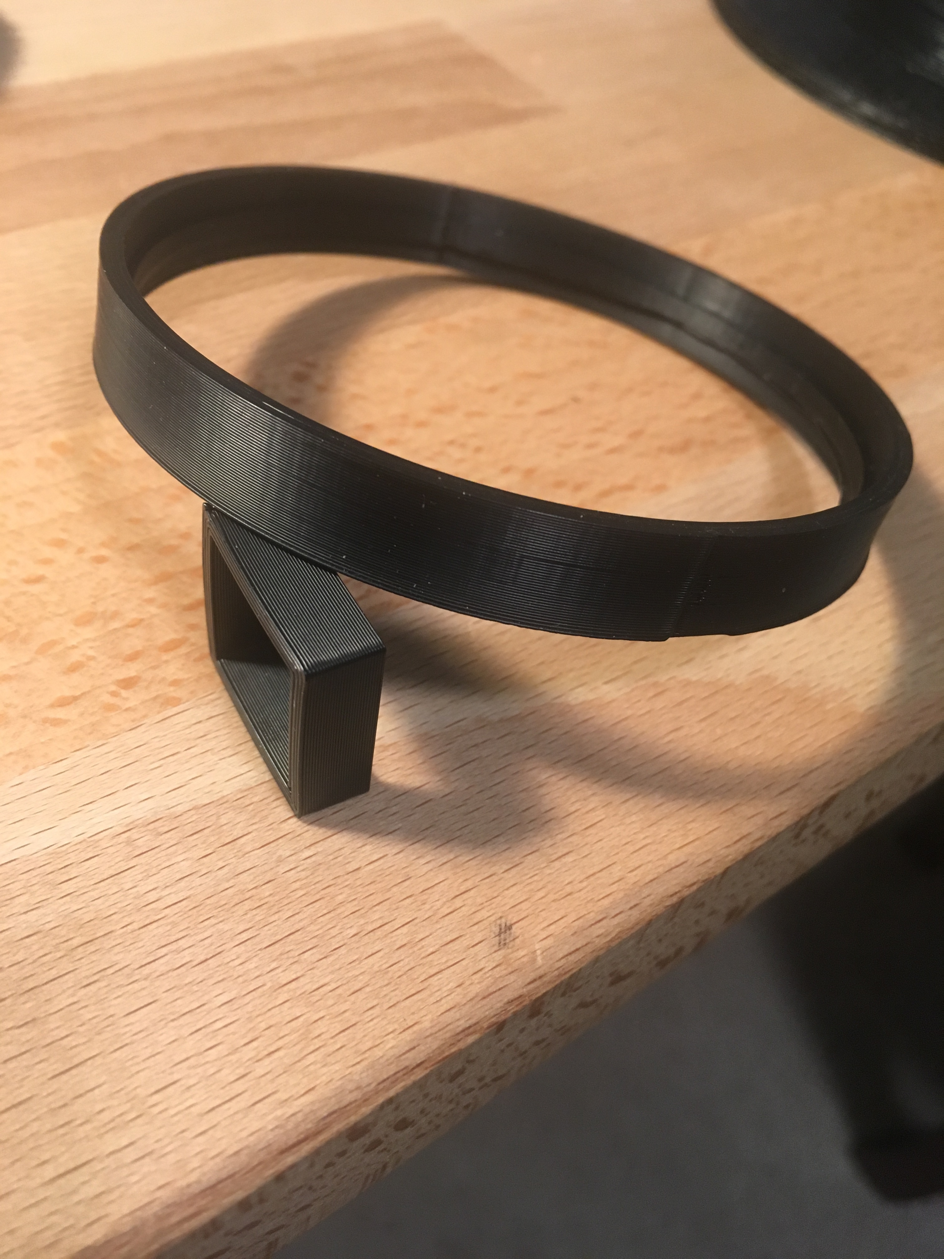

I feel like I didnt used to have this issue, but started to have this problem with the ABS print not always binding well layer to layer. This results in very week joints or even mid part breaks - two pics showing a recent print where one layer disconnects very easily from the next.
I am using I think the standard profile for my IC3D ABS but with support turned on.
I have a min with an aerostruder.
Im not sure if there is a way to capture the whole profile I can include it if there is , but it is the default with cura LE 3.2.32

adding the pics which were meant to be part of the initial post
 ![IMG_3156.JPG](https://us1.discourse-cdn.com/flex020/uploads/lulzbot/original/2X/7/7b8fccc38dd4b982108c507958140ebf51743ed6.jpeg)

**Post date:** [February 19, 2019, 3:57am UTC](https://forum.lulzbot.com/t/poor-binding-layer-to-layer-with-abs/6518/3 "2019-02-19T03:57:39Z")
second one
 ![IMG_3155.JPG](https://us1.discourse-cdn.com/flex020/uploads/lulzbot/original/2X/e/ecf43178f833e69019403fd7a6ab2cf8d3df80be.jpeg)

**Post date:** [February 21, 2019, 10:27pm UTC](https://forum.lulzbot.com/t/poor-binding-layer-to-layer-with-abs/6518/7 "2019-02-21T22:27:24Z")
It looks like its not extruding enough filament. It could be that the filament is bound or slipping in the extruder/mechanism.
Try these:
- make sure the filament spool is not binding
- spot check the filament for correct diameter - could cause binding in the extruder path
- clean the hobbed bolt/gear - not enough bite on the filament could cause slipping
- tighten the idler by a few turns -
- check for cracks on the extruder gears and tighten the grub screws… the small herringbone is usually the culprit.

> the print stopped mid way, but actually the printer apparently tried to do the whole thing,
This line, combined with your photo of it getting “bubbly” towards the top looks like a Z axis issue to my eyes. Essentially your Z axis is not moving up properly, causing extra extrusion which creates the bubbles. As it doesn’t start happening until higher up, there will be two things you want to check.
**1.)** Check that your electronics case fan is plugged in, clean, and running properly. If this has an issue it will cause your Z stepper driver to over heat, causing missed steps. (The Z axis driver shows signs first as it controls two motors.)
**2.)** Be sure that your X axis is leveled, if this is off kilter than it can cause binding. A good guide on it is here: [OHAI: Open Hardware Assembly Instructions](https://ohai.lulzbot.com/project/leveling-x-axis/maintenance-repairs/)

Brent - you are my hero of the weekend - I hadnt checked back on this thread for a while and was feeling really bummed that my printer was printing so poorly as I had really ramped up how many different projects I was trying to use it for. I tried what you said. The calibration was a tiny bit off I think, but the real key was the fan I think. I had had the cover off recently as I had an issue with the wires for the thermistor - and apparently I forgot to re-attach the fan. I ran my print which had failed multiple times with the fan running and the cover ajar and the print worked well again!
I will say that if those parts or that sensitive to temp we might want to improve airflow - there is a big bunch of wires over those drivers blocking the air from the fan, and also Im not really sure where the air is meant to be coming from to get pulled out by the fan (or the other way around) - but regardless - thank you very much for guessing right about my issue - huge help!
