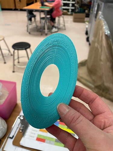

Print issue - Bad PLA?

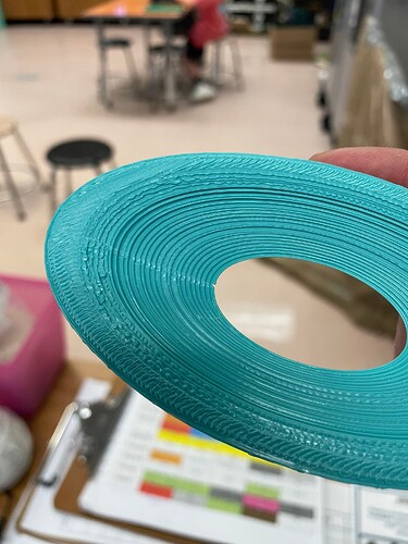

Is the problem here the filament? I had no problems with print quality with other material. Admittedly this PLA is old, had been in the back of my storage cabinet unwrapped for a while. Is this why its so jagged?
Looks severely overextruded, verify you’re not using a 1.75mm filament profile with 2.85mm filament.
If that’s only a single layer thick, it could also just be your Z offset is too low, so you’re overextruding in a different way, by not having enough space for the filament between the nozzle and bed.
