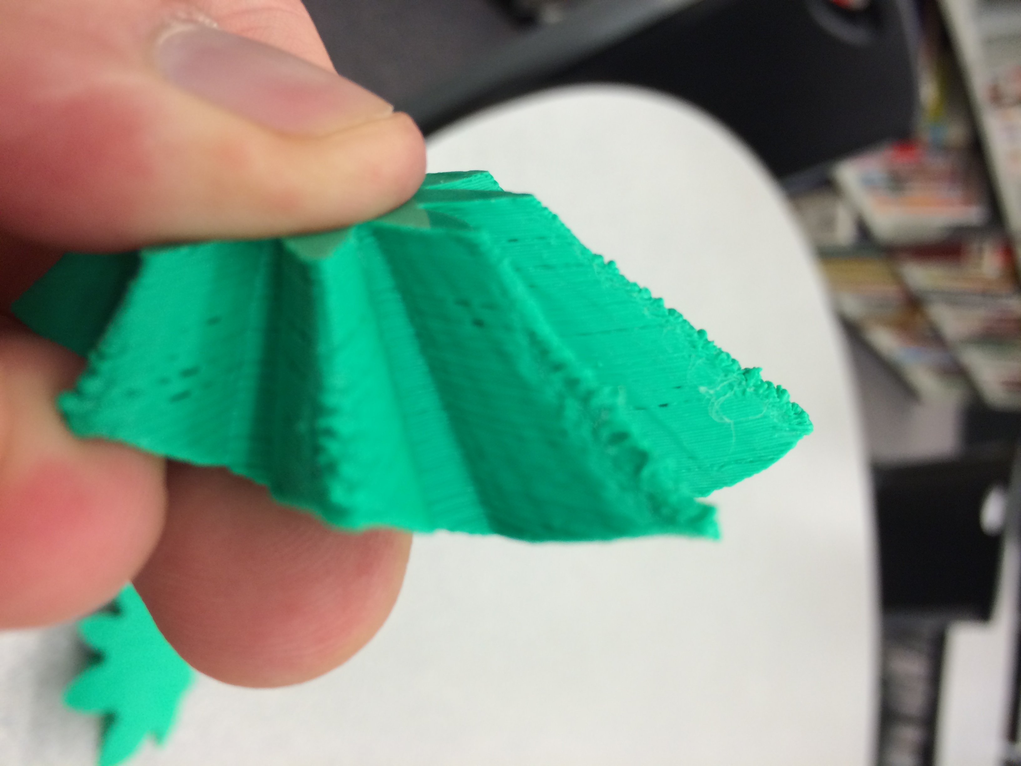

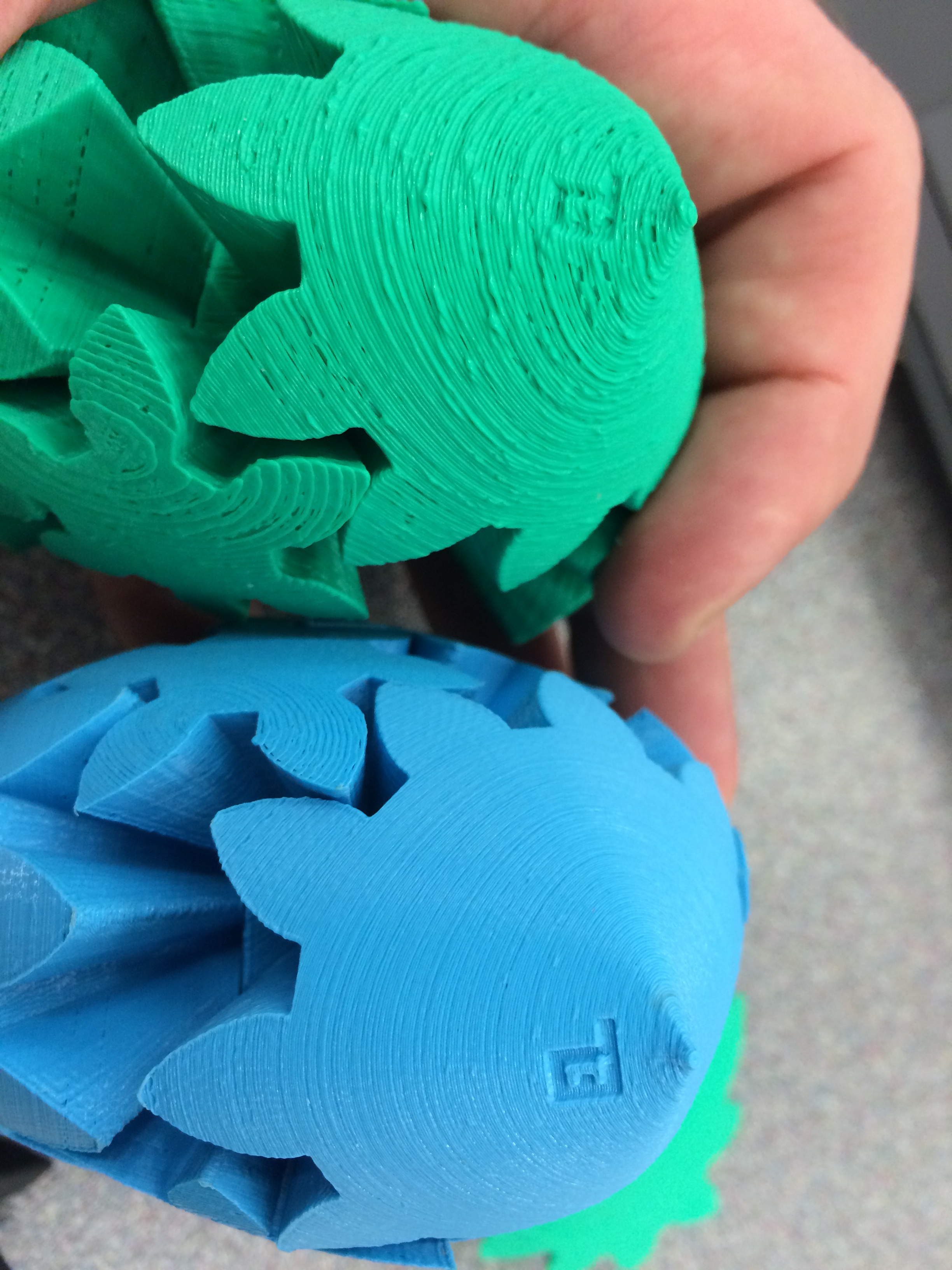

I’m having issues getting decent print resolution on a “heart gears” print. I also have an Ultimaker2 so I would like to post some comparison pictures and then discuss what I could be doing right/wrong with the TAZ4.
The following picture basically sums up the problem that I’m having.
 ![comparison.JPG](https://us1.discourse-cdn.com/flex020/uploads/lulzbot/original/2X/3/3de47bacc6ebd035ceb440079e4e1cb27c500090.jpeg)
The (green) print on the left was printed by my TAZ4 and the Print on the right was printed on the Ultimaker. Both were made in Cura 14.09, the TAZ print was made in the ‘lulzbot edition of Cura’. I used the “Medium PLA” Cura profile found on the lulzbot support site and for the Ultimaker I just selected the “medium quality, no support” function in quickprint.
For the filament, I used the recommended PLA settings (185/50).
Can anyone point me in the right direction as to why this is happening? I would really like to get smooth prints again from the TAZ4.
I have some other examples as well which I will post below this one (in the interest of size)

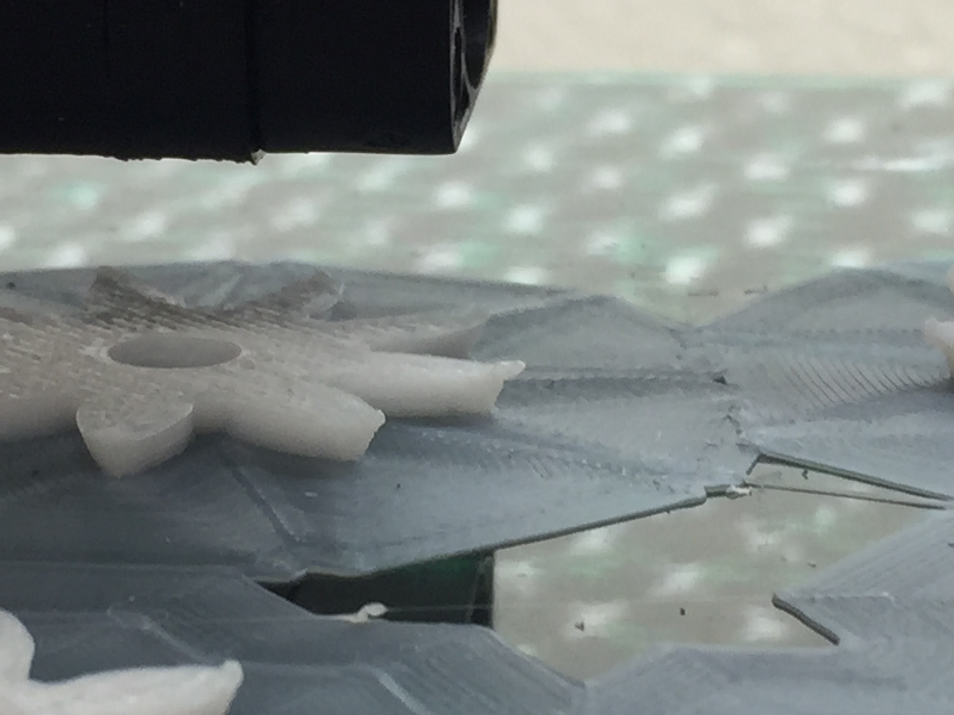

I’m still not having a lot of luck with this print on the TAZ. For the following pictures, the only change was to get the .gcode from Slic3r instead of Cura.
 ![IMG_1720.JPG](https://us1.discourse-cdn.com/flex020/uploads/lulzbot/original/2X/f/fa62de6bccdd4290800d8ebd5038ff9e7d114035.jpeg)
 ![IMG_1721.JPG](https://us1.discourse-cdn.com/flex020/uploads/lulzbot/original/2X/c/cddbbd933d5dae8703e480d4ad3763b498ceb452.jpeg)
As you can see, it’s still pretty gnarly along the edges. However, there were some small improvements in other parts of the print. Check it out
 ![IMG_1722.JPG](https://us1.discourse-cdn.com/flex020/uploads/lulzbot/original/2X/7/7ae20f38c974e6c7045a4e7a7136e8a2c73cf728.jpeg)
even SOME of the edges came out just fine
 ![IMG_1724.JPG](https://us1.discourse-cdn.com/flex020/uploads/lulzbot/original/2X/5/565287478dc9e66c38d02fac1e5950fb19dafd22.jpeg)
So, I’m still stumped. I will try the slower speed and other settings that edlink mentioned when I get a chance.

Here are some pics of the print where I tried edlink’s suggestions.
cooling threshold brought down to 10 mm/s, layers seam pos set to random, and also unchecked the “avoid crossing perimeters” box.
 ![IMG_1740.JPG](https://us1.discourse-cdn.com/flex020/uploads/lulzbot/original/2X/3/3e3ae7b646893288babdfa53a60183df1209d854.jpeg)
 ![IMG_1741.JPG](https://us1.discourse-cdn.com/flex020/uploads/lulzbot/original/2X/b/b501c06a670fc71834223ed37a2653b8b562a069.jpeg)
I am still printing using PLA - This time I tried 190/60. I get a smoother extrusion but, as you can see, I’m still getting some bad looping on the corners. However, you may also notice, that I get some edges which come out just fine. There doesn’t seem to be any rhyme or reason to which edges come out and which ones don’t. I will also attach the gcode file for this print.

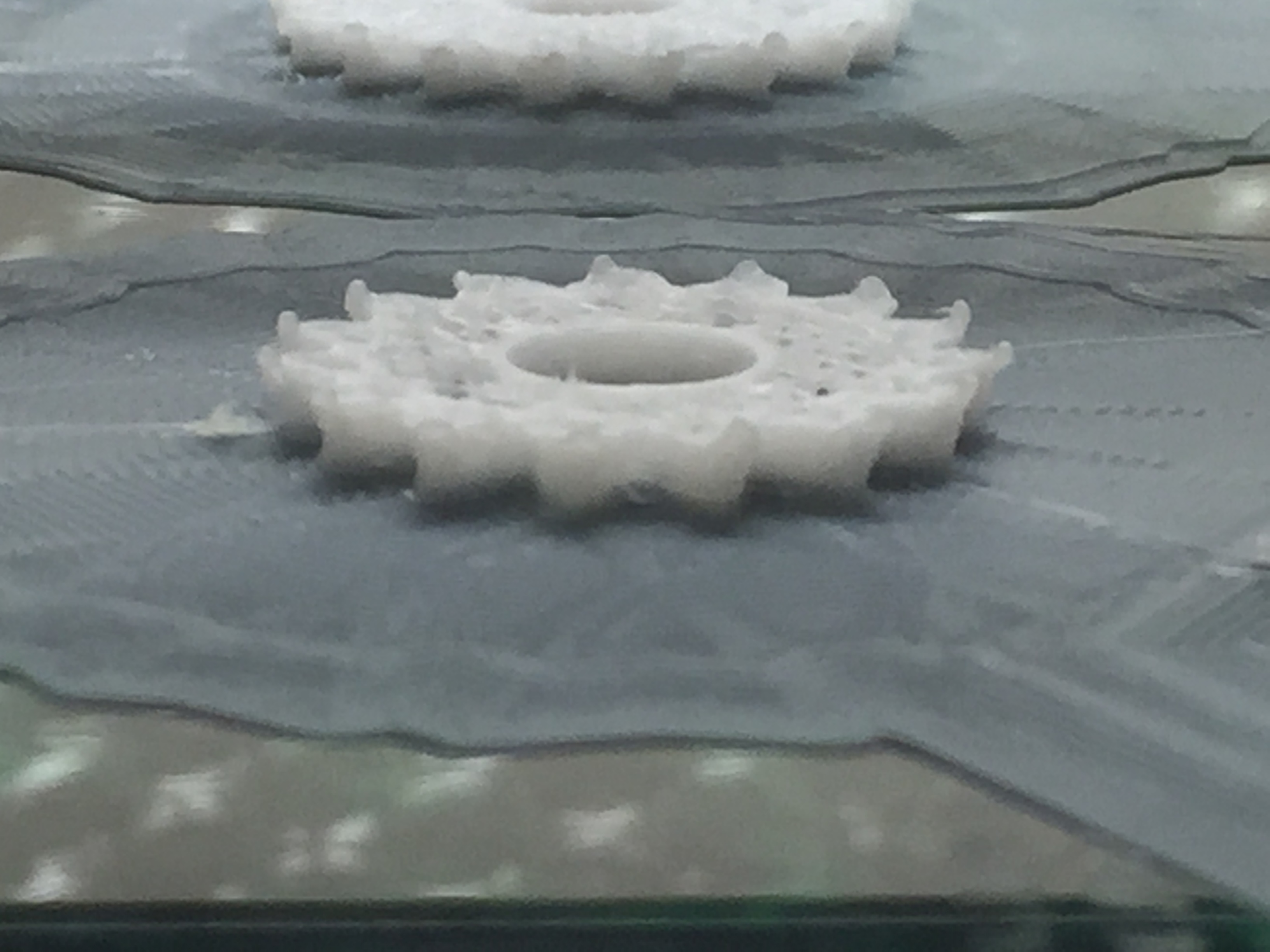

Are you noticing that the teeth on the outside of the print are less affected? I’ve been watching my TAZ print this morning and it seems like a lot of my issues are coming from when the nozzle moves from part to part. I use a 1mm retraction length with a 0.5mm Z lift but I am noticing that a little bit of ooze will form on the nozzle tip and then be deposited on whatever gear point the nozzle moves to next. Once the blob is there it messes things up for a few layers but then a move happens where another blob will be deposited.
Both of these photos are of the same gear. They are one layer different. Why do some photos orient themselves in weird positions! Does anyone know if there is a way to rotate photos after they are uploaded?
 ![IMG_0577.JPG](https://us1.discourse-cdn.com/flex020/uploads/lulzbot/original/2X/e/e61b8b0477367451aa72c49d76544ec27ae27d18.jpeg)
 ![IMG_0575 2.JPG](https://us1.discourse-cdn.com/flex020/uploads/lulzbot/original/2X/e/e8486e94b4e95a34e983c3fb3375dbb43c2c86cb.jpeg)
 ![IMG_0573.JPG](https://us1.discourse-cdn.com/flex020/uploads/lulzbot/original/2X/d/de0d0cda8d434cede3a77dc221ca5537498a65b2.jpeg)

**Post date:** [February 19, 2015, 5:55pm UTC](https://forum.lulzbot.com/t/print-resolution/1264/17 "2015-02-19T17:55:14Z")
The heart gears have a ton of overhangs. Anytime that’s the case you’ll want to have more than one perimeter, and lots of active cooling. The one print cooling fan may not be enough. The gears print best in PLA, and with the extruder fan on, all the time. I used an additional desktop fan, off to the other side of the extruder to print mine: [http://www.midsouthmakers.org/2012/02/a-very-maker-3d-valentines-day/](http://www.midsouthmakers.org/2012/02/a-very-maker-3d-valentines-day/)
You’ll see that on the side of the fan your overhanging surfaces look good, but the side away from the fan doesn’t look as clean.

Here is from my last print:
Cura, ABS, no fan
.3mm layer height
.35 nozzle
15mm/s perimeter
.85mm shell thickness–this seemed to help.
Cura has the nozzle do a two pass perimeter then it will come back and do a quick jiggly pass on the inside of the perimeter wall. It seems like the plastic gets semi-molten again and sags down enough to keep the gear point level with the rest of the build. I would say that the rest comes down to needing a smaller nozzle so that the overhanging material is smaller and has more to grab onto relative to its mass. But the UM2 has a .4mm nozzle so that throws that logic out–somewhat.
I’m going to run this print with the same slice settings. amcbride you should do the same with PLA in both machines so we can get a nice comparison. Note what the fans are doing on you UM2.

 ![IMG_0580.JPG](https://us1.discourse-cdn.com/flex020/uploads/lulzbot/original/2X/b/b5fa2c39c1b87f61a62ac069927c06d27577caeb.jpeg)
 ![IMG_0581.JPG](https://us1.discourse-cdn.com/flex020/uploads/lulzbot/original/2X/d/d25e16e8929b88d435b33b171de02c4619892fe3.jpeg)
 ![IMG_0578.JPG](https://us1.discourse-cdn.com/flex020/uploads/lulzbot/original/2X/7/774451f2dd71313eef3841b7654f9edeec413b7c.jpeg)
**Author:** ![amcbride](https://avatars.discourse-cdn.com/v4/letter/a/9fc29f/32.png) [@amcbride](https://forum.lulzbot.com/u/amcbride)\
**Post date:** [February 19, 2015, 8:34pm UTC](https://forum.lulzbot.com/t/print-resolution/1264/20 "2015-02-19T20:34:43Z")
The thought definitely occurred to me regarding the dual fan setup of the U2. I will attempt to print the overhang test as soon as I can. I currently have the U2 ‘rented out’ to a classroom teacher (I work in a school district). When I get it back, I will do the test print.
So far, all of my print attempts of the heart gears have had 2 (min) perimeters, the box for ‘always on’ checked for the fan, and fan speeds set to Min: 55 Max: 100 in Slic3r. I noticed that, during the print, the fan was usually running at 100%
In the meantime, I will try a print with a ‘desktop fan’ blowing on a PLA print on the TAZ and see what improves.
