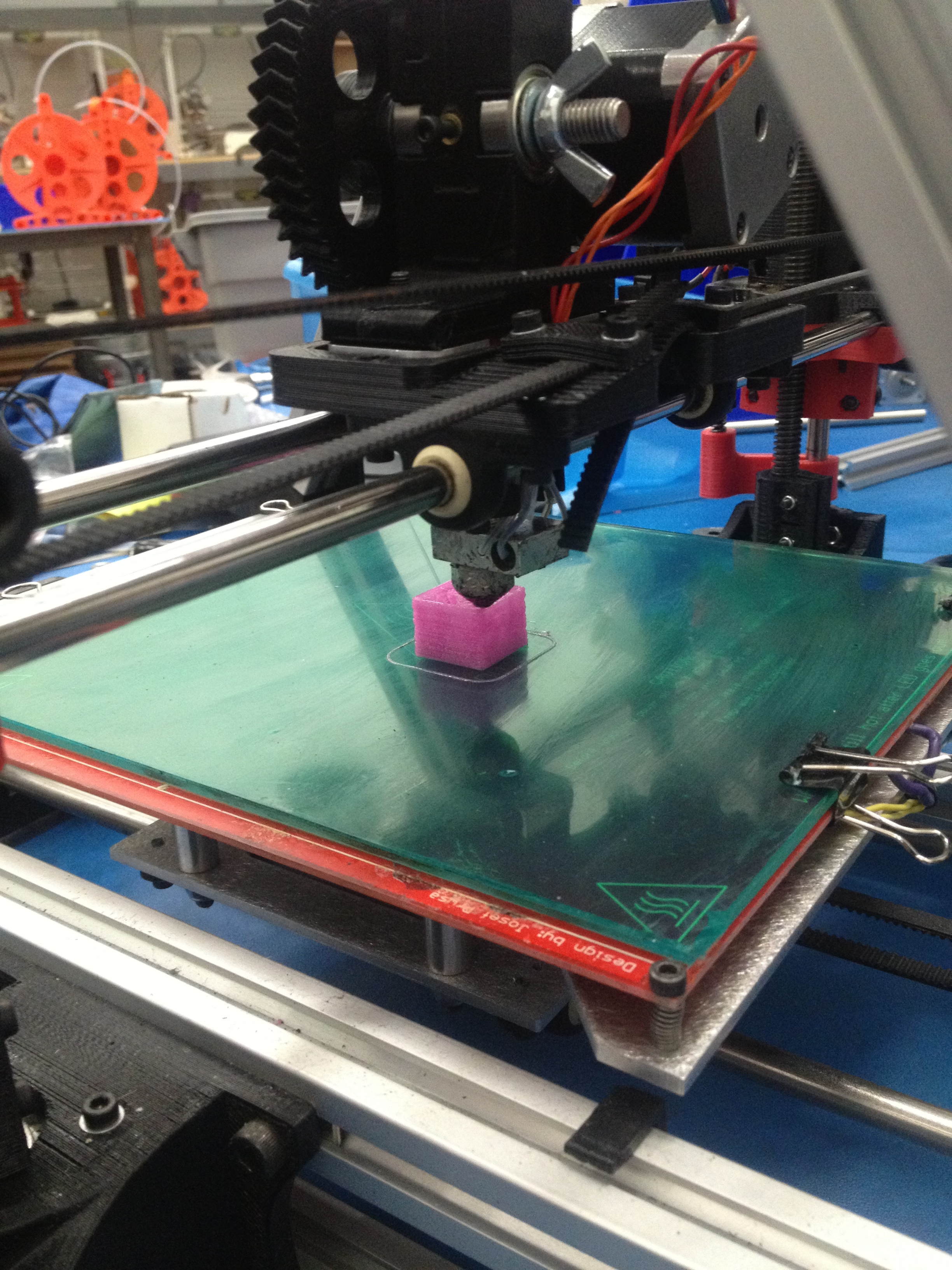

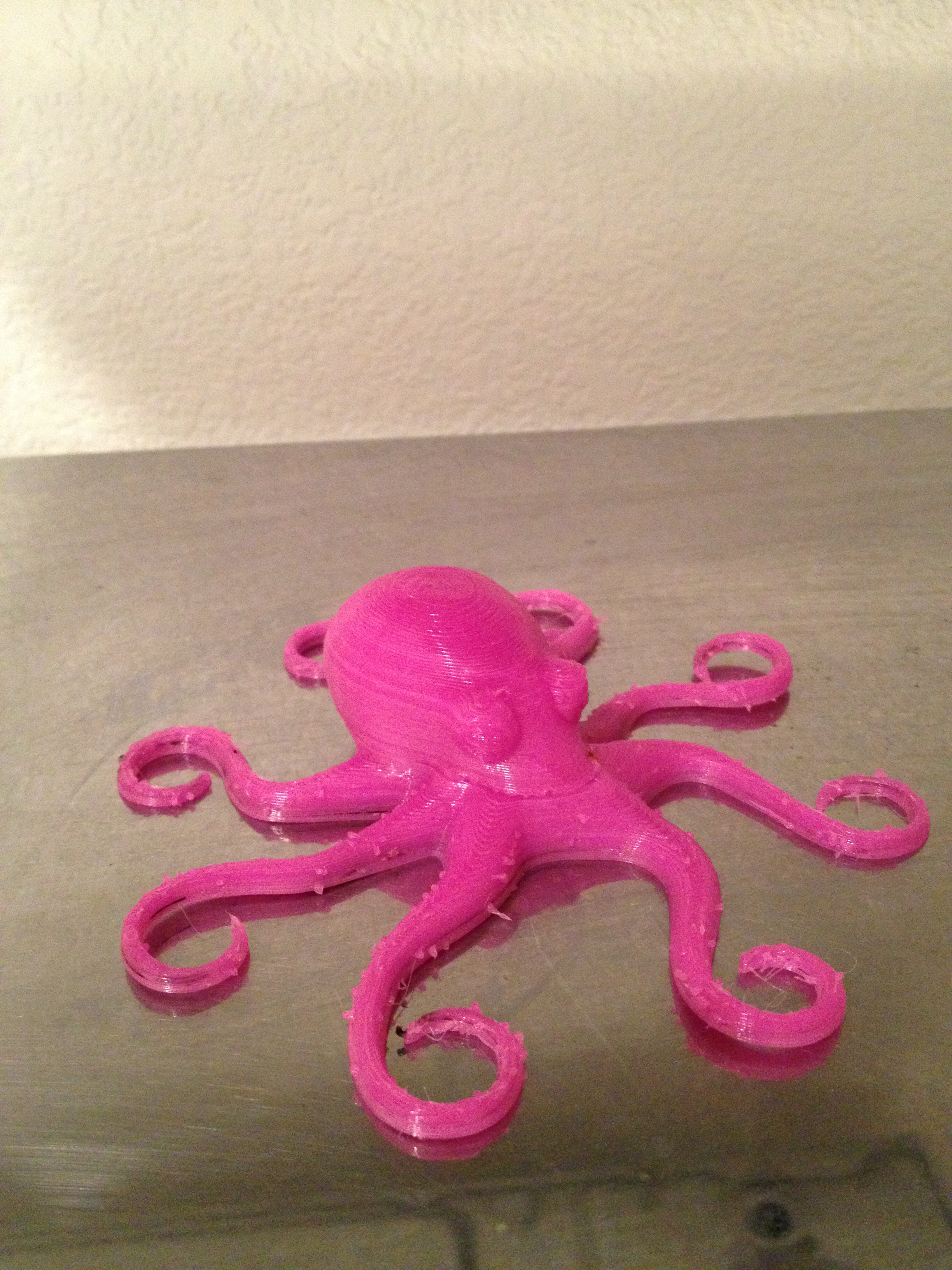

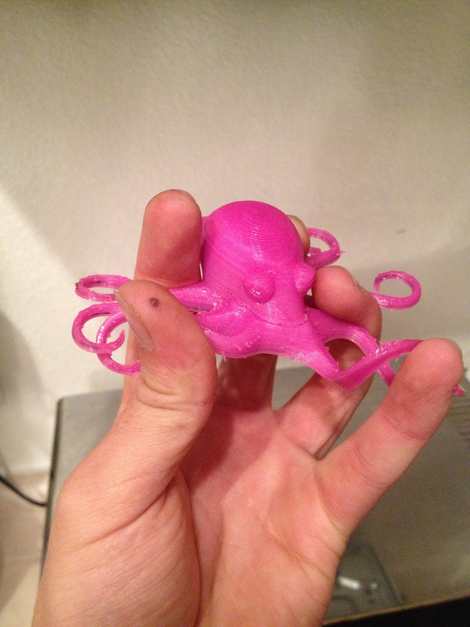

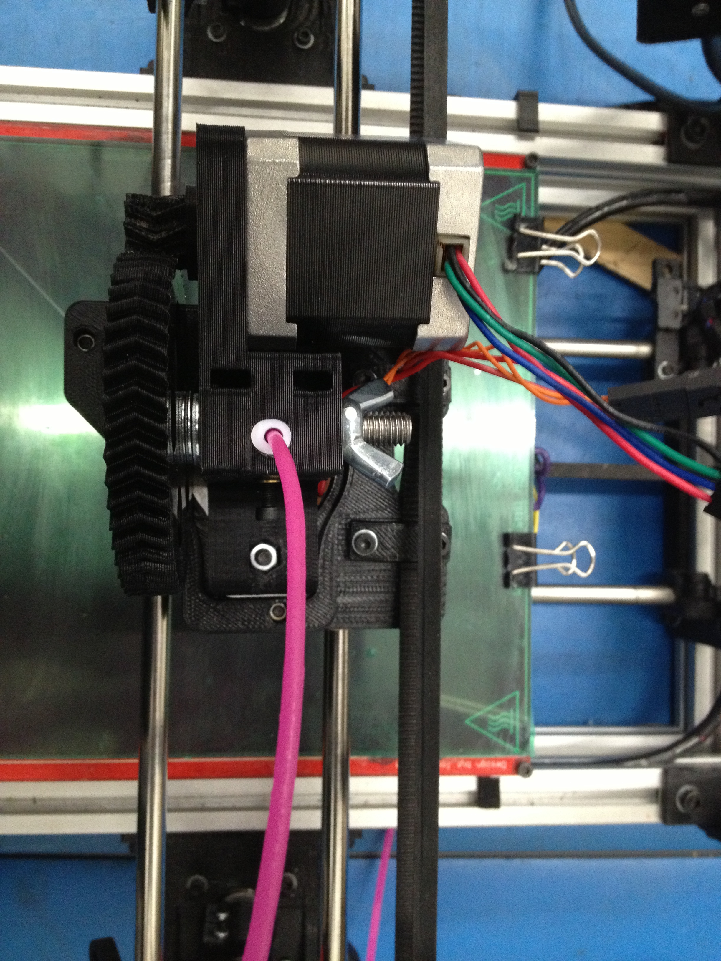

While none of them are technically ‘rubber’, there are a number of flexible filaments available for 3D printers. We’ve just developed a new extruder that will let you print with even the springiest filaments.
Though this extruder is still in the early testing phase, you can follow along and try it out yourself. Everything you need to get started is at [http://devel.lulzbot.com/TAZ/accessories/flexystruder/](http://devel.lulzbot.com/TAZ/accessories/flexystruder/), including freeCAD source files and images of the extruder and FilaFlex material (including turning a spiral vase completely inside out!).
Here’s a great write-up on printing with various types of flexible filament:
[http://forums.reprap.org/read.php?1,269018,269018#msg-269018](http://forums.reprap.org/read.php?1,269018,269018#msg-269018)
Enjoy!
-bam

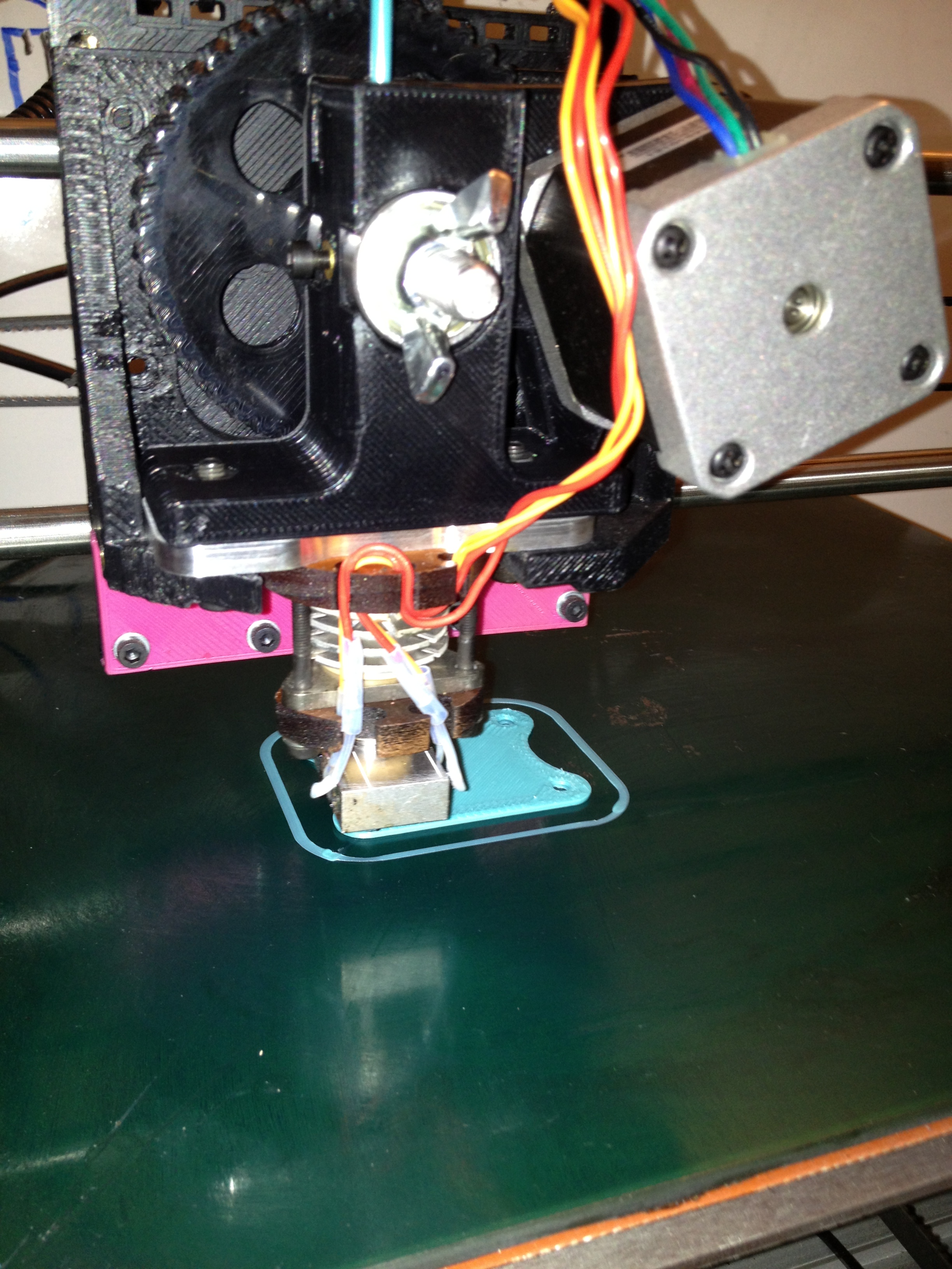

Cool! Can you print standard ABS with the same extruder? Or will you want to swap out for ABS and whatnot?

We’ve printed with ABS with this nozzle using our production g-code (pretty quick) for about 6 hours so far with no issues, so things are looking good for it. I’ll keep posting as I try it with different materials.

This material is awesome, by the way. It is very strong & flexible, even walls printed one extrusion width wide.

This looks very exciting. I printed the extruder yesterday. Do we have a complete BOM yet? I noticed there is a screw on the side that I don’t think I have (I am running a TAZ 1). Are you guys going to sell the filament?
Thanks,

The BOM is now up on [http://devel.lulzbot.com/filament/thermoplastic\_urethane/Flexystruder-0.1/](http://devel.lulzbot.com/filament/thermoplastic_urethane/Flexystruder-0.1/), along with some pictures that should help assembly. The screw on the side is an M3x12, though most sizes longer than 10mm should work, it’s threading into an M3 heatset insert. We’re currently looking into US suppliers of the thermoplastic urethane (filaflex/ninjaflex), and are working with Village Plastics (our main supplier) to bring on some rubberized PLA.
BTW thermoplastic urethane will hotswap and bonds to ABS very well 🙂
Hope this helps
-bam

Is there any way we could get a photo of the other side of the extruder? There are just a couple of more things I’m confused about. Please pardon my ignorance…
Marty

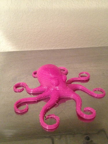

I noticed that the gcode was generated for 0.5mm nozzles. I have a 0.35mm nozzle so I was wondering if anyone had suggestions for layer sizes to print this extruder? I had some issues attempting to print using .3mm layers.
