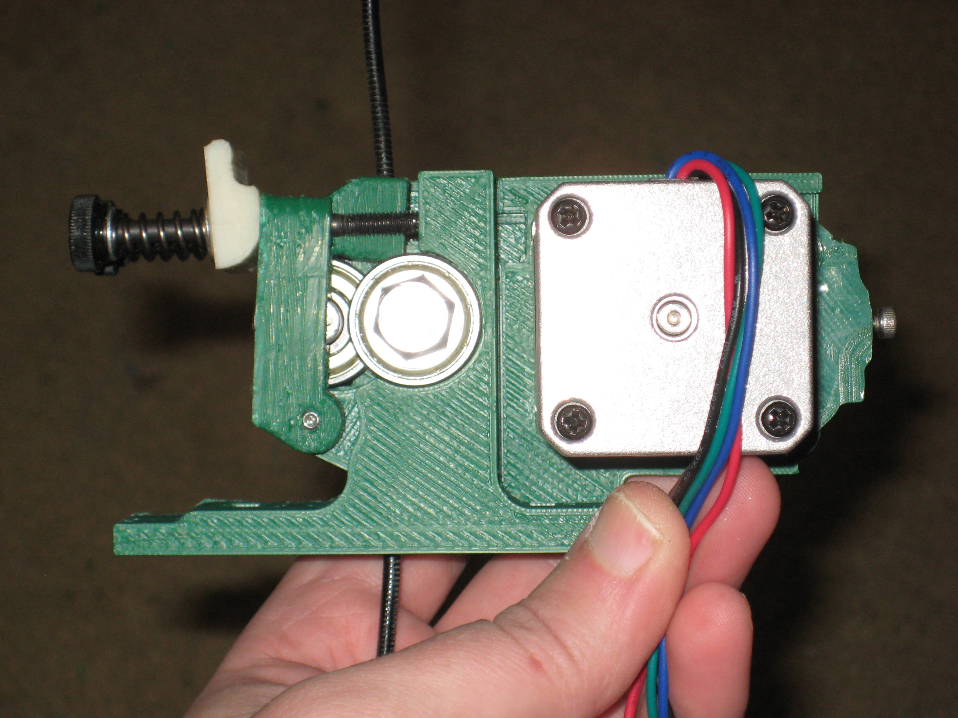

Per the other belt drive thread, but in order to keep all the development files in the same thread, here is a theoretical belt drive flexystruder (normal, not quickfit for now). I will make a quickfit variant of it next since I’ll need one for my machine if nothing else. It’s 2 parts at the moment, an optional belt tensioner designed to have a threaded insert in the hole in the side. the base belt drive flexystruder can be used without the tensioner plate, but the nema mount might be too thin without it. the tensioner is designed to sandwich between the base and the motor, turn an M3 screw in the threaded insert to put tension on the belt with the motor losely in place, then tighten all 4 motor mount bolts when you have the desired belt tension in place. also should prevent belt tension loss over time.
 ![beltflexy.png](https://us1.discourse-cdn.com/flex020/uploads/lulzbot/original/1X/11ce194564dd69bcf5f64272645bdf135129a575.png)
feel free to use the design in any way you see fit.
Parts required for the belt mod (aside from already required flexystruder parts)
1. gt2 belt, 2mm pitch, 200T, 400mm length, 6mm-with, fiberglass-reinforced, closed-loop
2. gt2 65T plastic pulley w/8mm bore, flanges, set-screw
3. gt2 17T aluminum pulley w/5mm bore, flanges, set-screw
the gear set can be purchased here with the belt for $25. select "belt and gears only from the drop down instead of the full kit for the other style extruder: [http://store.terawattindustries.com/77-00str00der-belt-driven-extruder.html#/00str00der\_assembly\_options-belt\_and\_gears\_only/00str00der\_parts\_options-no\_nema17\_motor](http://store.terawattindustries.com/77-00str00der-belt-driven-extruder.html#/00str00der_assembly_options-belt_and_gears_only/00str00der_parts_options-no_nema17_motor)
4. an additional heat set insert
5. an additional bolt that fits the heat set insert.
edit: to use this extruder in place of a wade’s geared herringbone version, you may need to adjust the extruder steps per mm line of your controller configuration. The measurements to do so accuratly are as follows:

I really like this. Super excited to see one running.
**Post date:** [December 5, 2013, 6:27pm UTC](https://forum.lulzbot.com/t/print-with-rubber-on-your-lulzbot/334/23 "2013-12-05T18:27:03Z")
Glad you like it! Belt and pulley should be here tuesday-ish? The order got stuck in processing for a few days, but it has shipped.

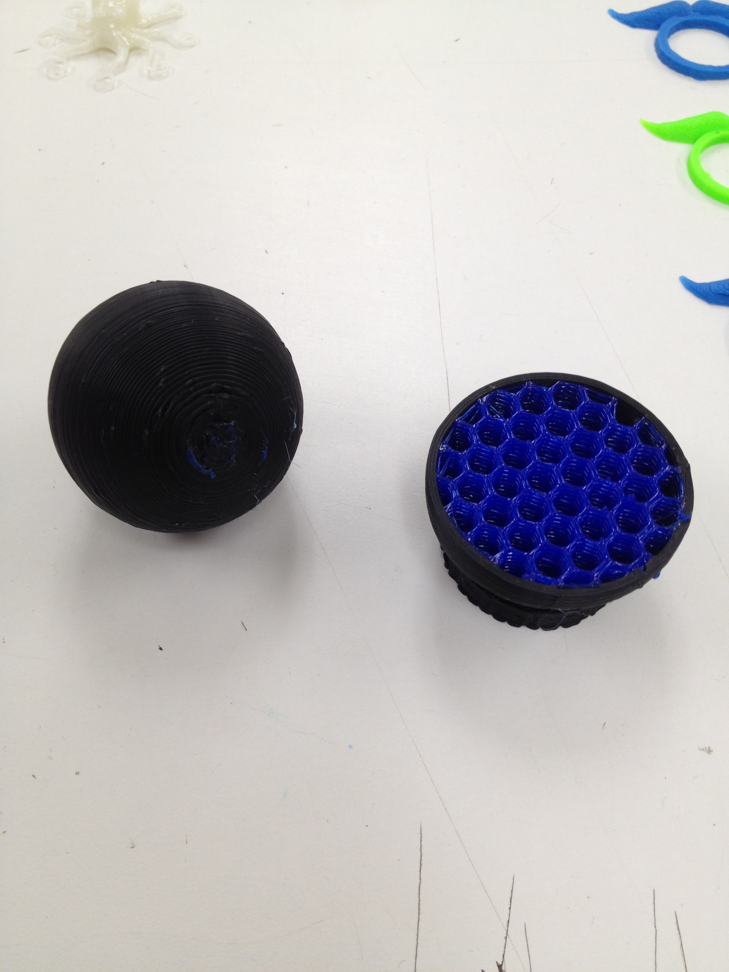

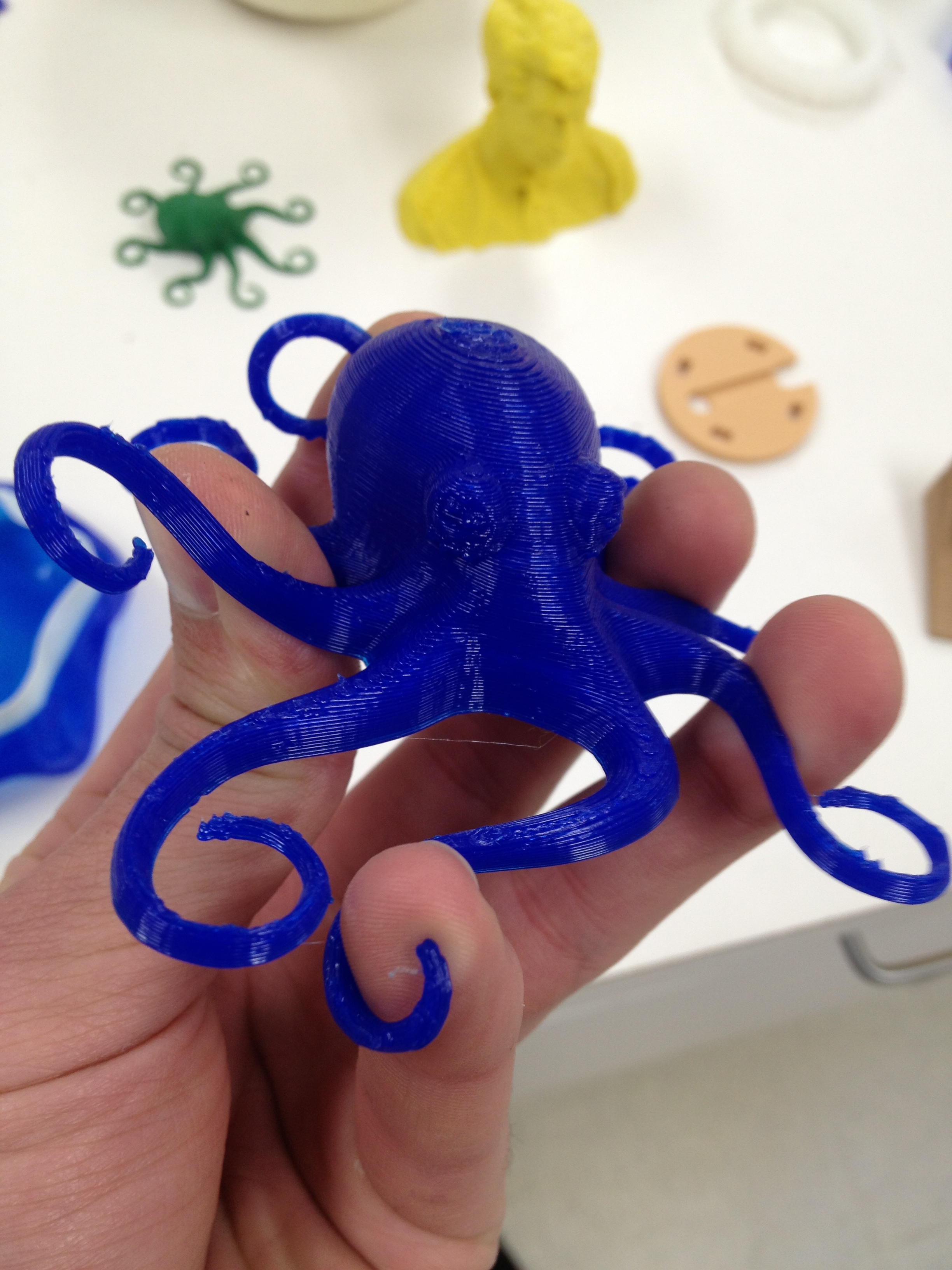

The Flexystruder V0.5 is here!
I’m really happy with the way that the newest version of the flexystruder is printing, And I think it’s time to get some feedback from our users.
So far we’ve tested it with flexible PLA, filaflex (black and pink) and Ninjaflex (Sapphire, white and red) without issues. The flexystruder “will” print with ABS, PLA or other hard polymers, but since this wears out the PTFE lining we suggest only printing small amounts when you need to hotswap between flexible and rigid materials.

Up on [http://devel.lulzbot.com/](http://devel.lulzbot.com/) we’ve posted an updated bill of materials, as well as assembly instructions. Look under TAZ/accessories/flexystruder
Let me know if you’ve got any questions/comments/cool things to share
-bam

We have printed maybe 10-20 “rubber” parts so far. This material is _very_ strong. The parts are turning out very well. This is going to be a hugely useful material for people to use.

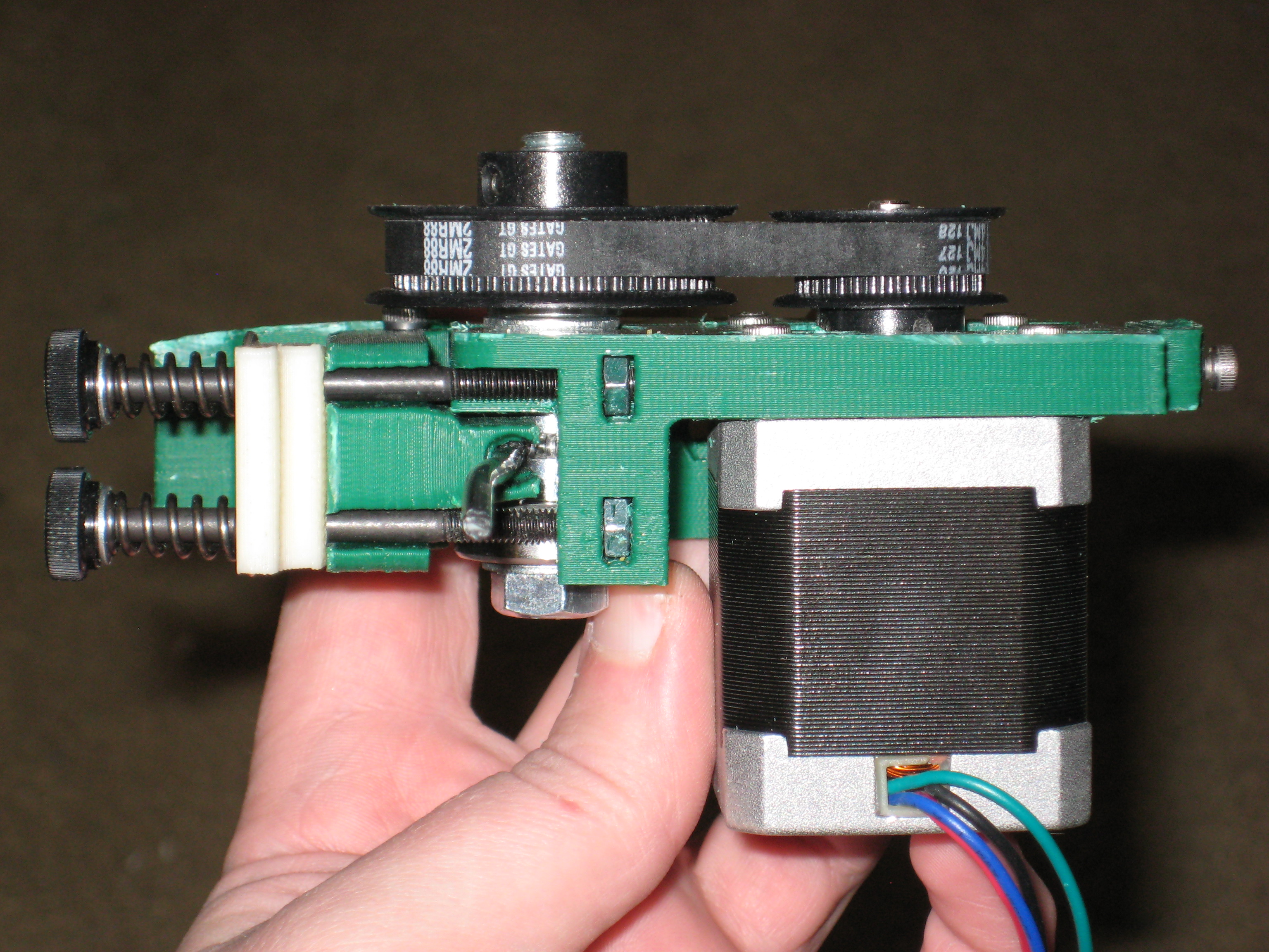

I went ahead and made a quick fit standard idler belted extruder at the same time so I can compare the two directly. It uses the same tensioner as the flexystruder belt variant.
[http://www.thingiverse.com/thing:224242](http://www.thingiverse.com/thing:224242)
**Post date:** [January 13, 2014, 12:12am UTC](https://forum.lulzbot.com/t/print-with-rubber-on-your-lulzbot/334/39 "2014-01-13T00:12:39Z")
Here’s the standard wades belted unit printed. I changed the tensioner around a bit. the belted flexystruder will be the same general motor layout. But now I’m waiting on filament since I ran out. Oops.

Lookin good!
