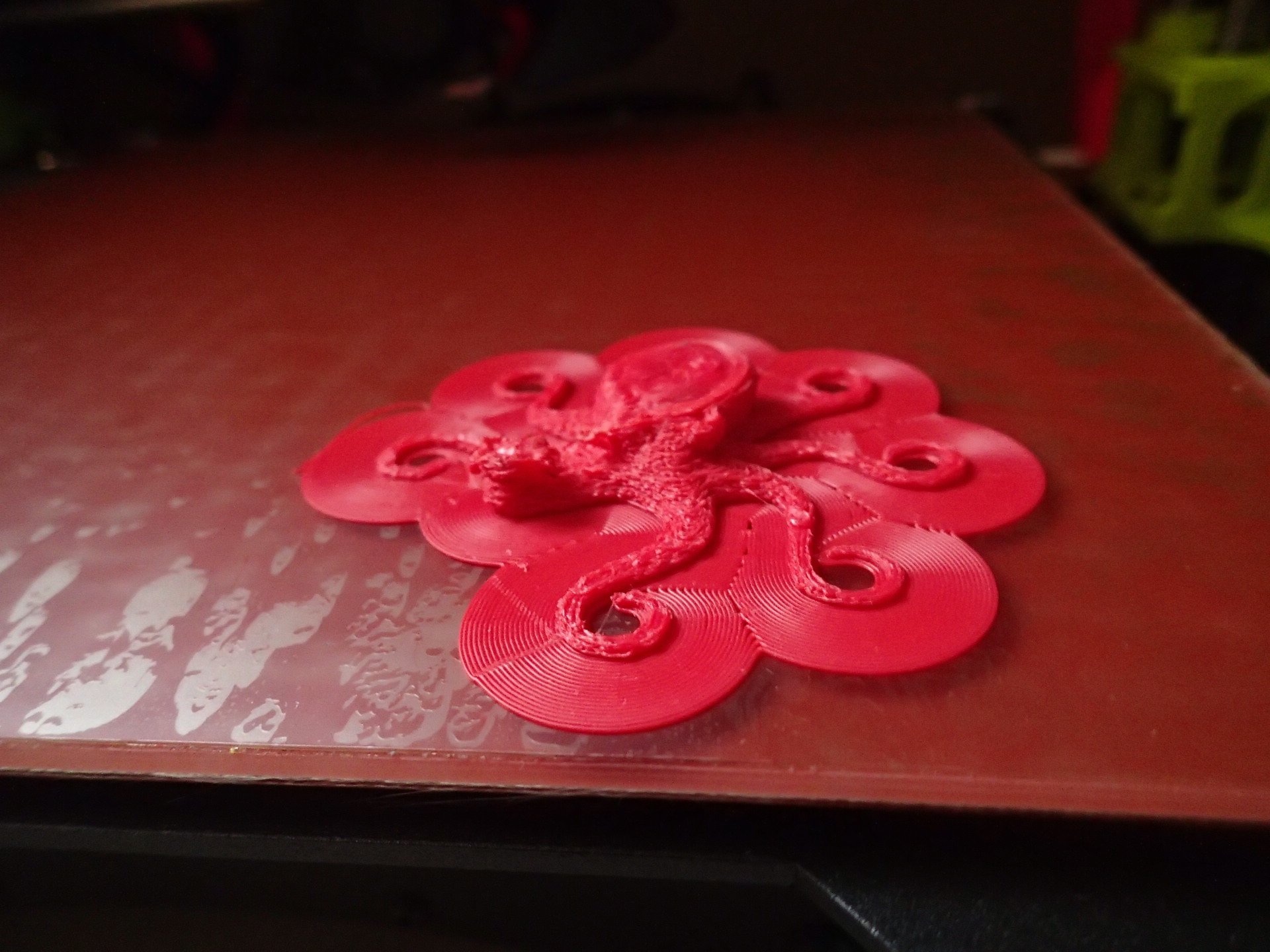

Hi I’m new here- so as my very first question ever: Just bought my first Taz 6, the rockopus print came out fine, nothing wrong there… then on my second print everything went wrong?
I used the nGen filament for a test print and that went wrong, at 80% it went from perfectly fine to messy and I had to stop the print as the nozzle pulled the print off the table, the second green one I had to stop earlier as the fish went messy even before 50% finished but I learned to put a brim on it that time.
Then I changed the filament to ABS, and of course changed the setting on cura- for that one, same test print and had the same problem, see photos: The first red one got to 80% finished and then went messy, so I changed the orientation of the second fish on Cura and that made the second red print even worse? It seems as if the nozzle actually impacted the object and made a scratch along the top when it finished- the flat red fish one in ABS- I’ve been up and down the forum looking for answers but everyone is slightly different than mine.
If your wondering the ABS came from Lulzbot- got it from Amazon for about £8 a kilo/spool- hope I had Cura on the right settings?

**Author:** ![Galadriel](https://avatars.discourse-cdn.com/v4/letter/g/c89c15/32.png) [@Galadriel](https://forum.lulzbot.com/u/Galadriel)\
**Post date:** [February 4, 2018, 10:52am UTC](https://forum.lulzbot.com/t/printer-has-gone-wrong-on-second-print/5576/2 "2018-02-04T10:52:28Z")
Have you verified this isn’t a file issue? It kind of looks like you might have a slight file error that is cause poor slicing of the model. Try reprinting the rocktopus to see if it still prints well, then if the rocktopus comes out well try posting the .stl file here to get looked over for file errors.

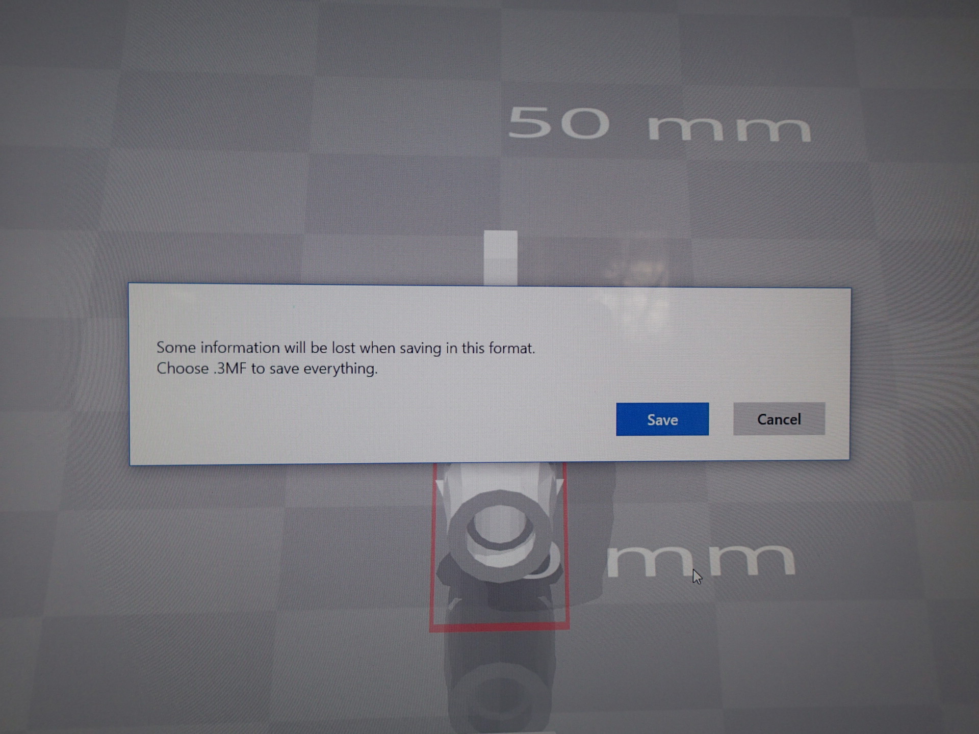

**Author:** ![olantigh](https://avatars.discourse-cdn.com/v4/letter/o/dbc845/32.png) [@olantigh](https://forum.lulzbot.com/u/olantigh)\
**Post date:** [February 4, 2018, 1:22pm UTC](https://forum.lulzbot.com/t/printer-has-gone-wrong-on-second-print/5576/3 "2018-02-04T13:22:12Z")
I will do that right now, but I’ll have do it in ABS because I’ve run out of nGen, however I think you might be right- when I saved the files/changed them- although they where originally stl files, I had to open them (in a 3d viewer) and resave them- there was a message saying some sort of information was missing, did I incorrectly convert/save them perhaps- I’ll post the exact message right now to let you see what I mean. (I’m new to all of this- and this would be very helpful many thanks)Just as an experiment, I tried to reopen the stl file in cura itself and it worked? (surprisingly?)maybe this is what I should I have done in the first place?(silly me) (forgive the picture quality- quickest way of posting them)

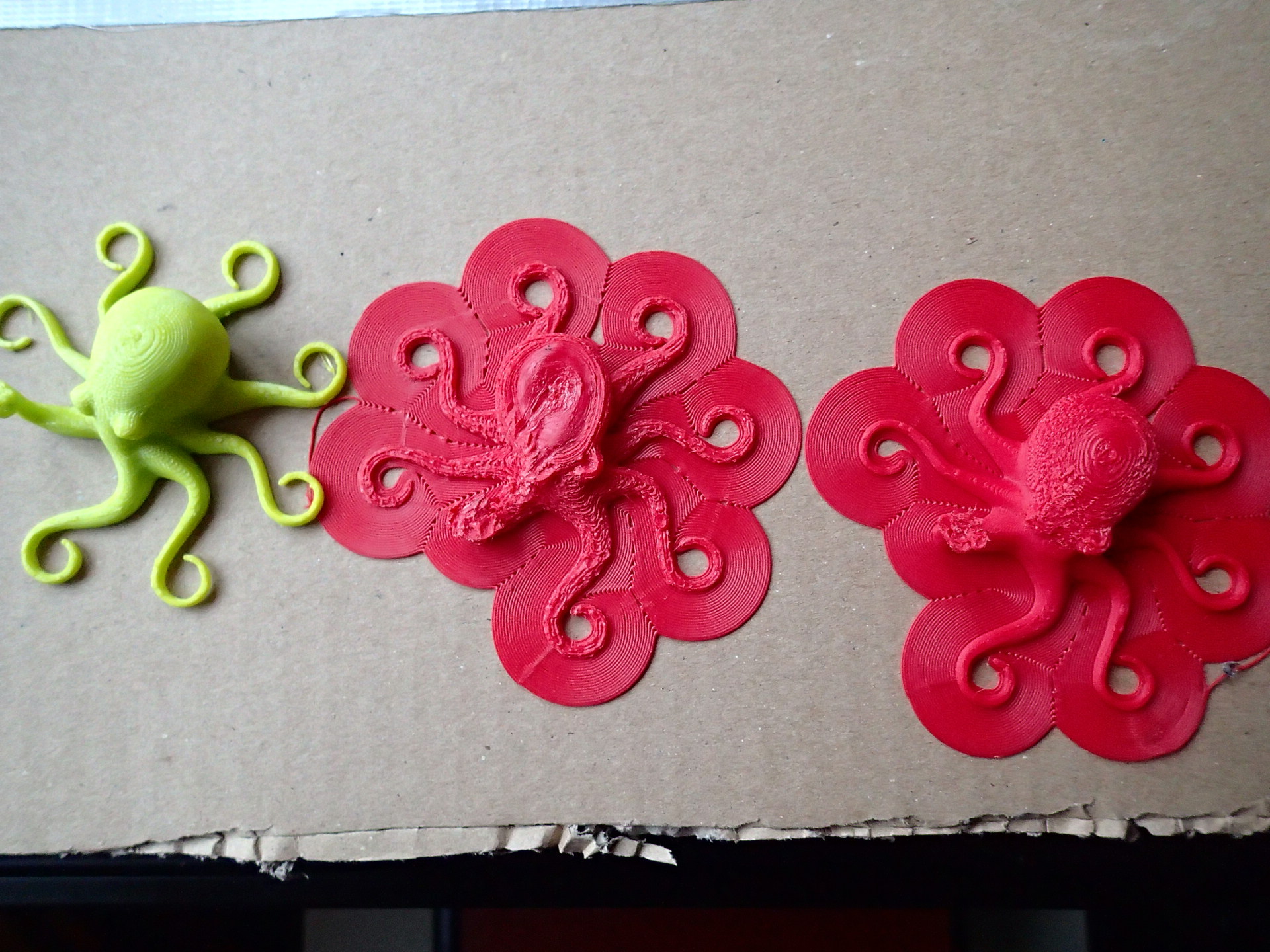

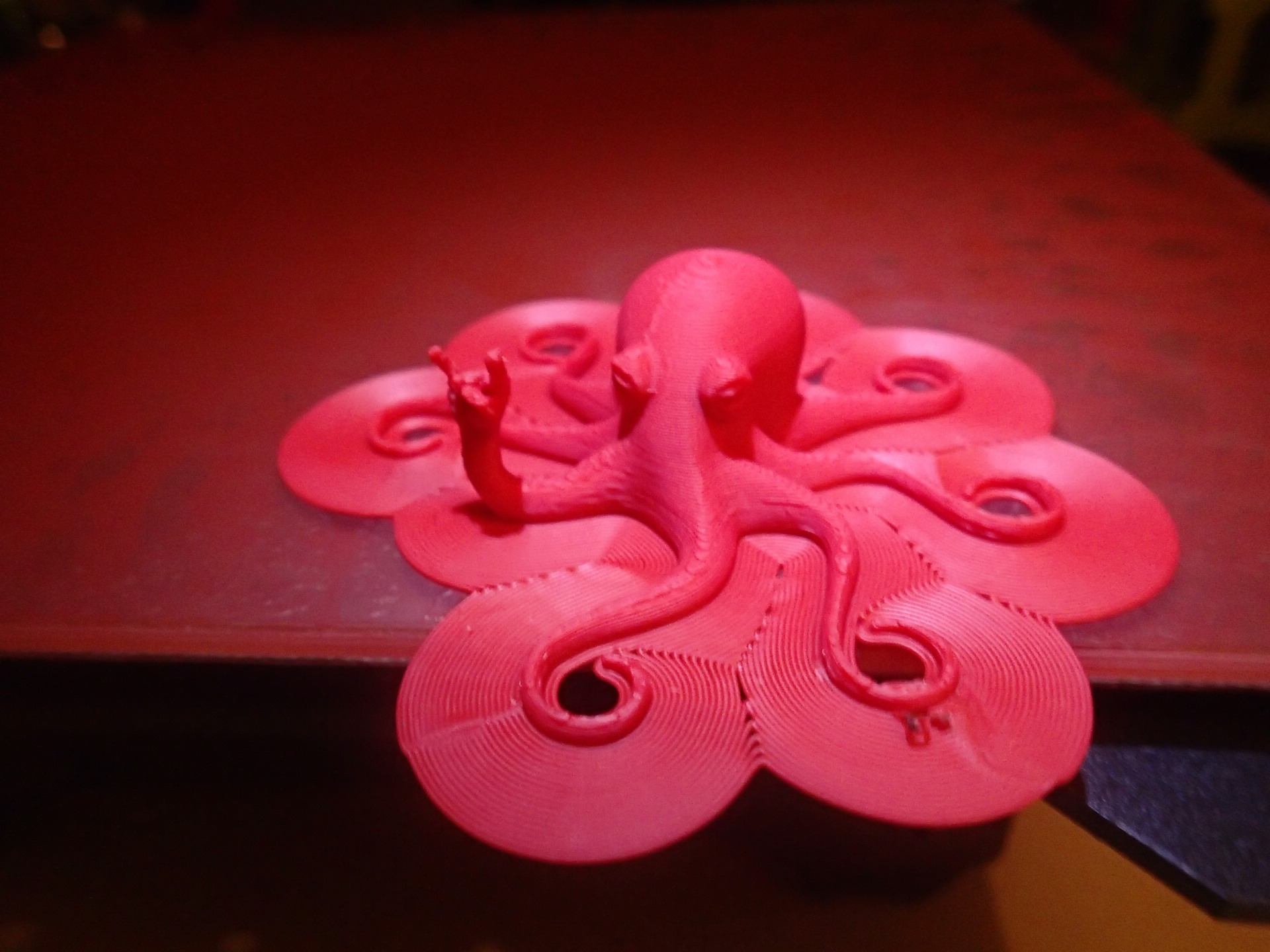

**Post date:** [February 4, 2018, 3:14pm UTC](https://forum.lulzbot.com/t/printer-has-gone-wrong-on-second-print/5576/4 "2018-02-04T15:14:05Z")
Just done what you asked; Here is the result- oh dear it has really gone wrong this time- I opened the file directly into cura, recommended setting, added a brim, ABS village (presume that’s the right setting- all the other ABS settings are the same from what I can see) 20% infill, saved to the card- and off I went, remember my home pc is not connected to the printer- so I have to do everything through the lcd on the printer.
The three pictures- Red ABS on its own close up, Green nGen first print and my ABS rocktopus, and thirdly I noticed the bar at the back is not straight when it finished its two centimetres higher on the right- however it corrects this when printing- making a very loud noise when it prints- beds flat though. Oh and the nozzle banged in to the print again making a dimple into the top of the print- even if its flattened, very odd.(something is definitely not right!)

**Post date:** [February 4, 2018, 4:05pm UTC](https://forum.lulzbot.com/t/printer-has-gone-wrong-on-second-print/5576/5 "2018-02-04T16:05:32Z")
Ouch! That X-axis tilt needs to be fixed before you do anything more!
Turn the printer off. Grasp the left or right vertical lead screw (threaded rod), and rotate it gently by hand in whatever direction will level that horizontal X-axis rod.
Once you have it looking level by eye, get a precise measuring device (metal ruler is ideal), and measure from the bed to the rod on the left and right sides of the bed. Then gently rotate the lead screws until the two measurements are as nearly identical as you can get them.
That’ll re-level the axis, and avoid potential jams (and possible damage). It may or may not fix your printing problem.
Keep an eye on this (or better yet, use a metal ruler instead of your eye to periodically check that the rod remains level with respect to the bed – if it changes, you may have other problems with your printer. On a correctly-operating printer, the two motors and the two screws will move precisely in unison so they will never end up cockeyed – and if they do, something’s wrong.

**Post date:** [February 5, 2018, 2:09am UTC](https://forum.lulzbot.com/t/printer-has-gone-wrong-on-second-print/5576/7 "2018-02-05T02:09:11Z")
Make sure the frame is square and all the bolts are tightened… there were issues early on with TAZ 6 out of aligmnent causing the gantry to bind.
Give the idler bolts a turn to help the grip, which in turn should help push the filament through…
