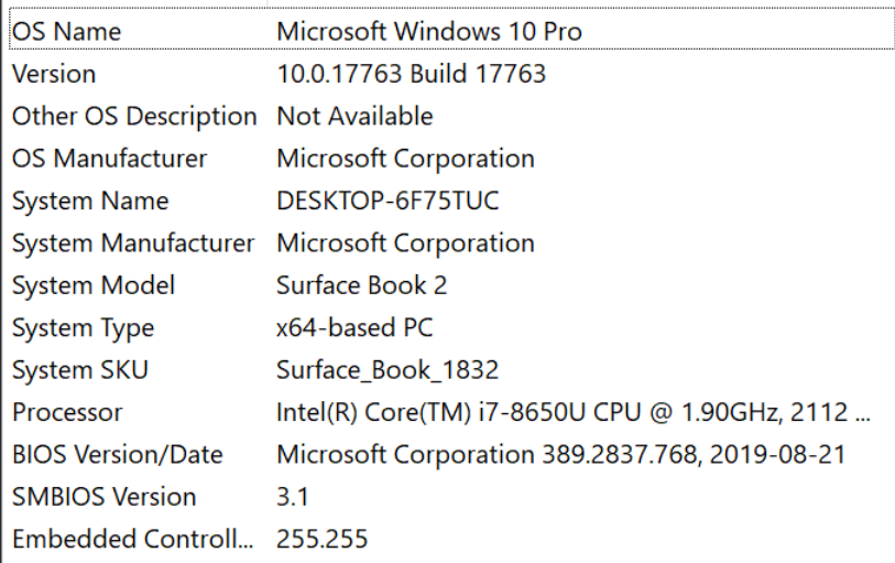

My system:
Without being able to connect to the printer I am unable to ensure my printer is running the latest driver software.

While it is Windows 10, it appears to be a Surface Book. I’m guessing that if a serial port is created from the USB port, it probably isn’t recognized by Cura. See this post that might be related.
Another alternative would be to try Printrun. Pronterface is the GUI for that. Scroll down on the page to find the precompiled files for Windows. This may also fail for the same reason above, but it might be worth a shot.
