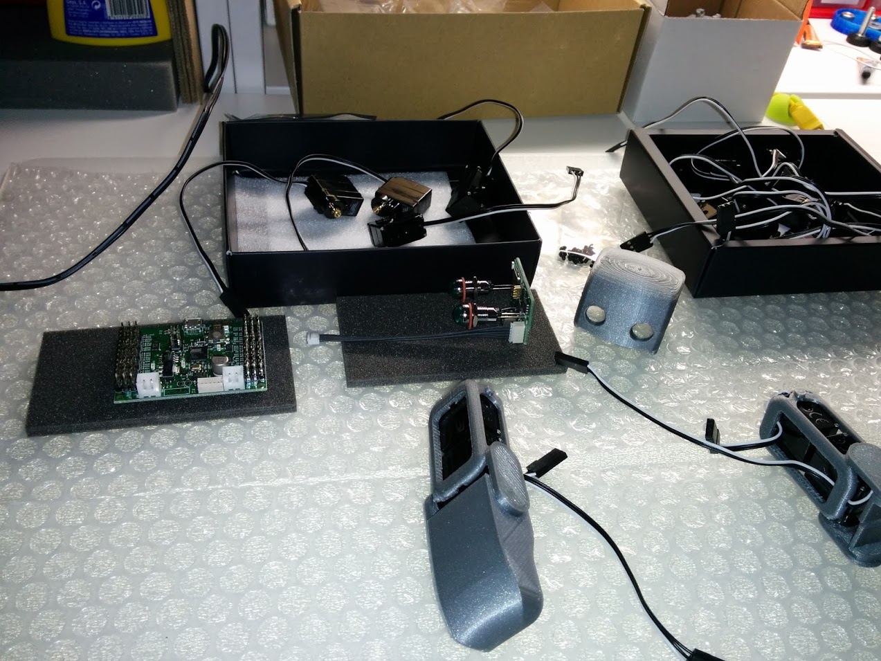

Hi! I´m trying to print a PLEN2 robot chasis, using a normal ESUN silver PLA filament.
I managed to get some parts “correctly” printed (no perfect), but I´m having a nightmare with 70% of the rest.
 ![IMG_20160115_182326.jpg](https://us1.discourse-cdn.com/flex020/uploads/lulzbot/original/2X/2/252b1d3adb04179332e01bddf993be568cc2dfd8.jpeg)
I´m still not a pro with my TAZ5, and even worse there is practically no updated documentation about this robot or is poor.
Here are some thoughts until now (5 days printing low-quality parts).

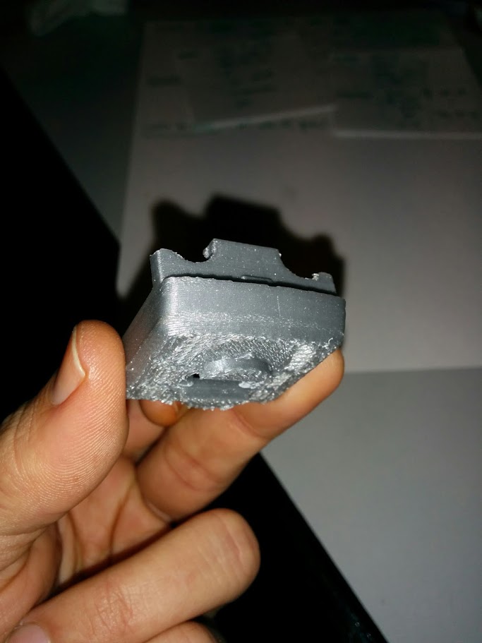

**My pieces are not solid enough**
Well, this is evident: I broke 90% of all the small tabs that should have made a secured “click” when trying to fit them together.
I read that small parts should never be 100% solid, I was using a simple 10-20%. But it seems that this (even being a very slow value itself) is not applied proportionally to the size of the piece itself: 20% is the same separation between infill walls when printing a 3cm figure than when printing a 30cm one, is this concept right? Could a 80% be right in this case?

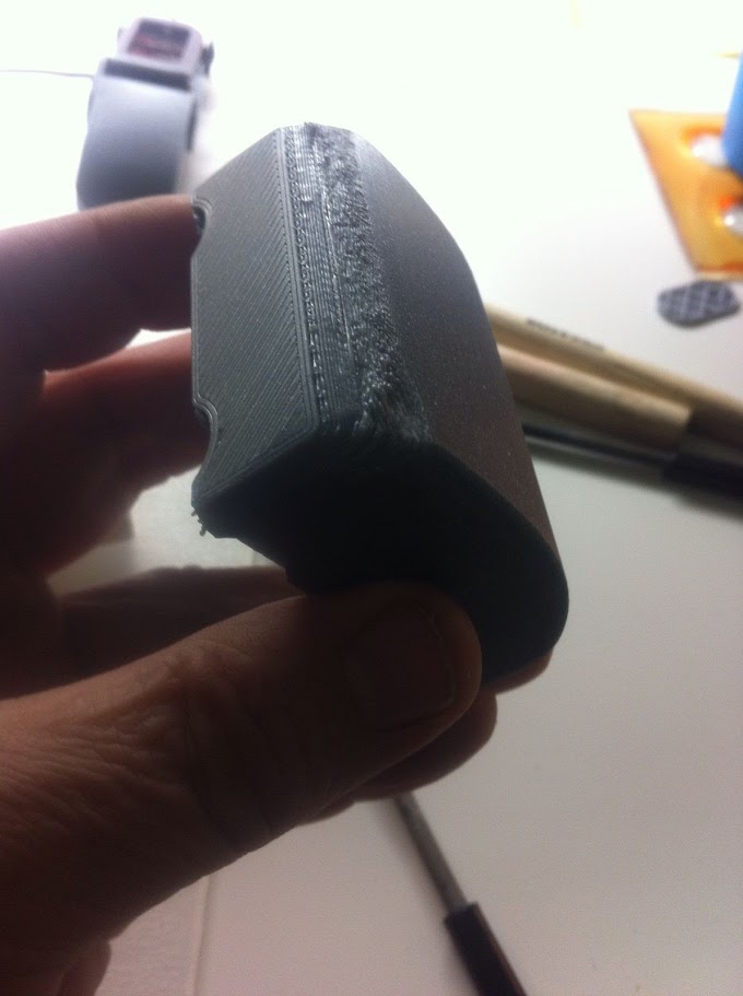

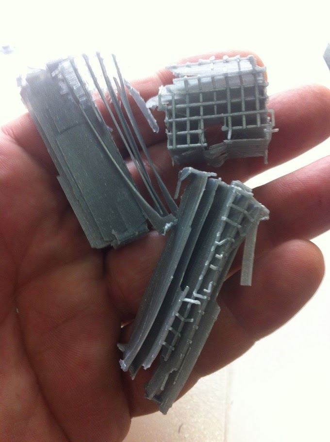

**I officially hate to use support material**
Seriously, I´m angry with myself for still not mastering this important setting. I always have a lot of problems to print some pieces when they need support. I´m now using a custom setting in my last tests (X/Y distance 1mm, Z distance 0.15), but it seems I´m going backwards… My hand is literally destroyed for spending so much time removing this hard-as-rock support material. I´m getting something wrong and I need help with this, no doubt.
(In the previous picture you can also see that I couldn´t remove all the support material, impossible)
 ![IMG-20160117-WA0003.jpg](https://us1.discourse-cdn.com/flex020/uploads/lulzbot/original/2X/b/b2f2e78ebec95323b662367f206f36fe371694e0.jpeg)
Also, if a layer has to be printed “on the air” using support material, the final result is not smooth at all.

To make parts fit better, try decreasing the flow rate by a few percent… give 95 - 97% a shot. I’m actually down to 90% on my prints, but I’ve also increased the overlap in my solid infill layers (top / bottom layers)
You definitely want infill to help with strength… especially if you’ve decreased the shell thickness. You don’t need 100%, but 50% would be good for a part that. I think of infill in volume of that layer. So an infill of 100% would print every adjacent pass in that layer, a 50% infill would print every other adjacent pass. Therefore the overall part would be 50% solid.
For my projects, I try to stick with a shell of 1.5mm. Maintaining the thickness will depend on your extrusion width and layer height. The shell works together with the infill to create strength in a project.
Supports… they can be a pain, but are necessary for accurate parts. I use Simplify3D as my slicer which allows for manual placement of supports. Its rumored that S3D supports are easier to remove… they are, but the trick is to get the proper horizontal and vertical separation. In Cura, look for XY and Z distances under Expert Settings -\> Supports. The XY distance looks good at .7, but I’d optimize as a multiple of your extrusion width. The Z needs to be increased from .05 to .5 or .7, again optimize to be a multiple of your layer height…
The curve resolution is something I haven’t figured out completely… I’ve increased the overlap to help with this be. If there’s a setting for inside out printing, that’s what you want. Versus outside perimeter to inside printing. The other nice thing about S3D, is the ability to generate a higher density raft at the top of the supports before the actual object. This allows the creation of a platform for printing of overhangs, but it doesn’t seem possible in Cura.

From what I have read on infill it would be like this.
20% infill:
3 CM sized part = infill line every .6 CM
30 CM sized part = infill line every 6 CM
