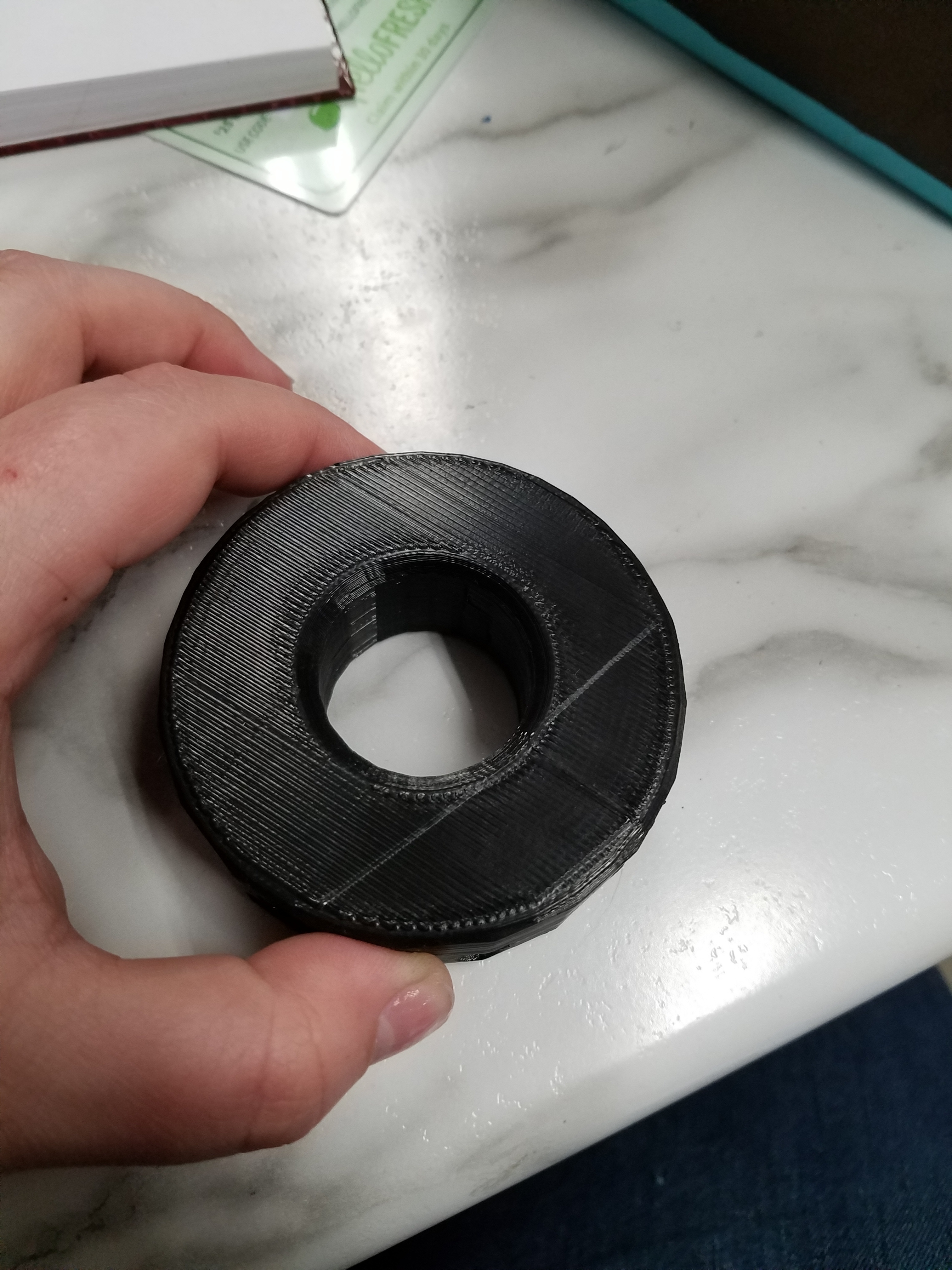

AWESOME. I really like this filament but have issue with the nozzle getting clean which I think could be solved with a printing profile.
I used Polymlite PLA high detail setting but up’d the nozzle temp to 255 and turned off the cooling fan.
The prints were beautiful, just had a hard time getting them off the print bed.
Elmers glue solved a the small issue of filament not sticking to plate, but also contributed to part being a B\*?@h to get off.
The photos are of the part I’m making.

Glad to hear it is printing well! Nylons are one of the stronger materials we have tested, and are looking forward to trying out new blends.
If you started with a PLA profile, the wiping temp will probably be too low to get your nozzle clean. The idea is to get the hot end warm enough to be cleaned, but not hot enough to ooze plastic. For PLA, this is right about 140c depending on the blend. Some of the other nylons we carry we have wiping and probing in the 185c-200c range.
You can update the wiping and probing temp of your profile under the Material option. Once you have those updated along with whatever other changes you would like to keep, go to Quality → Create profile from current settings/overrides. It is really helpful when developing profiles for new filament.
