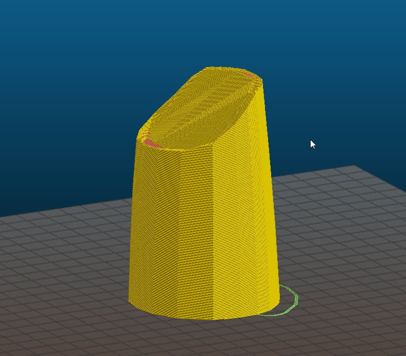

Window 7 16 gig of ram. 5 inches tall. It looks like its a Cura model problem.
Normal view in Cura show the entire model, but in layer view I see where the top part is will not print.
In slic3r both views looks good.
How can I print the Gcode that is generated by slic3r. Do I have to have a SD reader and copy the file on that and return back to the TAZ slot?

**Post date:** [September 25, 2015, 6:23pm UTC](https://forum.lulzbot.com/t/printing-stop-object-not-complete/2264/9 "2015-09-25T18:23:55Z")
I figured it out. Instead of exported the model file to .STL straight from the 3D program like Maya, the .STL needs to be opened in Slic3r first then exported again to a .STL and opened in CURA.
Slic3r probably fixed the error/s the model had and the saved STL from Slic3r could then be correctly sliced by Cura.
**Author:** ![manguy](https://avatars.discourse-cdn.com/v4/letter/m/4491bb/32.png) [@manguy](https://forum.lulzbot.com/u/manguy)\
**Post date:** [September 25, 2015, 7:33pm UTC](https://forum.lulzbot.com/t/printing-stop-object-not-complete/2264/11 "2015-09-25T19:33:11Z")
