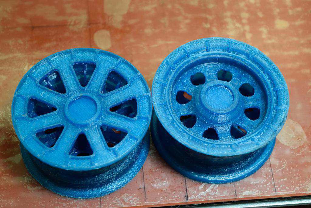

Two wheels printed. I need to improve my technique for joining the two halves together.
 ![DSC_2517.jpg](https://us1.discourse-cdn.com/flex020/uploads/lulzbot/original/2X/c/c6e4a1d4591e6a8836ac9e7fd28fa33e17dc5d72.jpeg)
Using Simplify3D helped to really speed up the prints. They are half the time as my Cura prints due to being able to print the lower layers at a larger layer size.
Cheers,
Scott
