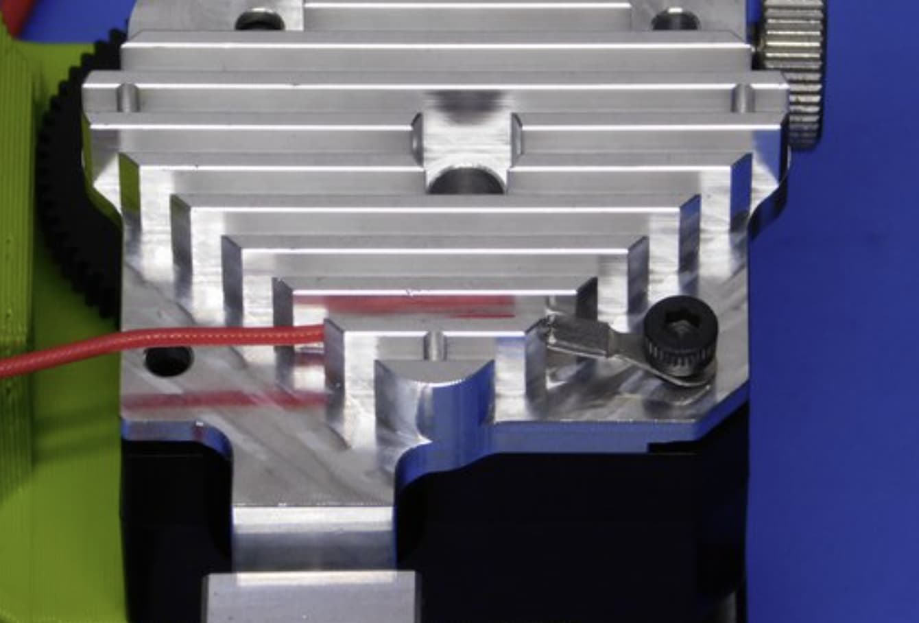

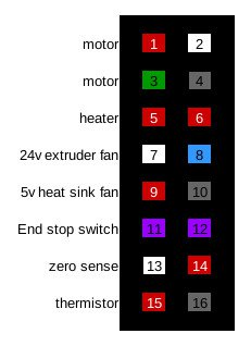

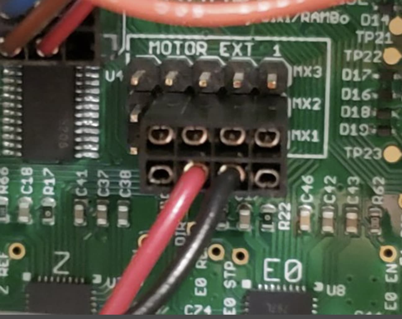

**Post date:** [April 17, 2023, 12:16pm UTC](https://forum.lulzbot.com/t/probing-failed-printer-halted-please-reset/25567/14 "2023-04-17T12:16:20Z")
Firmware is 2.0.9.0.13 is the Universal Firmware which supports multiple tool heads. You have to select your tool head from the LCD menu. Have you done that?
**Post date:** [April 17, 2023, 6:30pm UTC](https://forum.lulzbot.com/t/probing-failed-printer-halted-please-reset/25567/15 "2023-04-17T18:30:54Z")
Ok, so did a little experimenting with my Taz 6.
Two things I tried cause the observed behavior of press Z button successfully, followed by wiping of the nozzle.
1: Button press happened too early, a malfunctioning button can cause this, but when this happens, the nozzle never reaches the button.
2: The nozzle is reading connectivity to ground immediately when it starts probing the first point.
You’ve got #2.
The probe wires on the Taz 6 connect to the board here, at MX1.
 ![image](https://us1.discourse-cdn.com/flex020/uploads/lulzbot/original/2X/6/69e520fb31eca91bd2e8d1c09584940294e24de7.jpeg)
The red wire goes to the nozzle. The black wire connects the bed washers to ground, but any time the red wire is connected to the ground, it is the same as if it had touched a washer.
Since it’s clear your nozzle never touches the washer, the red wire going to it is shorting to ground at some point. The video shows that repairs have been done to the tool head, so that’s where I would start.
With the machine off, unplug the tool head harness. Do a quick continuity test between the probe wire (zero sense) going to the control board and the chassis ground inside the control box to see if there’s a short on that side.
![image](https://us1.discourse-cdn.com/flex020/uploads/lulzbot/original/2X/0/018a03958280084cb78e5f2707996578a6544e07.png)
More likely it’s going to be in the toolhead, and you just need to examine the wiring to find where that zero sense wire is frayed, broken, or otherwise connecting with another wire. I think the most likely spot would be with a fan ground somewhere, but could also be from the end stop switch. Just put your continuity tester on the zero sense wire and poke at each of the other pins on the harness until you find where it’s been shorted to.
If you can’t find a problem in there at all, you can disconnect the zero sense plug from the control board, and WITH YOUR FINGER ON THE POWER SWITCH, initiate the bed leveling process. Without that plug connected it would continue to keep going down even after touching the washer, but you don’t want it to go that far. You’re just verifying that it actually tries to probe instead of instantly going for a wipe. If, with that plug removed from the MX1 pins, it immediately goes for a wipe again, the problem is with the board.
