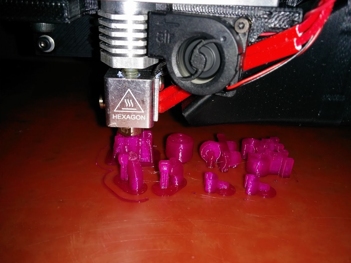

Hello. I have a TAZ5, and after a lot of printings I´m still having a lot of stringing issues. Please, take a look at the attached pictures. I´m printing at 205/60º (recommended setup). The filament makes some tiny bubbles when it comes out (like it is too hot), but the final piece also has gaps between lines (like it was too cold…?). I don´t get it. I used ESUN and FORMFUTURA, both PLA, with similar results. It´s a pain to take off so many strings… they are tiny, but in a high number so they end up being quite strong.
 ![IMG_20151204_233420.jpg](https://us1.discourse-cdn.com/flex020/uploads/lulzbot/original/2X/3/35bae1b5f8c2e5ff076bb83da55cefd010cfb438.jpeg)
 ![IMG_20151204_232027.jpg](https://us1.discourse-cdn.com/flex020/uploads/lulzbot/original/2X/e/e73d7fbcdeda3ecada1df6d899494c63088d98b0.jpeg)
 ![IMG_20151205_000850.jpg](https://us1.discourse-cdn.com/flex020/uploads/lulzbot/original/2X/2/2a08696842b217f42f226fc61d8c0943091671e0.jpeg)
Please, I´d like to get some advice to put me in the right way.

Stringing usually is related to inadequate retraction. It can be temperature as well, but I would try playing with your retraction settings first. You also might be overextruding slightly.

Thanks, Piercet. I read that retraction can help prevent stringing, but I´ve already enabled it. Maybe is one of its sub-settings.
 ![Captura.PNG](https://us1.discourse-cdn.com/flex020/uploads/lulzbot/original/2X/a/ae1188817883c0d7c8b75a285e823c5df7dc4114.png)
This is a video of these settings in action:
For me, it seems to be already retracting a lot! But I still have those strings everywhere…

**Post date:** [December 5, 2015, 6:08am UTC](https://forum.lulzbot.com/t/problems-with-pla/2568/6 "2015-12-05T06:08:19Z")
The way I understand it, combing reduces visible stringing basically by running the strings along the walls instead out from them. I’ve been printing with PETG lately which likes string more than cats, and I’ve been getting good results with combing – not as good as ABS but good enough. I’ve also been printing a little slower (30 mm/s), I have my retraction set to 1.5 mm which is a little more than you have it set at, and I blast the cooling fan when the ambient temperature around my printer is in the high 40s or higher (low 40s and high 30s, no need for fan). This is on a Mini BTW.
Anyway, there is an intermediate combing which does not do combing on the top or bottom layer – “no skin” – maybe give that a try to avoid a scar on top, and avoid strings in the middle.
205 is the default for PLA. I honestly don’t use much PLA specifically, so I don’t really have suggestions about the temperature – I’d say experiment with that variable too. Just don’t change too many variables at once otherwise you won’t know which one makes a difference.

What’s you fan and retraction speed setting. I’m using the same setup (TAZ 5,esun,temperature ) and noticed that stringing gets worse if the fan is running high.
A high retraction speed will also reduce stringing. But be careful, with the taz default extruder acceleration you might get missing steps so reduce it.
Finally, prints like your example with lots of small parts are more likely to string than bigger ones. What layer height are you using? I have also some minor stringing when I do small parts at 0.1,no problem with 0.2. I’m working on it. .
My nearly perfect retract setting is:
1mm retreat
55mm/s retract speed at 2400 acceleration (big improvement about stock! )
8mm/s unretract speed to avoid blobs due to "air ram"effect.
But you can do that only with fw retraction. . You still might get better prints with retract speed about 45…

Not a problem! When adjusting settings within Cura, only adjust one at a time. They will have some effect on the outcome, and changing multiples at a time will not help determine which setting has which affect. Let’s limit future tests to your Esun PLA, as different manufacturers will have different ideal temps and settings. From your screenshots I see a couple of items-
3mm filament diameter is not a true filament diameter. Most companies shoot for a 2.85mm diameter (including esun.) This will make your printer think it is putting out more filament than it actually is. This will cause under extrusion, affecting adhesion and increasing strings.
The 80mm/s speed will be the default if you have no speeds set in your advanced tab. Any speeds set in the advanced tab will override this for that section of the print. You will want to fine tune the perimeter speeds to make an affect on those strings.
Zhop I like to leave this set to 0.1mm with a single headed extruder. This setting becomes a little more important once you switch to dual extrusion.
Retraction speed and distance is going to be where you see the greatest improvement. Your retraction is actually pretty light, looks to be about 1mm. Try bumping this up to 3-5mm along with a retraction speed at 30mm/s.
A cooler temperature will help with strings. The hotter the filaments are, the more viscous they become. This allows dripping, which is the cause of strings. The risk you take with lowering the temperature is a reduced layer bond, which can cause some layer separation/weakness issues.
Any chance you can switch to quickprint mode with Esun PLA selected (205/60) and nab a photo of the results? It is a little easier to give suggestions when starting from a known base point.

I’m no native speaker, maybe thats the reson why I’m not realy able to understand your first sentence meaning. What I meant with “perfect settings” is: I can print without stringing and oozing with them, PLA and also PETG. But they might be different for you, for example if you print a lot faster then I do.
Yes, it seems as you are mixing up z-hop and retract. I would leave z-hop alone in the first steps, it might be useful but it can also introduce new problems. I wouldn’t enable it as long as there are other options to eleminate your problems. So if I’m speaking about 1mm retract, I mean how much filament is retracted upwars, not Z-hop.
You will not be able to find my settings in Cura, as I use FW (Firmware) Retraction which gives you a lot more options. You need to enable that in Marlin if you want to use it, and also switch to another slicer as Cura don’t support it at the moment. What you can change nevertheless is the retraction acceleration. But not in Cura, it’s in the LCD menu of your printers settings.
OK lets go through some of your questions:
Print speed:
80mm is a real high value. It can be achieved, but you realy shound’t start with at as long as you have not dialed in all your settings to be nearly perfect. As Brent said before, thats also only the default speed which is modified from the values in Advanced Tab. Start with the settings from Lulzbot PLA profiles and leave it alone until your prints are perfect. Then you might want to increase them.
One of the problems with high speed printing is the increasing nozzle pressure, which will increase also oozing and stringing problems.
The mountain print in your example will have no problems with stringing because of it’s completely different nature. There are much less travel moves, and each travel move happens after a decent print time, while in the parts with stringing you have very small print times and again travel moves after them. It’s important that you understand the mecanism behind that before you start to modify your settings or you will never know why a change improved your print quality and another one doesn’t!
Z-Hop:
I meantioned this before, my recommendation is to disable it for every print where it is not absolutely necessary.
Nozzle Temperature:
The right temperature is also depending on your print speed. If you want to print at 80mm/s, you need more temperature to reduce nozzle pressure and a clean filament flow as if you a printing, say, around 40mm/s. As a start point, 205° at about 40-50mm/s for eSun PLA is quite good.
Cooling: As low as possible, as high as needed. More cooling means weaker layer bonding and sometimes also more stringing.

Returning to the default PLA profile values seems to fix the stringing… The few strings that appear (barely 10) are easy to remove. I guess I touched too many things on the way, my fault. One step back, but is not bad sometimes. Thanks for the valuable information!
