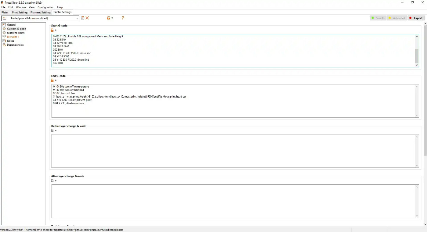

I am a school teacher new to 3D printing but have been doing a lot lately. We have several Mini’s an Mini 2’s to use. Could you send a screenshot of what this code looks like in Prusa Slicer for PLA (for example)? I am currently using CURA LE but would love to try Prusa as well
Thank you
**Post date:** [March 23, 2023, 8:10pm UTC](https://forum.lulzbot.com/t/prusaslicer-2-5-0-startup-gcode-for-varying-material-types/25055/5 "2023-03-23T20:10:27Z")
The code is all on the original post, you will just open up the printer settings → custom gcode section and look for the M109 commands in the startup gcode section.
Swap them out for the more complex code, and that’s all.
This screenshot is from an older version, but it shows you where you’re going for the edits. You may have to be in “expert” settings mode to see it.
