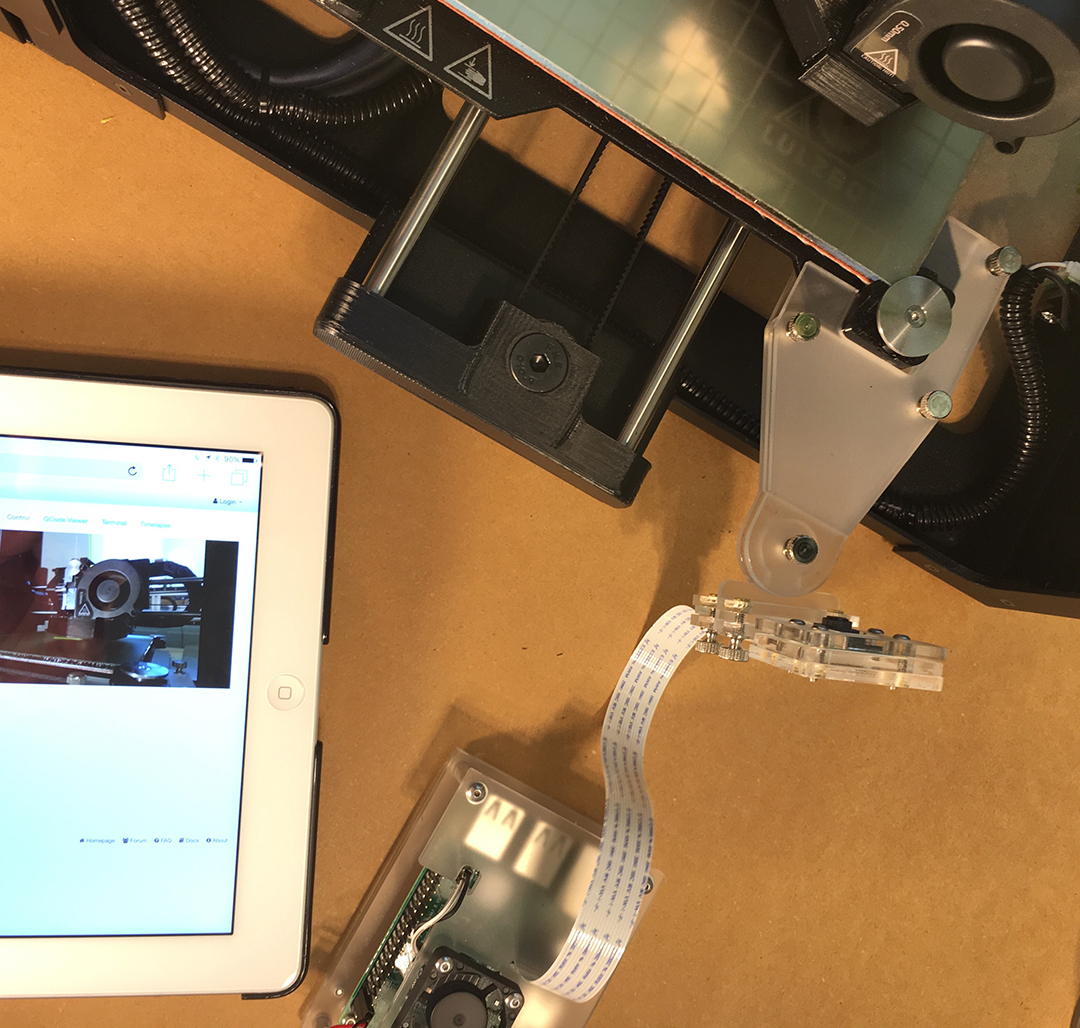

**Post date:** [July 11, 2018, 6:00pm UTC](https://forum.lulzbot.com/t/raspberry-pi-camera-print-monitor-setup/6019/7 "2018-07-11T18:00:01Z")
All Go here. Still running CURA direct from PC. Guess I need to research the issues mentioned with Windows10. Not understanding how that will be revealed in poor prints. Thanks for suggesting I Octopi!

**Post date:** [July 12, 2018, 5:16pm UTC](https://forum.lulzbot.com/t/raspberry-pi-camera-print-monitor-setup/6019/10 "2018-07-12T17:16:58Z")
The Raspberry Pi normally boots from a microSD (or SD) card. This card is also the / (root) partition. OctoPi is configured with a single user, Pi, and a default password which you will need to change.
OctoPrint is a collection of processes that run under the Pi user. Interaction with OctoPrint is primarily through a browser usually on another machine connected to the server running on the RPi. On the home page there are three sub-frames on the left side, Connection, State, and Files. At the bottom of the Files sub-frame is an Upload button. This is how files get loaded.
Connect to your print using the Connection sub-frame. Select the file you want to print and using either the little icons with each file or the Print, Pause, Cancel buttons at the bottom of the State sub-frame is how you start printing.
The right side of the home page has tabs at the top and mostly control and/or monitor the operation of the printer.
There are many plugins available for OctoPrint to enhance or replace the interface. You can also use SSH to connect to OctoPi and do “Linux” things. Login as the user Pi and the folders used by OctoPrint are available.
The SD card on the Mini is a separate device and is not normally used. While OctoPrint has a button to upload to the SD card, it goes through the USB serial interface and is very slow. What might be on the printer’s SD card are calibration or setup type gcode files that almost never change.
