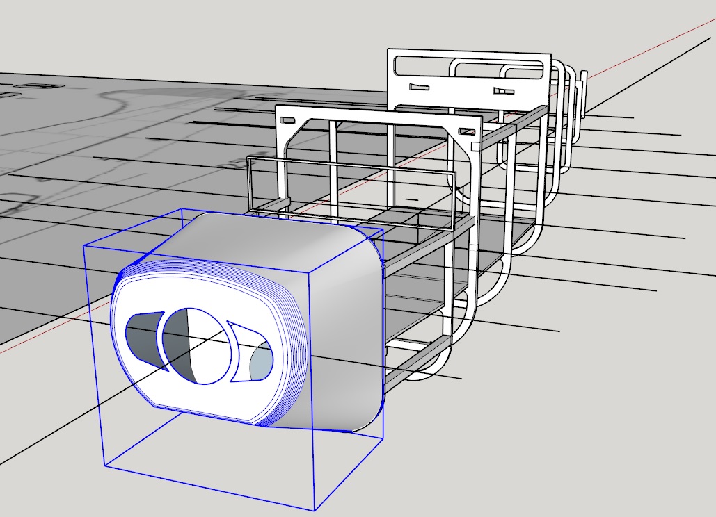

Well, I am STILL drawing on the body but I got the nose/cowling printed out this weekend! I think I will be ready to do some _serious_ printing on the body next weekend!
You know, this thing is really coming out big. The wing is 6 foot. This cowling is huge! A smart person would have started small and worked their way up. {sigh}
 ![cowling.jpg](https://us1.discourse-cdn.com/flex020/uploads/lulzbot/original/2X/0/022afc27af38c94b029d36e9d5b864a558522a5e.jpeg)
Getting close to some serious printing on the body…

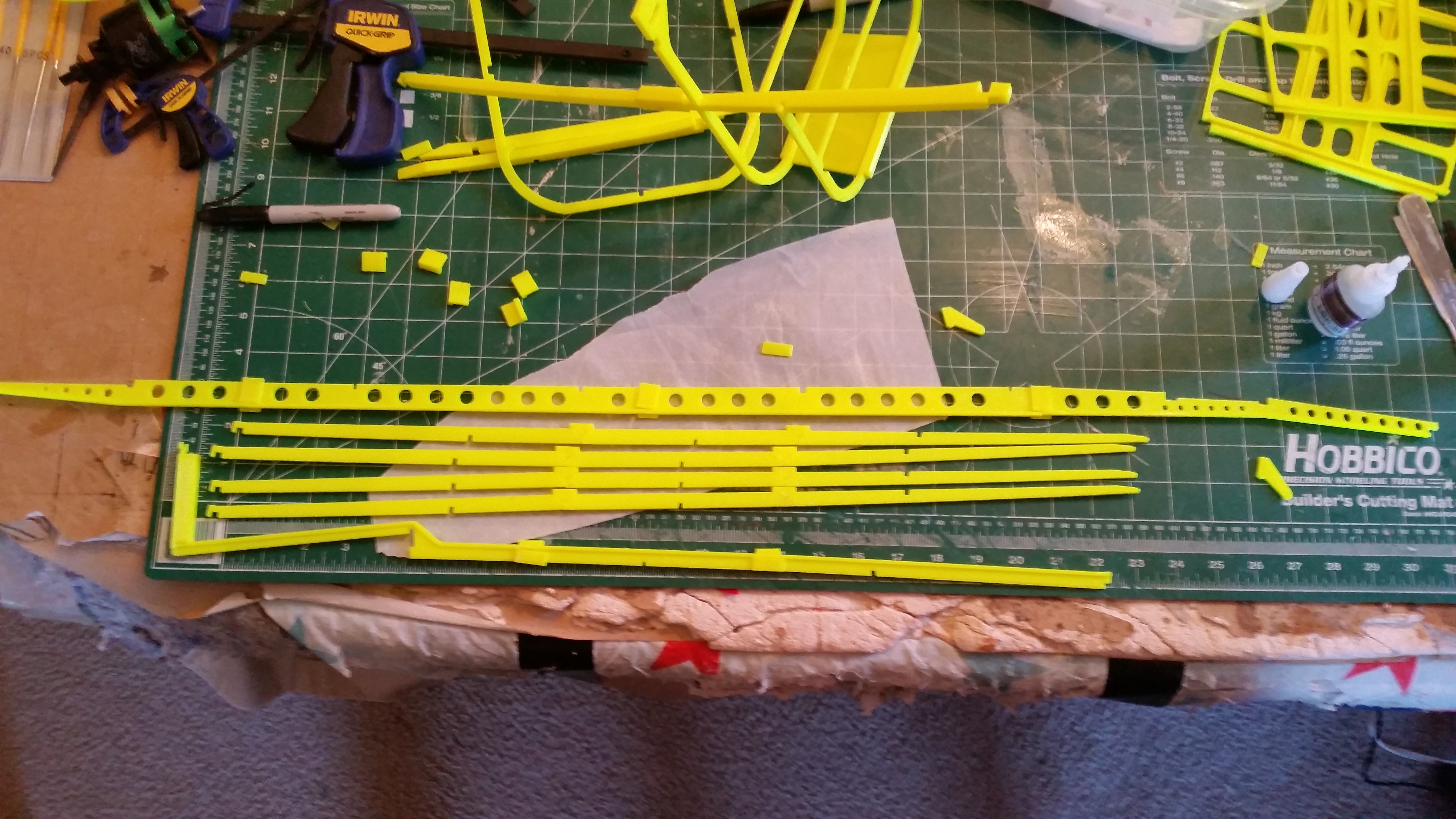

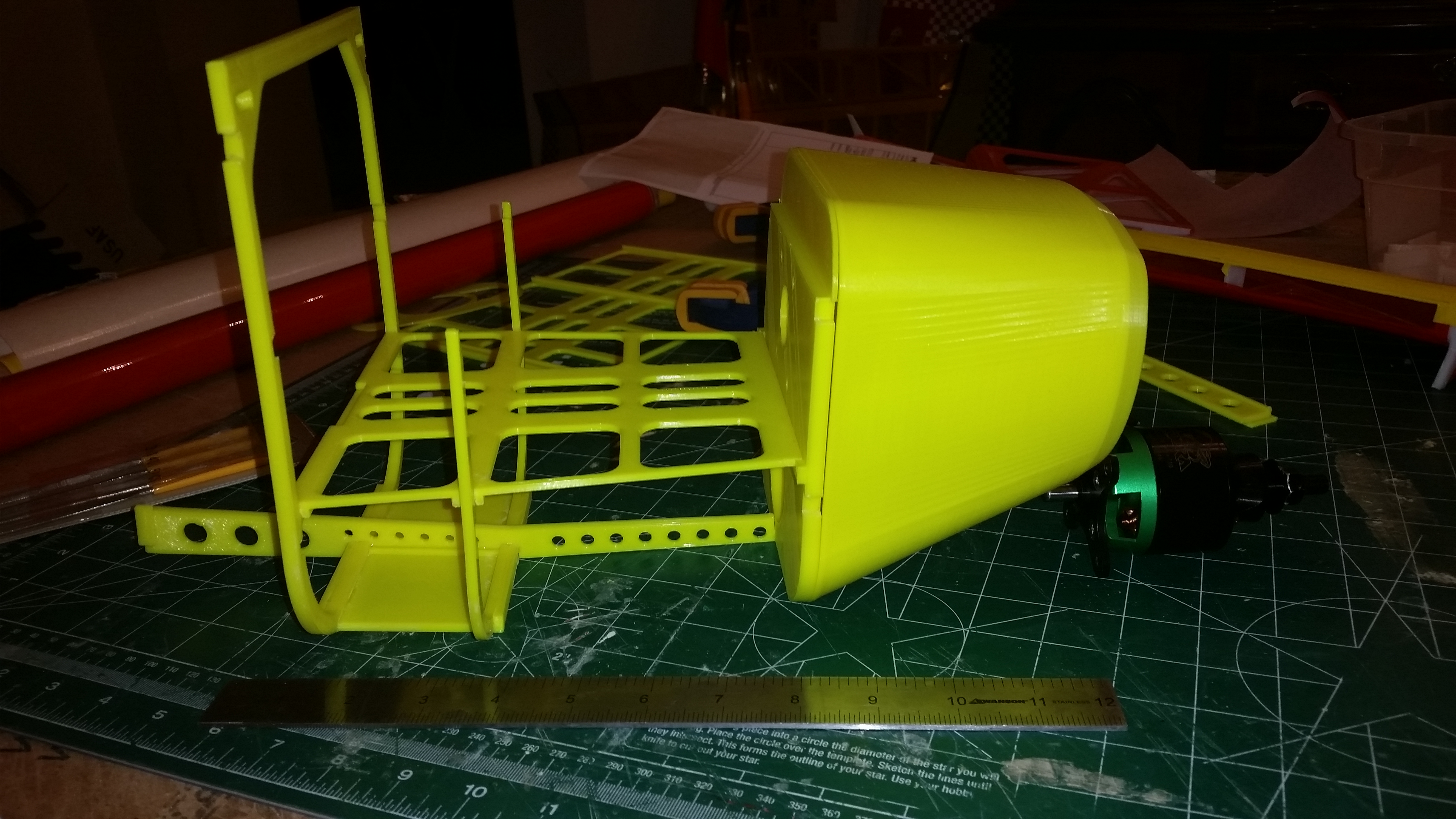

Well I got drawing the body of the plane close enough I went ahead and started printing. The printer ran nearly 24 hour days for several days and I have a lot to go yet
On a side note, with all the things I have learned here on the forums about accuracy (proper filament diameter in Cura, z-offset and e-steps) I have gotten much better accuracy. In fact, even with cheap filament I have nailed down that .3 mm per side seems to be the perfect clearance so parts snap together with minimal sanding/trimming! So if tab A is 3 mm I will make the slot B 3.6 MM and 98% of the time they will snap right together! (that is not a percentage though. .3 each side whether it is 2mm or 20mm)
Ok shut up Rob and show us some pictures… Here is a small stack of parts I printed this weekend.
 ![20170129_114625.jpg](https://us1.discourse-cdn.com/flex020/uploads/lulzbot/original/2X/6/6a3ae3b8059acabd064c5df320c41bd13bef7d71.jpeg)
 ![20170129_204803.jpg](https://us1.discourse-cdn.com/flex020/uploads/lulzbot/original/2X/6/605b469edd35883691119f6aeebfe1f837e09ee8.jpeg)
I started assembling and again, I was thrilled with fits tight enough to ‘click’ into place. There is no glue on these parts yet!
 ![20170129_145225.jpg](https://us1.discourse-cdn.com/flex020/uploads/lulzbot/original/2X/5/55fd4651160e8b6ef66438e88d041e718e4ad622.jpeg)

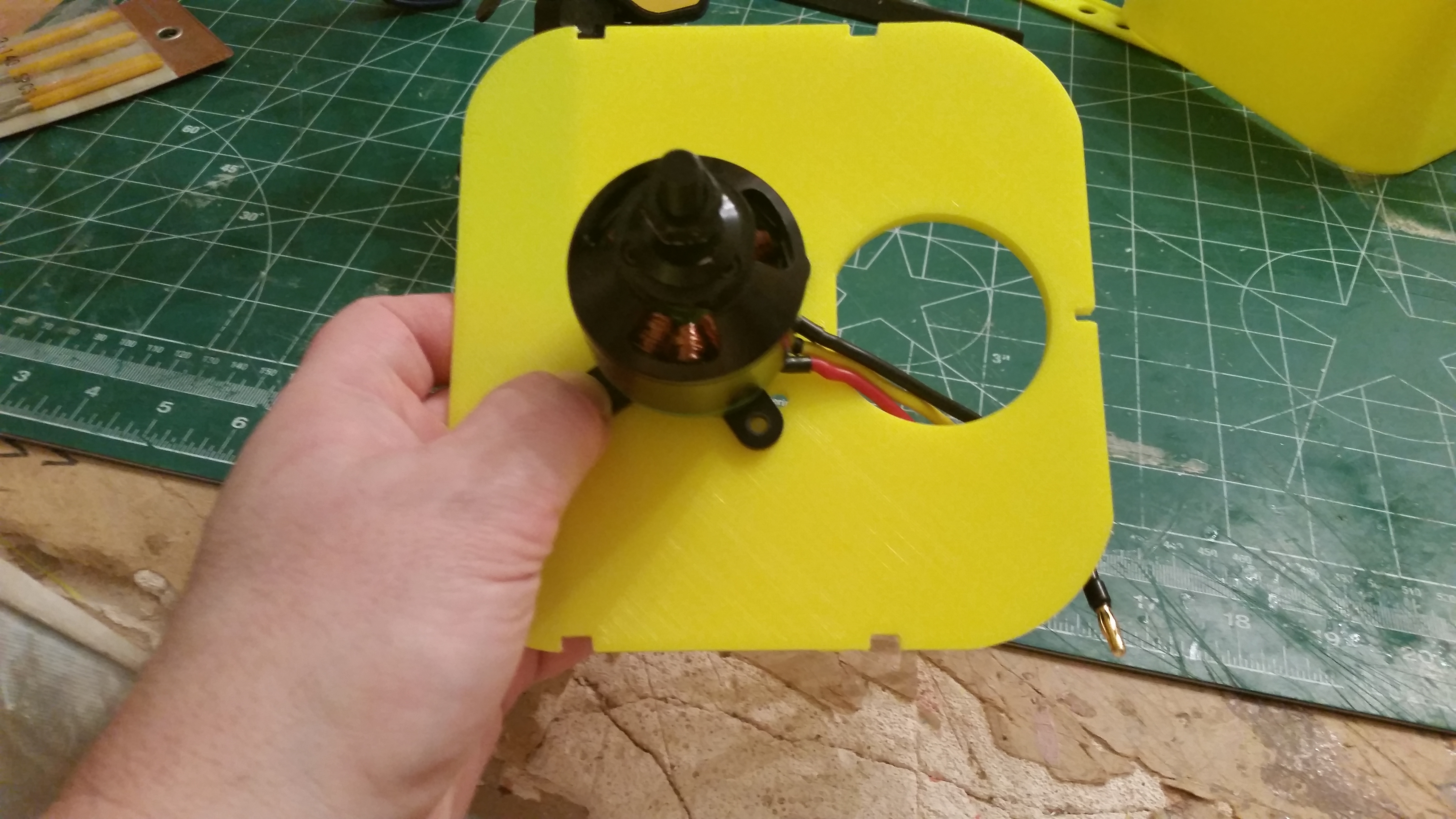

Check out this firewall and motor. I can’t believe how big I let this plane get on me!
 ![20170129_211621.jpg](https://us1.discourse-cdn.com/flex020/uploads/lulzbot/original/2X/4/42553204e0e9ced707f731f926449f0d7decd8ef.jpeg)
Coming together, note the 1 foot ruler in the fore ground! 😉
 ![20170129_211957.jpg](https://us1.discourse-cdn.com/flex020/uploads/lulzbot/original/2X/b/b03b2811aaa7a686fe184666cda2ae8e4537064e.jpeg)

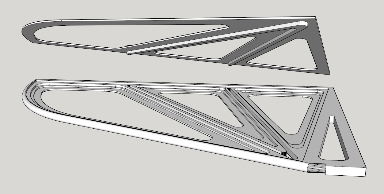

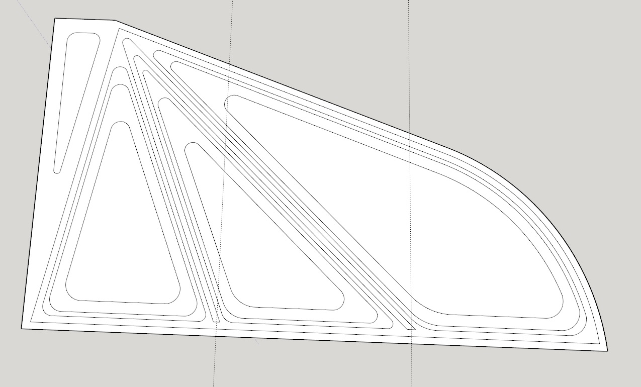

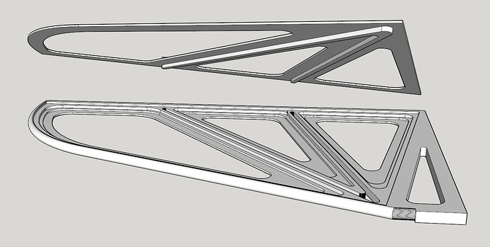

Kinda proud of this one! This is the back wing of the plane.
I probably over designed it while going for the light but stiff thing. I made myself a little dizzy with all the lines… 🙂
 ![MCEscher.jpg](https://us1.discourse-cdn.com/flex020/uploads/lulzbot/original/2X/7/72e21582ad081aea7c8022d250412407da508875.jpeg)
But I got it!
 ![MCEscher-2.jpg](https://us1.discourse-cdn.com/flex020/uploads/lulzbot/original/2X/2/28f321606bf3e42978539de49e3e083152abba93.jpeg)
Then I made a “lid” for it so it was easy to print without overhangs.
 ![elev_open_skin.jpg](https://us1.discourse-cdn.com/flex020/uploads/lulzbot/original/2X/9/9ee6d5d14607ba1ab143b807d52094de952ed104.jpeg)
So I got it printed out and I will be darned! I finally have tolerances nailed! Check out this fit!

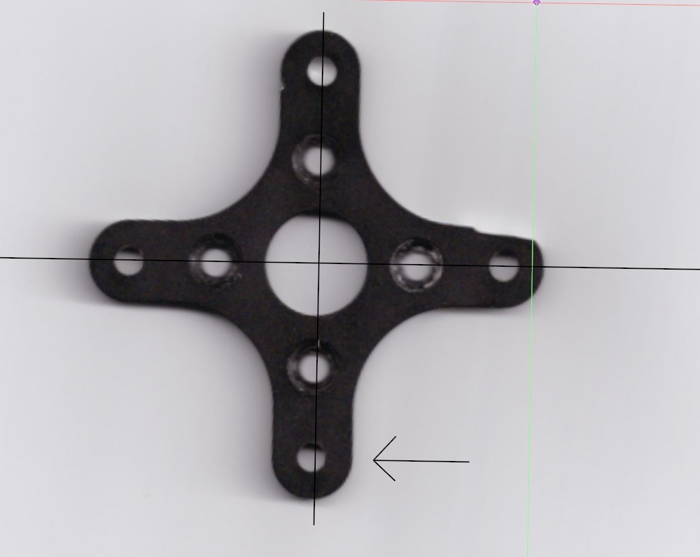

Well, well, well!
For years I have made my airplanes out of balsa wood and hand drilled the motor mount holes. I have ALWAYS had a problem getting the 4th screw/bolt in! I ALWAYS assumed it was my sloppy hole drilling! This time I used the protractor to draw it to make sure my holes were perfect! then printed the part so I should have precision right?
The 4th screw STILL did not want to go in!
So back to the drawing the board! I scanned the motor mount into the SketchUp (CAD) and lookee…
 ![motor_mount_holes.jpg](https://us1.discourse-cdn.com/flex020/uploads/lulzbot/original/2X/9/9d92c4eb79466f1de136dfca1d5c4a0ceddca561.jpeg)
So what do you know? It was not ME all this time!

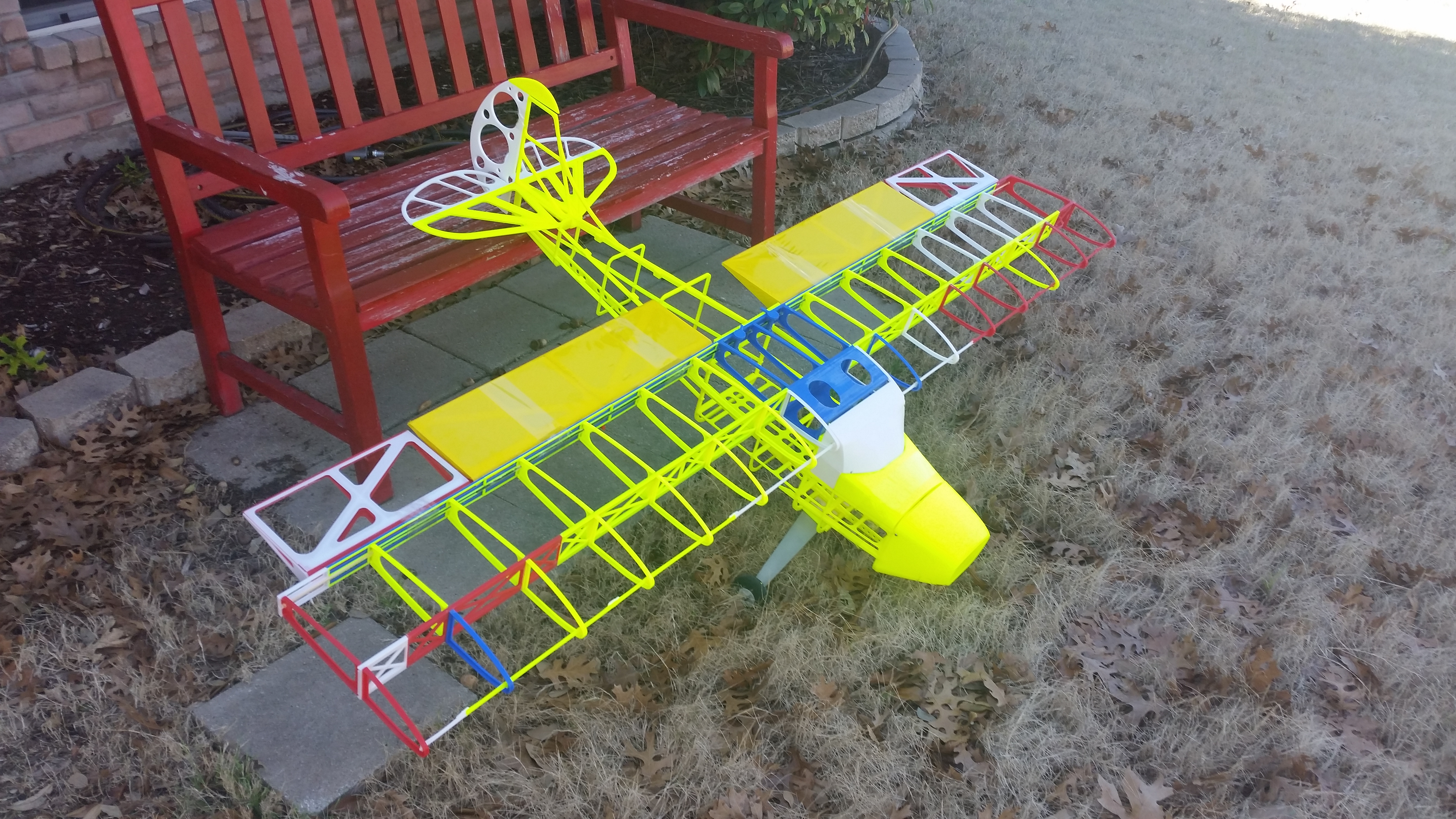

### Author: ![robajohn](https://avatars.discourse-cdn.com/v4/letter/r/5f9b8f/32.png) [@robajohn](https://forum.lulzbot.com/u/robajohn)
#### Post date: [April 15, 2017, 3:23pm UTC](https://forum.lulzbot.com/t/rc-airplane-project/4328/38 "2017-04-15T15:23:52Z")

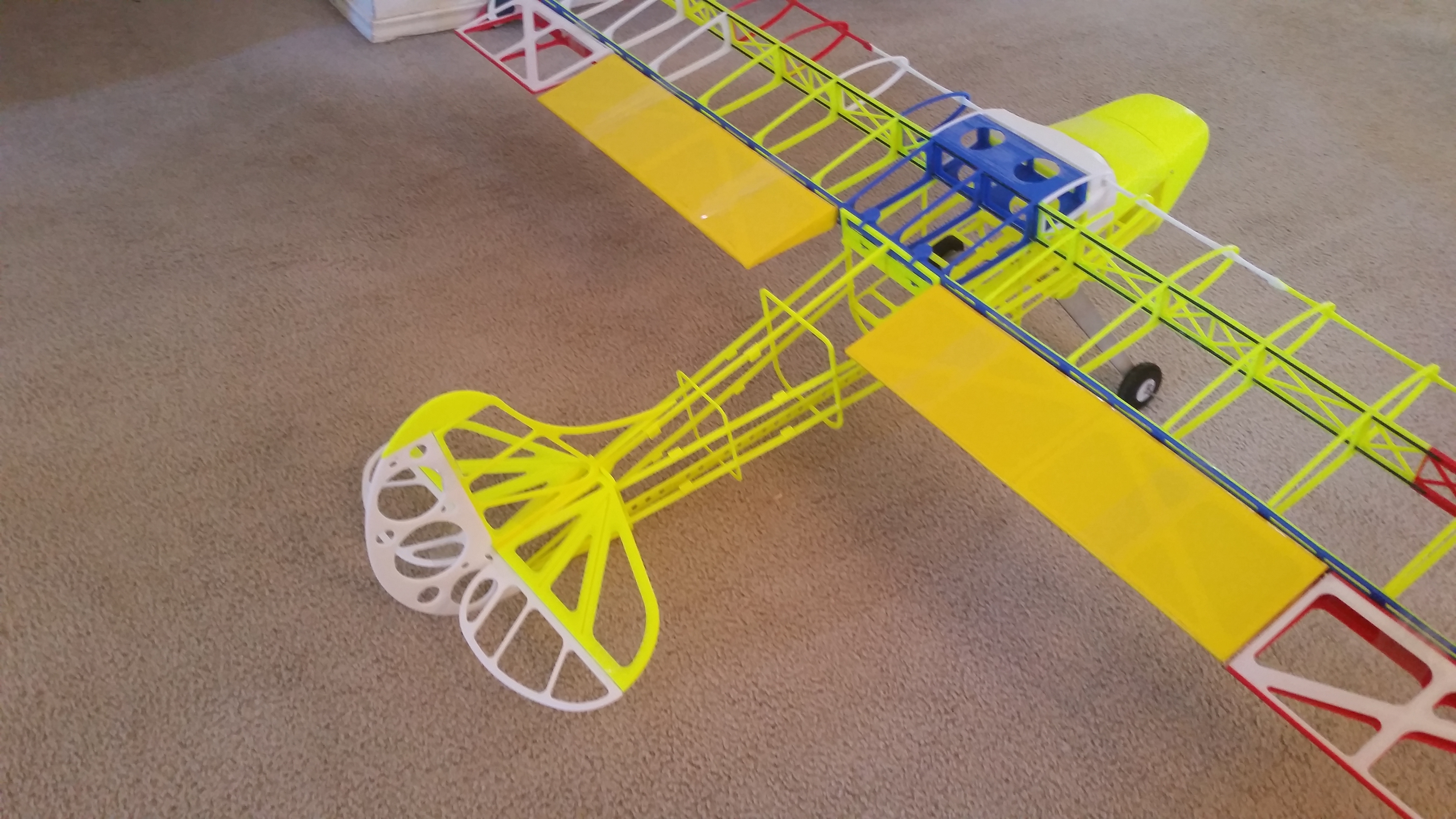

I hate dead/incomplete threads! So I can’t believe I have left this thread hanging since OCTOBER! OY! Bad Rob, BAD!
So I finished the assembly, gosh, In February! Here is a shot all assembled before covering.
I will post some covered, COMPLETED shots today.
I still have not flown it yet as spring weather has been very uncooperative- so far every weekend this year has been either rain or high winds!
Either way, this is a dead end project for me. I was using SketchUp which is a GREAT product but things like 3 dimensional compound curves that want to be a printable solid it was just _very_ cumbersome and difficult to make it do what I wanted it to do. The windshield totally kicked my butt in SketchUp and that was when I knew I was done with SU.
That is one of the reasons I went for a covered frame on this plane.
So I have switched to Fusion 360 and I am liking it VERY much. Now SketchUp was great in that it was very intuitive and extremely easy to learn. Fusion 360 is much more, uh, complex, and the learning curve is MUCH steeper. However, with complexity comes POWER! BWUH HA HA HA! Anyway, I will close this thread out when it flies
Just wait until you see the project I finishing up now in Fusion 360! You know, the project that totally distracted me from this project! SQUIRREL!
