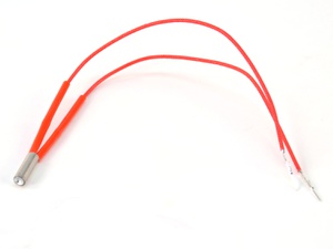

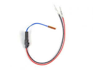

Could the “sizzling” actually be “grinding” noises? When filament “sizzles” you can usually see tiny bits of steam exiting the nozzle and also the texture of the filament will often be rough with signs of bubbles in it.
Thermal run-away is triggered when the board knows it’s been calling for heat for too long … and yet the thermistor says the nozzle isn’t actually hot. Logic on the board recognizes that it shouldn’t be possible to be heating the hot-end for that amount of time and _still_ not have reached operating temperature. The error shuts down heat to the hot-end so that it doesn’t result in a fire. (A real thing with printers that lacked thermal-runaway detection.)
This can be one of two things… the thermistor is correct and the nozzle isn’t heating (so not a real run-away but the head still needs service) _or_ the heater cartridge in the hot-end is working fine … but the thermistor needs to be replaced (so the head is actually much hotter than the thermistor reports).
If the hot-end is not reaching the correct temperature then it may be struggling to force filament through that isn’t quite warm enough … and that could result in grinding. I’ve never seen filament get so hot that it boils unless it has water inside.
The heat-block has a heater cartridge inserted into it (a cylinder slide into it with two thicker wires come out the side … be careful not to bend them. They are usually solid-core wire – not braid. Excessive bending can brake a wire. The thermistor is also a cylinder slide into the side of the heat block – but this one is a little smaller.
Check with LulzBot and they should be able to give you the correct part numbers for these. It might be these:
