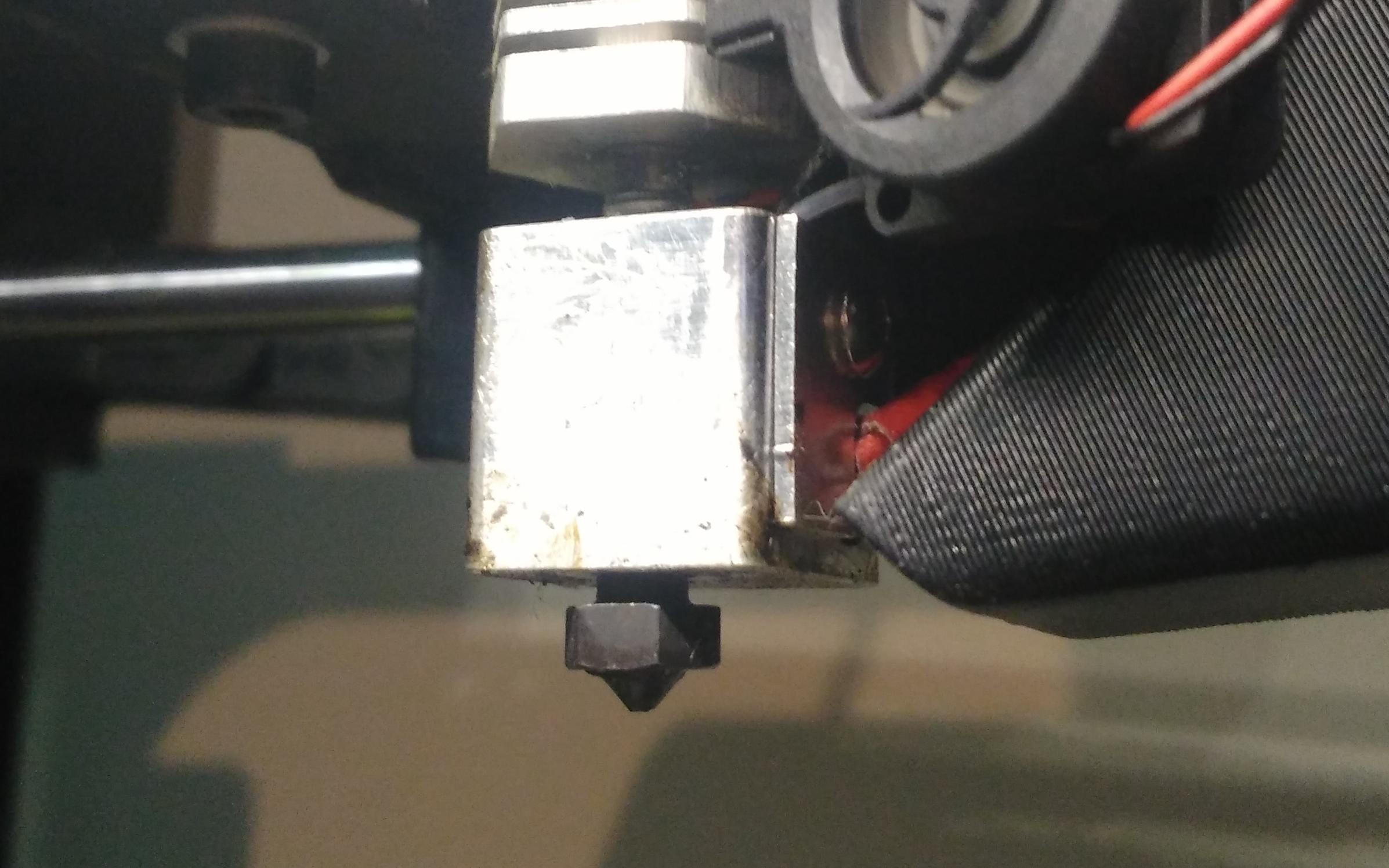

And there it is. A bit stressful I must say to touch these delicate parts but I think I managed without breaking anything.
 ![IMG_20170120_111209.jpg](https://us1.discourse-cdn.com/flex020/uploads/lulzbot/original/2X/2/237cb6124ef83a60ed7cbca74bc9b0bda7101ff2.jpeg)
The procedure to adjust Z Home offset is
```nohighlight
M28 Z // Home Z without Bed offset
M206 // Check Z Home (should be 159 for unmodified Mini)
M206 Z-1.0 // Add 1.0mm to the nozzle size (you tell Mini: you're at 158.0 now)
M500 // Save settings in EEPROM
Now, with stock Lulzbot Cura start gcode the nozzle dives comfortable depth into wiper, even after powercycle.
_update_: Hmm… something fishy is going on. The firmware wipe (on failed washer probe) is deeper than the start gcode one. Back to the drawing board.

First: “M28” Z should be “ **G28 Z** ”!!
That’s exactly what I did, but you should be careful and do a manual home and probe for all axis afterwards ( **G28** , **G29** ) and then do a “ **G1 X15 Y15 Z10** ”. This will bring the nozzle to 1cm above the front left corner of the bed. Then, step-by-step lower the nozzle by going down on Z, using “G1 Z8”, “G1 Z4”, “G1 Z2”, and watch the nozzle distance to the bed. “G1 Z0” should exactly kiss the bed, Z2 or Z1 should give you a good idea about that. If that’s not the case, you should adjust Z Home offset so that Z0 kisses the bed.
