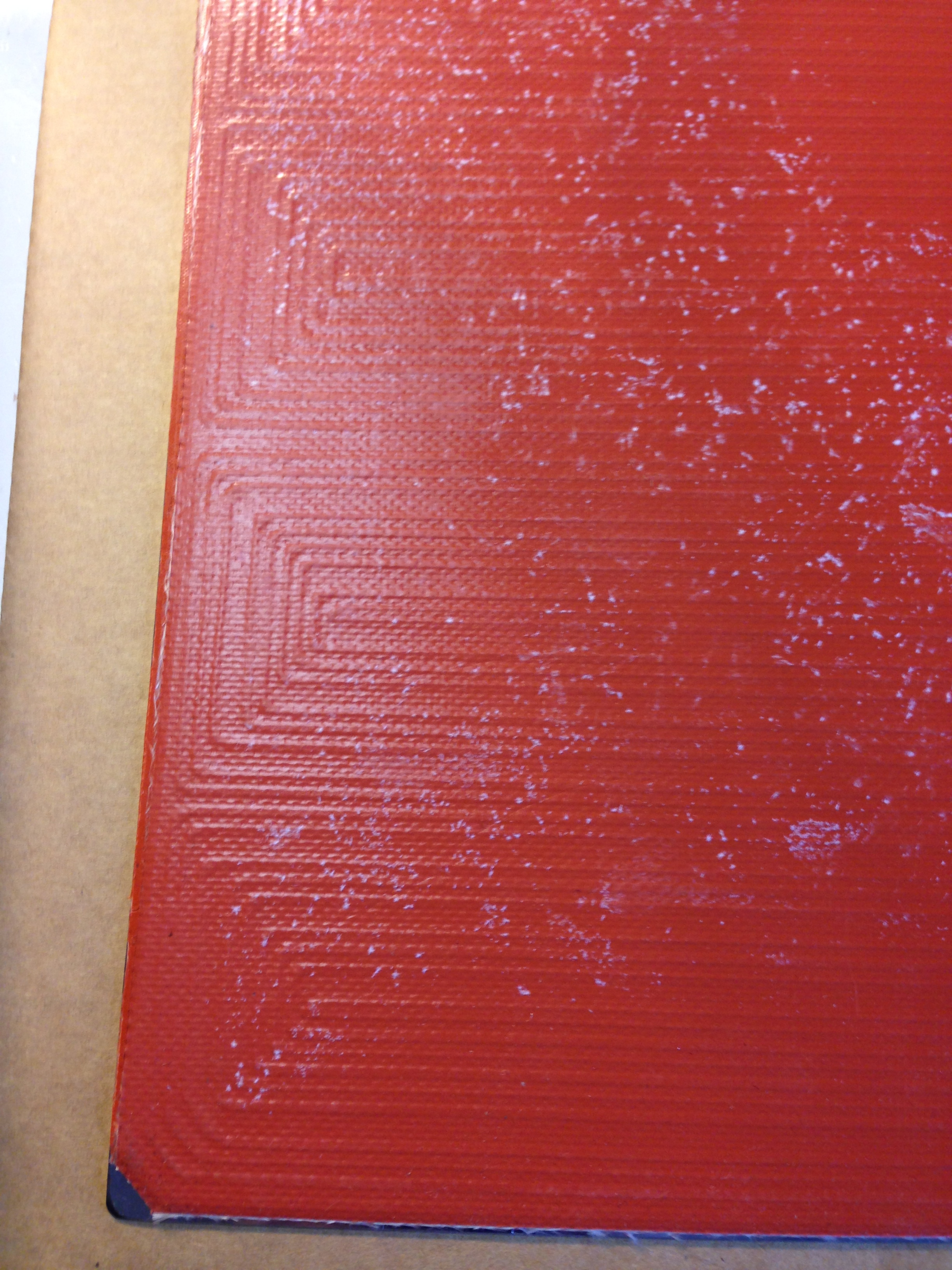

**Heat Mat**
One thing that Lulzbot didn’t mention is they have changed the heat mat for this Modular bed system, or have at least used a different heat mat from the original one that came with my Taz 4. On this new heat mat, the resistive elements are thinner but are more evenly spaced across the bed, as shown in the pictures below.
 ![IMG_3330[1].JPG](https://us1.discourse-cdn.com/flex020/uploads/lulzbot/original/2X/4/49fbfcec2f0708bce413f3dc1973eda86498693b.jpeg)
New Heat Mat
 ![IMG_3332[1].JPG](https://us1.discourse-cdn.com/flex020/uploads/lulzbot/original/2X/e/e6a32636b78d61ddad7a43da601d4387188f735f.jpeg)
Old Heat Mat

**Post date:** [January 5, 2018, 9:02pm UTC](https://forum.lulzbot.com/t/review-of-lulzbot-modular-print-bed-heater/5477/2 "2018-01-05T21:02:58Z")
Interesting, especially the new heater bit. I’ll have to see if I can get a raw unadhered one to put on a plate and shoot it with my thermal camera side by side. Thank you for the review!
