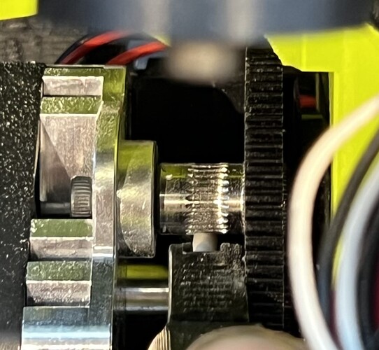

I’ve got a SE 0.5mm that’s been going through full rolls of PLA for days at a time (about 56 hrs per roll, for about 3 weeks now). Heat creep with PLA isn’t an inherent issue with the Titan Aero.
What is a common-enough issue with them, however, is defects that cause misaligned teeth. The drive teeth are not in alignment with the filament path just enough that they’re constantly pinching the filament where they generate dust that clogs the teeth, increasing the chance of stripping the filament.
![image](https://us1.discourse-cdn.com/flex020/uploads/lulzbot/original/2X/7/71c2de2537866e9d65c9b3063f14999ea22de7aa.jpeg)
This misalignment can be caused by excess pressure, or just a bad cut.

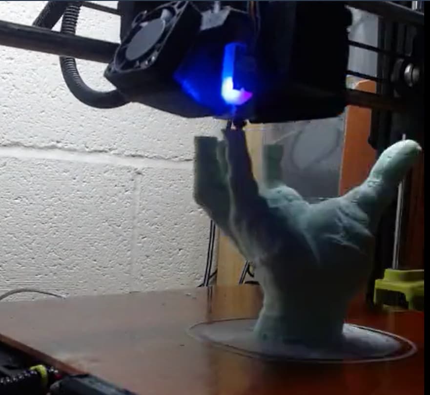

Drop a small washer in the hole to shift the teeth over, order new gears, or, like I did, just say goodbye to single-gear extruders if possible. If you get a good one, it should be fine, but single-gear extruders (at least the small ones - I hear good things about the LGX) are just a weak point.
I actually just mounted a 2.85mm Orbiter on my old Single Extruder in place of the Wade extruder on my personal machine. I still use the Hexagon hot end, but with a CHT-clone nozzle in it. With the BLTouch attached, you’d laugh at the Frankenstein of a monster it appears to be, but I am pushing TPR filament (which makes TPU look like PLA in terms of hardness) through a 1.0mm CHT nozzle at speeds that are equal to what I could do with PLA with a stock Taz 6.
 ![image](https://us1.discourse-cdn.com/flex020/uploads/lulzbot/original/2X/d/dbc10ae4e5d8b3011bdce13d9a1d0ac0b70b5cab.jpeg)
13 hours for this hand in TPR. Once I get the pressure advance set correctly, I’ll be able to speed it up even more.

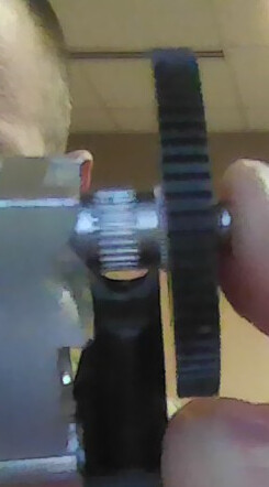

### Author: ![tk4b](https://avatars.discourse-cdn.com/v4/letter/t/f475e1/32.png) [@tk4b](https://forum.lulzbot.com/u/tk4b)
#### Post date: [October 17, 2023, 6:26pm UTC](https://forum.lulzbot.com/t/se-0-5-toolhead-loss-of-extrusion-filament-grinding/26037/8 "2023-10-17T18:26:56Z")
Hi, to clarify, I used the language Lulzbot uses in naming this toolhead: SE 0.5 ([this one](https://lulzbot.com/store/lulzbot-se-tool-head-nickel-plated-copper-0-5-mm-kt-cp0136)). This is a dumb name for this toolhead, because obviously that’s easily confused with the “Single Extruder” toolhead. They should have called it Aerostruder V2 or something, because that’s basically what it is.
I appreciate the comments and input so far, but for a variety of reasons I do not believe I have the hobbed wheel offset issue, although that’s a pretty interesting finding. Here’s what it looks like on one of my 6 printers (hard to see, even harder to get a clear picture):
 ![IMG_0165 (Medium)](https://us1.discourse-cdn.com/flex020/uploads/lulzbot/original/2X/0/0f54684ba9483e7d3d36ed2b426bcd54f372f720.jpeg)
Sounds like the clearest advice so far is what @American_3D_Printing has said: two full rotations of the idler tension adjustment knob.
If anybody else has input on how to not have 50% of prints fail due loss of extrusion from PLA filament grinding, I’m all ears.

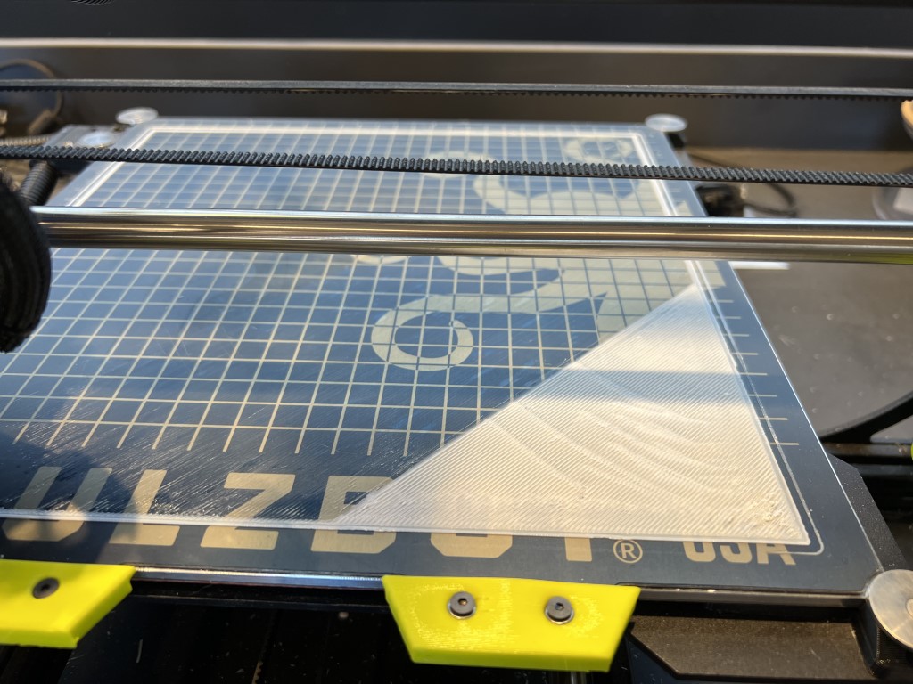

#### Post date: [October 23, 2023, 9:51pm UTC](https://forum.lulzbot.com/t/se-0-5-toolhead-loss-of-extrusion-filament-grinding/26037/20 "2023-10-23T21:51:49Z")
Alright so this is still driving me crazy, perhaps even more so now - just today I’ve had 5 printers grind up the filament within the first couple layers of printing, several of them did not even finish the first layer. All of these failures happened with the tensioning knob turned 2 full rotations as suggested above. I have not yet attempted the oil trick.
I get what you are saying that for optimum performance, tuning profiles is nice. But I’m not even talking optimal, I just want it to print halfway decently and that is not even close to what I’m getting. It’s hard for me to understand how printing PLA at 205C and 30mm/s (standard profile) can really be this disastrous.
And while I know all this makes me sound like a newb, I’ve operated some form of 3D printer for over 10 years and I’ve never had a problem like this. I feel like there is something seriously wrong with the SE 0.5 toolheads and I can’t figure out what it is. If anybody has more suggestions for me here, I’m all ears, but seriously stumped about how the filament grinding can be this bad.
