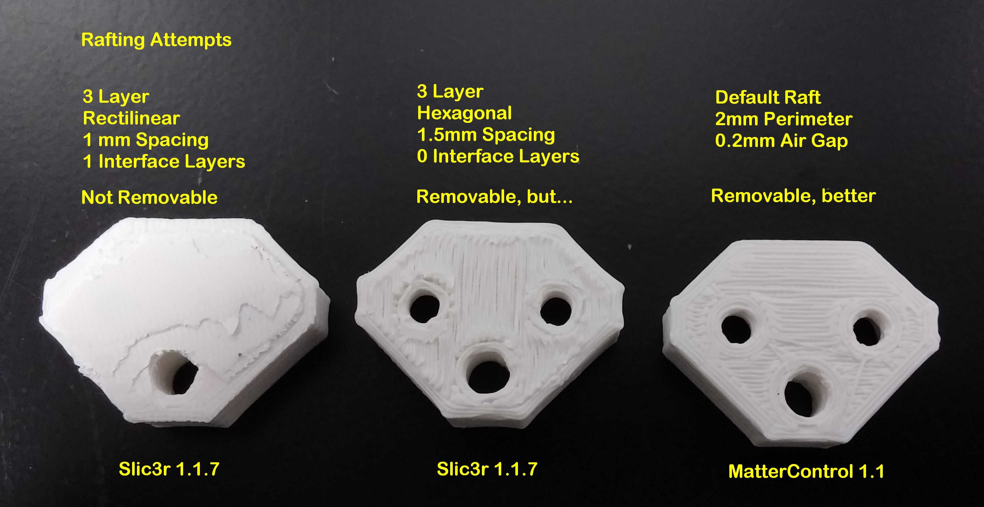

OK, so here are some pics of my raft attempts and my smooshed first several layers. I have been slowly raising my Z stop and this is improving a little, but I am about at the point where the first layer is not adhering to the bed and still seeing this way more than the parts used in constructing the printer. What do I try next?
Thanks for the help.

**Post date:** [October 24, 2014, 6:30pm UTC](https://forum.lulzbot.com/t/slic3r-problems/888/16 "2014-10-24T18:30:25Z")
From those pictures you have a couple things going on. For starters, it almost looks like the plastic you are trying to print is PLA, not ABS. It could just be an unusual color for ABS or the lighting, but you may want to check that what you have matches your printing settings.
Next, I’d be concerned about your belt tension in one of the X or Y axis. the holes there seem to be a bit out of round, which can sometimes indicate a loose belt.
Your next issue seems to be your extruder calibration. It looks a bit to me like you are under extruding slightly. I’d check the diameter of your filliament, and adjust the filliament value inside slic3r accordingly, and then maybe run through some of the extruder calibration routines. [http://www.instructables.com/id/How-to-calibrate-the-Extruder-on-your-3d-Printer/](http://www.instructables.com/id/How-to-calibrate-the-Extruder-on-your-3d-Printer/)

**Post date:** [October 28, 2014, 10:36pm UTC](https://forum.lulzbot.com/t/slic3r-problems/888/17 "2014-10-28T22:36:30Z")
Hmmm… It’s supposed to be White ABS. How do you tell if the label is wrong? Smells like ABS when it’s extruding. I’ve never used PLA, but am told it smells like warm sweet corn.
The belts seem tight. How does one measure them for correct adjustment? I have noticed a significant amount of wobble in my print bed however. It is quite sloppy on the guide rods. I will try some repositioning of the bearing blocks to reduce the wobble and see if that helps.
Thank you for the extruder calibration suggestions. I will try those too.
**Post date:** [October 31, 2014, 3:30pm UTC](https://forum.lulzbot.com/t/slic3r-problems/888/18 "2014-10-31T15:30:21Z")
If it smells like ABS, it probably is ABS then. It’s just a rare-ish color to see.
Belt tension can be measured a variety of ways. I personally think that you can’t have too much belt tension unless it is snapping the belt or bending machine parts. If you pluck it like a guitar string, it should make a snappy twang sound rather than a dull thud. If you hang a small weight from the middle of the belt, it should not deflect much.
The guide rod movement is not normal. the bed carriage should have almost no wobble in it at all, and that might be part of the issue. There have been a few isolated reports of overly loose fitting bearings. You may want to check that as well.
