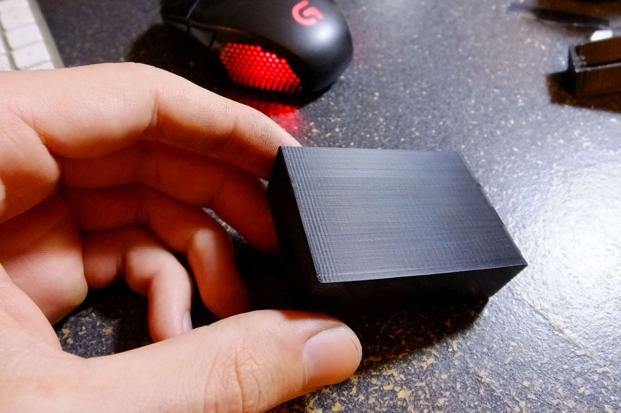

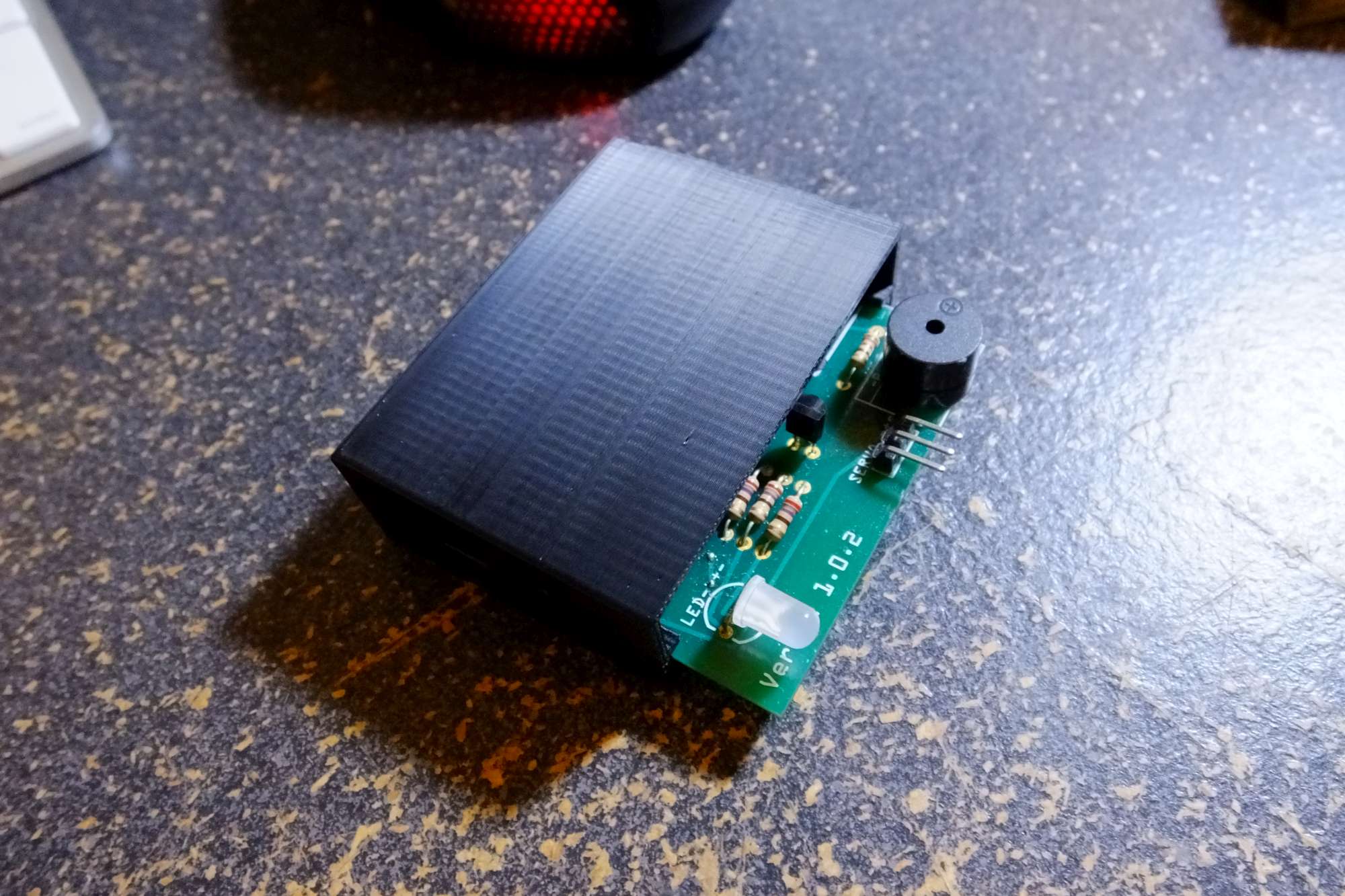

> [@kcchen\_00](#):
> Gapdev is spot on, IMO.
> If you can redesign the wall to be a multiple of your extrusion width that would be best. Otherwise adjusting the extrusion width slightly (+/-.05) can fool S3D into getting a better thin wall fill.
Working on this right now! 😃
I redesigned the box so that all of the walls are a multiple of 3 of the default extrusion width (.6mm). So all the walls are now .070866" thick. The gcode preview looks promising. I’m printing right now! 😃
**Author:** ![mpick67](https://avatars.discourse-cdn.com/v4/letter/m/439d5e/32.png) [@mpick67](https://forum.lulzbot.com/u/mpick67)\
**Post date:** [September 27, 2016, 3:17am UTC](https://forum.lulzbot.com/t/solved-abs-print-issue-blobs-zits-on-final-print-pics/4025/22 "2016-09-27T03:17:42Z")
IT WORKED!!! 😃
The 10th time is a charm! hehe
I would have never figured this out without all of your input! You guys rock!
Shout out to **Gapdev** , **kcchen\_00** , and **DougZ** for all the help! You’re all awesome! 😃
