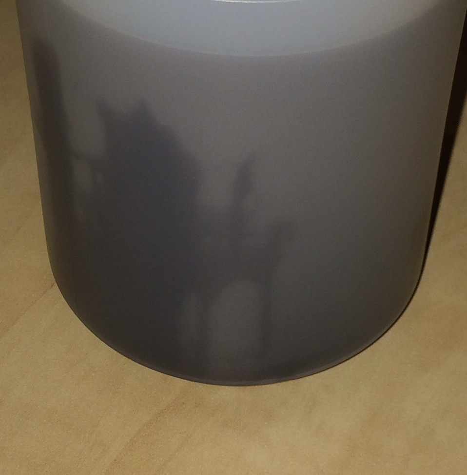

**Author:** ![Vale](https://avatars.discourse-cdn.com/v4/letter/v/9de053/32.png) [@Vale](https://forum.lulzbot.com/u/Vale)\
**Post date:** [November 24, 2014, 2:00am UTC](https://forum.lulzbot.com/t/starter-questions-stuck-to-bed-quality/1012/6 "2014-11-24T02:00:12Z")
When I tried making my slurry, I was using the Shaxon ABS that I purchased. I followed the instructions on the lulz site. What I ended up with is shown in the photo. There’s a lump of ABS goo at the bottom of the bottle and smeared down the side. From what I’ve seen in videos online showing ABS slurry, it shouldn’t look like this. I’m assuming either the new bottle of pure acetone I bought was bad, or the ABS was the problem.
As for getting parts off, after having printed on the bed a couple of times the parts are coming off easier.
It’ll be interesting to see how higher quality filament works out in a couple of days.
