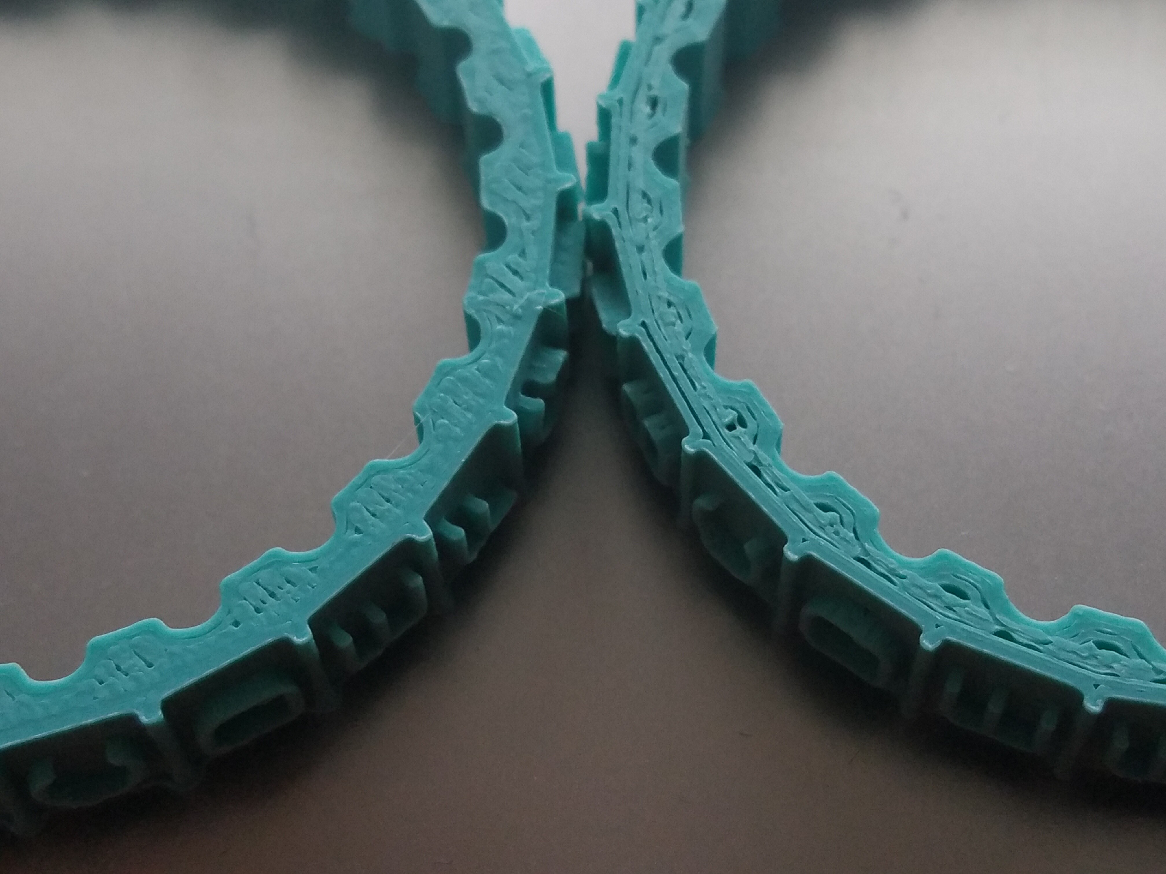

Below are two samples I just did. Left was Cura and right is Simplify3D both printed at .125mm. On the front letters…they are identical as far as I am concerned.
For the side shot - I know there are some settings I can do to adjust the surface fill of the simplify3d… but I have yet to get that worked out.
So for me until I get those configs nailed down…cura is better for flat/non supported items and Simplify is better for organic/supported objects (like my dragon head I did).
If I can get the surface thing worked out…I probably will just use simplify 3d because I like the interface and multiple undos. The PLA I am using is Polymaker Polylite PLA. But Thinking I might try the more expensive village PLA on the site to see if it is worth the extra cost.

I dunno, that dragon turned out smoother than anything I have I ever printed. I am not sure what more expensive filament would buy you.
I want you to know you have ruined this for me! I was perfectly happy with my prints until now. I don’t want to hate you but now, I must! I hope you understand. 😉

Ha…instead lets keep comparing notes. I am sure goal is the same as mine…best prints possible. I don’t care if they take a long time. I just want them to look as good as possible. I think once I get past this initial…have to print every day phase I am in… I will slow down and start going through all the initial test object calibrations they have (that can be downloaded)… hoping to squeeze a little more quality out that way too. And it could be as simple as the filament choice…room temperature…all that stuff too. Go ahead and bite the bullet and get Simplify 3D so I have someone else to bounce quality test/ideas off of. But until I get Simplify 3D more dialed in…or help from someone who knows how to set it up well for a Taz 6…then I will still use Cura for flat edge/unsupported things because I think they have it better dialed with the printer. I have no doubt Simplify 3D can get there too…just so many settings to have to work through.
