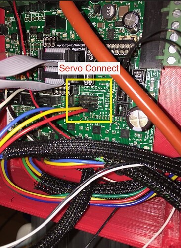

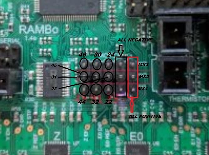

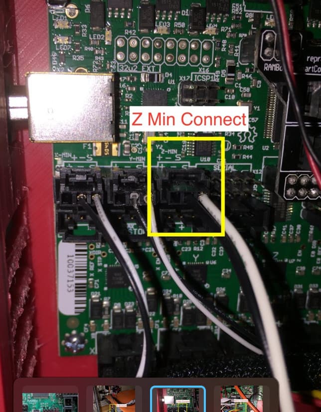

There’s no guide, but the expansion block is the pins in the middle of the board:
 ![image](https://us1.discourse-cdn.com/flex020/uploads/lulzbot/original/2X/5/572b3e228cf44bda5f4f009f74e299d0a68139ef.jpeg)
![image](https://us1.discourse-cdn.com/flex020/uploads/lulzbot/original/2X/5/5c90dc92c60f6af18d19263fde1cc76074104145.jpeg)
You connect pos to the right side, then to 22 and 44 (or 23 and 31; or 24 and 46)
and the ZMIN (not the ZMAX - been a while):
 ![image](https://us1.discourse-cdn.com/flex020/uploads/lulzbot/original/2X/c/c4ff6ff850bb11e6711c50ba2f44cecb196fca59.jpeg)
Then, in Marlin’s code in configuration.h, you enable the BLTouch and bilinear, set your probe points (Rambo runs out of memory if you try and go over 5x5 grid w/Catmull-Rom subdivision set to 3).
In pins\_RAMBO.h, z\_min\_pin should be 10, z\_min\_probe\_pin also is 10, and the servos section should be: (it may already be this by default, but just putting it here)

Also - BLTouch, the polarity on the ZMIN matters, that threw me off for a while when it wouldn’t trigger besides all motion being good.

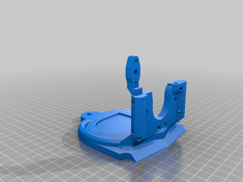

The last item I am trying to figure out is a mount. This one I have on hand as it is the closest to what the original mount looks like.
 ![29309cb71a48b168f9f17bc01071754b_display_large](https://us1.discourse-cdn.com/flex020/uploads/lulzbot/original/2X/3/348c4daaf64697310a58aad6943ac48972001e89.jpeg)
Any thoughts or comments on if this will work with everything else you’ve suggested?
**Post date:** [October 3, 2023, 4:38pm UTC](https://forum.lulzbot.com/t/stock-taz-6-bl-touch-add-on/26038/8 "2023-10-03T16:38:27Z")
For the Single Extruder, I mounted to the fan duct, since it was the smallest part to reprint and easiest to swap. I normally used either a Titan Aero-based extruder for 2.85mm, with a Biqu H2 for 1.75mm, but since I swapped for a 2.85mm Orbiter extruder instead of the Wade Extruder on the Single Extruder, I’m not wanting to go back to the single-geared Aero. Originally it was just for use with extremely flexible materials, but that 2.85mm orbiter dual gear extruder works so well, it may replace the aero completely, even with the old hexagon hot end (with a CHT nozzle).
Anyway, the file is here:
[BL\_fan\_duct\_left\_v0.7.4.1d.stl](https://forum.lulzbot.com/uploads/short-url/jQmzNYe99OvAU1alb9WzneFnbkm.stl) (1.4 MB)

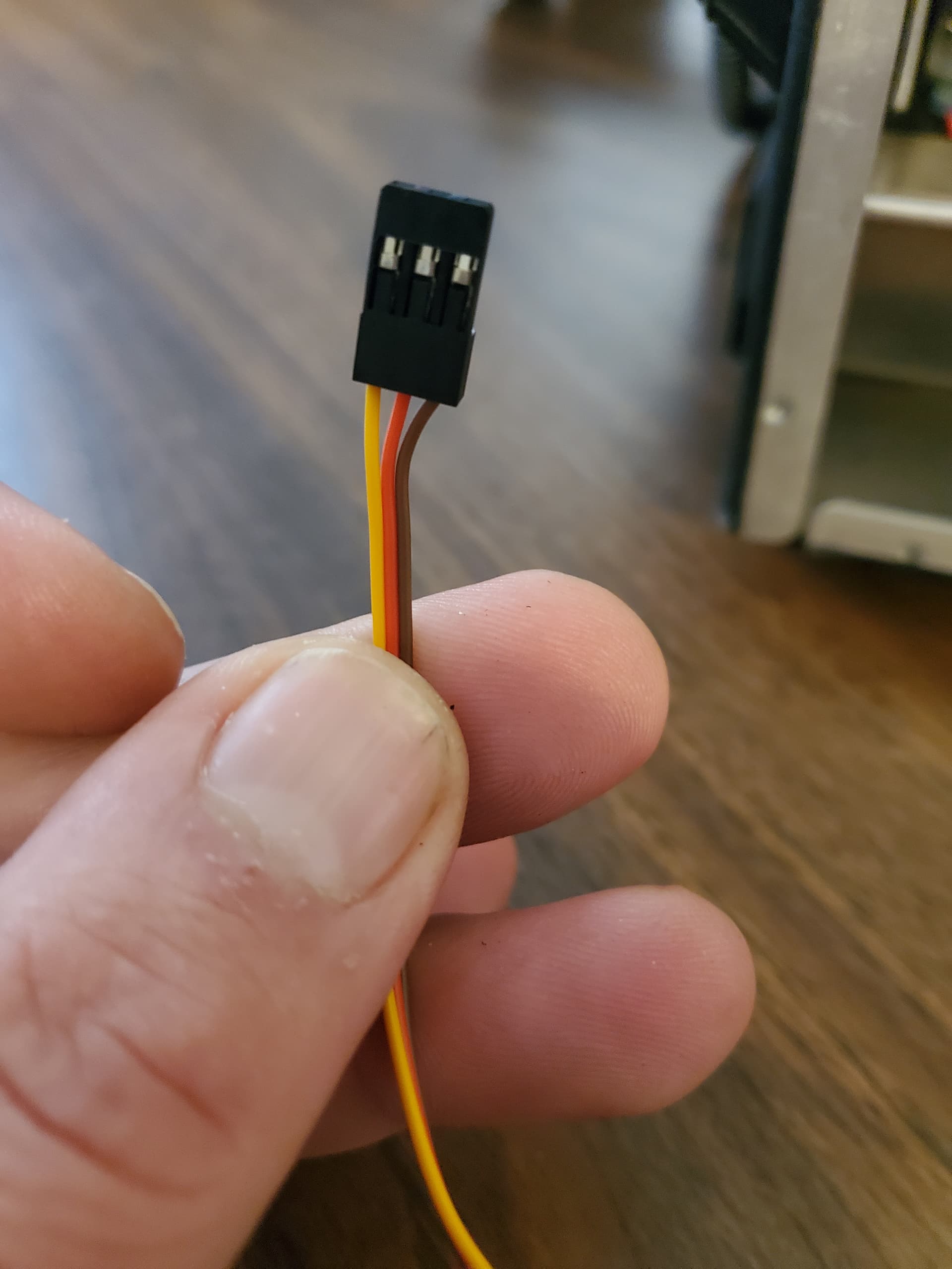

I received the BL touch and was about to start installing. The wire colors are different than in the pics you posted and i was just wondering if you coud help me deicpher which is which. If not, no worries, but you seem to be knowledgeable in this.
 ![20231007_102142](https://us1.discourse-cdn.com/flex020/uploads/lulzbot/original/2X/c/c8499eb7fcfcb9915e4999d6c7c3d24e03a9c7aa.jpeg)
 ![20231007_101302](https://us1.discourse-cdn.com/flex020/uploads/lulzbot/original/2X/7/7a3b15e753728d8044f8ee813157e7c56bc62eeb.jpeg)
**Post date:** [October 7, 2023, 6:40pm UTC](https://forum.lulzbot.com/t/stock-taz-6-bl-touch-add-on/26038/11 "2023-10-07T18:40:51Z")
Brown = blue. Orange = red. Yellow = yellow. The other ones should be black and white. You’ll need some male to female extensions to plug into the motherboard.

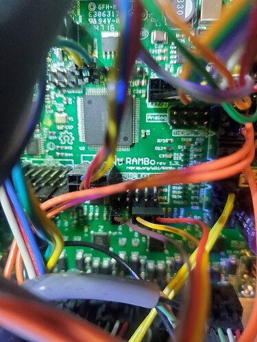

**Author:** ![Samuel](https://avatars.discourse-cdn.com/v4/letter/s/34f0e0/32.png) [@Samuel](https://forum.lulzbot.com/u/Samuel)\
**Post date:** [October 8, 2023, 12:31am UTC](https://forum.lulzbot.com/t/stock-taz-6-bl-touch-add-on/26038/13 "2023-10-08T00:31:54Z")
Does this look correct for adding the BL Touch to a rambo board? The provided picture was a little hard to see but based on Weathernaut’s explanation, this is what i got.
 ![20231007_192903](https://us1.discourse-cdn.com/flex020/uploads/lulzbot/original/2X/6/6e1c922a0bbbdaf1deea1c5b23dec6175956b547.jpeg)
**Post date:** [October 8, 2023, 12:41am UTC](https://forum.lulzbot.com/t/stock-taz-6-bl-touch-add-on/26038/14 "2023-10-08T00:41:46Z")
I don’t think that’s right. Look at page 6 of this document, it’s what I used to install a BL Touch on my Taz 6. It has the colors that match the header your BL Touch has.
> **[Taz 6 BLTouch Upgrade.pdf](https://drive.google.com/file/d/1jZ3FvadJdqG82v1T-xWEx0wQrOXSWvyV/view)**
> Google Drive file.
I ended up using the Drunken Octopus firmware without any modifications except for the number of probe points (I increased to 5x5). DO uses UBL leveling so keep that in mind when setting it up in the gcode.
[https://www.drunkenoctop.us/drunken-octopus-downloader/](https://www.drunkenoctop.us/drunken-octopus-downloader/)
For 5 bucks you can get the password needed to flash the firmware to your machine - you can even do it straight from Google Chrome. I haven’t had much luck with the other varieties of DO firmware but his Taz 6 release with BL Touch works perfectly.
