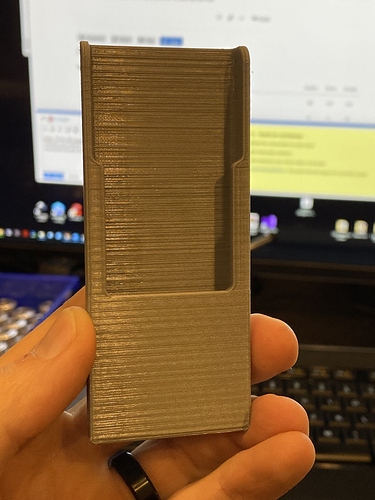

Haha. Thanks @b-morgan. I was talking about potentially using the aluminum extrusions, steppers, controller, bed, and hot end. Then using a z axis design that actually works without translating its movements into all of the other axes causing these awful z banding issues.
Also, there are people that buy trash? Haha, I don’t mean to be a total a$$, but I’d rather rebuild an entire custom printer than attempt to ressurect a printer that clearly has issues. I havent seen anyone post a respectable print on these forums after having “fixed” the z axis issues.
 ![2020-04-30 16.18.35](https://us1.discourse-cdn.com/flex020/uploads/lulzbot/original/2X/c/c1c2df81623a0b8933153fc2ae7f165db273ef56.jpeg)
 ![2020-04-30 16.19.28](https://us1.discourse-cdn.com/flex020/uploads/lulzbot/original/2X/8/87c2b39a6e75cce21229f8a1bfd0b53abbf4dea7.jpeg)

**Post date:** [May 2, 2020, 6:56am UTC](https://forum.lulzbot.com/t/taz-4-conversion-print-quality-z-axis-has-banding/21534/6 "2020-05-02T06:56:06Z")
The Taz 4 5 and 6 are all plagued by the same issue. The Z-axis only has one rod on each side of the printer. Due to this, the lead screw is supporting the X-axis in the x, y, and z directions. Ideally, the lead screw should be floating in x and y.
Possible solutions:
-Convert to a belted Z-axis like the Taz Pro or Mini 2
-Redesign the Z-axis to incorporate two rods on each side
I am currently working on the latter solution and will make a complete guide when it is complete.

**Author:** ![ZRG\_3D](https://avatars.discourse-cdn.com/v4/letter/z/2acd7d/32.png) [@ZRG\_3D](https://forum.lulzbot.com/u/ZRG_3D)\
**Post date:** [May 6, 2020, 10:46pm UTC](https://forum.lulzbot.com/t/taz-4-conversion-print-quality-z-axis-has-banding/21534/10 "2020-05-06T22:46:22Z")
This magic number only works if the steppers are being inaccurate; however, due to the helical nature of the layer variations shown in the picture, this is not the case. In the video :[[https://youtu.be/WIkT8asT90A](https://youtu.be/WIkT8asT90A) ] the layer variation with the non-magic layer print was very irregular, not regular or repetitive like those shown in @jimjamurprint photos.

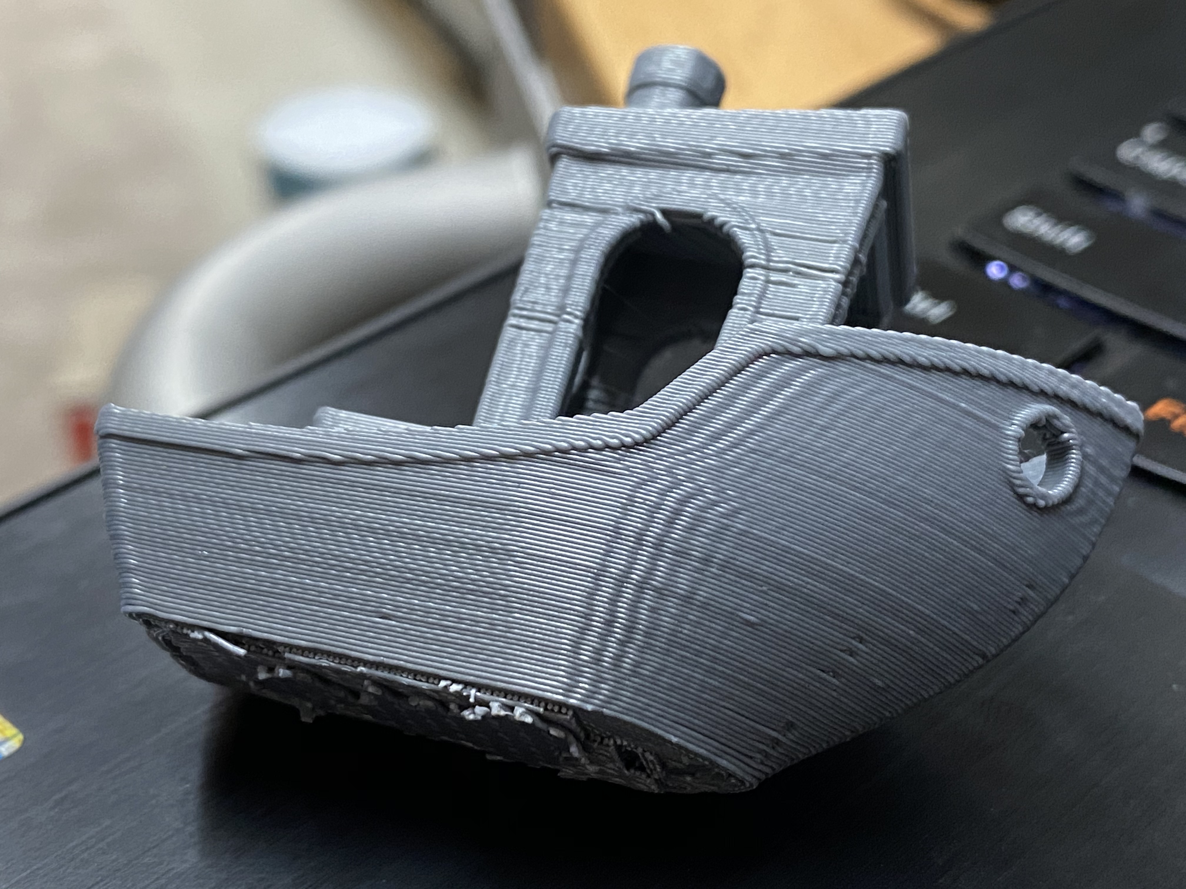

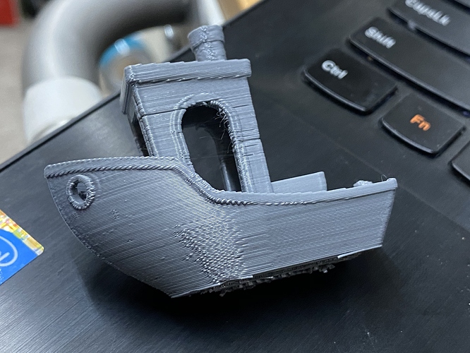

**Post date:** [May 8, 2020, 4:29am UTC](https://forum.lulzbot.com/t/taz-4-conversion-print-quality-z-axis-has-banding/21534/15 "2020-05-08T04:29:27Z")
Since I’m nearly ready to trash this printer, I decided to take some cheap measures to see what I could get out of it. I took the z-axis lead screw bearings out so the lead screws could freely wobble. While I had the axes taken apart I also cleaned the lead screws and re-lubed them. I also loosened the [z-nut-mount](http://download.lulzbot.com/TAZ/5.0/production_parts/printed_parts/z_nut_mount/) from the z-nut. This seems to allows the z axis to wobble like hell and the x axis remain unaffected.
For the longest time I thought my bed was warped, but as I have been lurking around the forums it has come to my attention that the “warp” is really the x-axis smooth rods bending because of this behemoth of a direct drive setup. I’m planning on building a new 3D printer, if it happens to be this TAZ being fixed or an entirely new setup doesn’t matter all that much to me. Either way, I wanted it to be a bowden setup. So I ordered an E3D clone, a real E3D throat and set off on a design to lighten up the x carriage. This is what I have accomplished so far:
- I moved the extruder stepper to the left x-axis plate so it is “flying”.
- I 3D printed some linear bearings. The old Igus ones on the x axis are shot (temporary).
- Custom X-Carriage to hold the E3D clone.
- New cooling fan, mount, and nozzle.
- A real E3D hot end cartridge (replaced the crappy resistor from the hexagon)
- Custom spool holder to lower the spool down closer to the bowden extruder.
I have tried to design everything with the thought that it can be used on a different printer if need be. The only part that is not reusable is the mount for the flying bowden.
My “bed warp” is gone 🙂, I’m fairly certain my x-carriage is less than half the weight of the original because the extruder stepper is no longer being slung around.
I rebuilt Marlin 2.0, that was interesting. These RAMBO boards are fun. I like the digi pots.
Anyways, I moved to stock Cura, trying to get a decent profile built for the new hot end. Here are the results of a Benchy print. Z-axis banding is mostly gone, but ringing is still prevalent. My extruder needs more tuning as far as steps are concerned, I have a fair bit of under extrusion. After this print I did tune the retraction a bit more, so near the top of the benchy when a lot of retractions are happening should look better the next time I go to print one.
Any thoughts on getting rid of the z-seam zits / blobs in the cura profile?
What about the ringing?
Other thoughts?

**Author:** ![George](https://avatars.discourse-cdn.com/v4/letter/g/71e660/32.png) [@George](https://forum.lulzbot.com/u/George)\
**Post date:** [May 8, 2020, 9:51pm UTC](https://forum.lulzbot.com/t/taz-4-conversion-print-quality-z-axis-has-banding/21534/16 "2020-05-08T21:51:15Z")
For ringing: [https://itworks3d.com/product/taz-frame-reinforcement-kit/](https://itworks3d.com/product/taz-frame-reinforcement-kit/)
