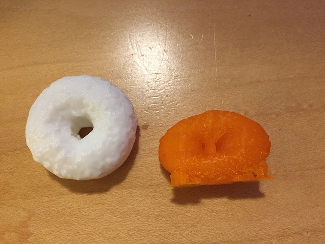

I’ve been playing with the settings, but had to revert back to the older 2014Q2 firmware. For one reason or another I can’t get the latest version to print properly even after calibrating the extruder feed rate. With the newer 2014Q3 firmware, the z-axis isn’t moving up properly so my prints are “squished”. I’ve attached a picture of 2 donuts that I printed. The one that looks normal was printed with the older firmware. The newer one was printed with the new firmware and is about 1/2 the size of the properly printed one.
Anyone else experienced this issue?
The Z steps changed going from the Taz 3.2 to the Taz 4. The Taz 4 is the one with the fully supported leadscrews with bearings top ad bottom and aluminum Z couplers. If you happen to have the slightly older 3.2, the new firmware will not have the correct z steps value in it to work with your existing threaded rod. If you have a Z Nut spring instead of the solid leadscrew mount, you might be dealing with something older than a Taz 4.
