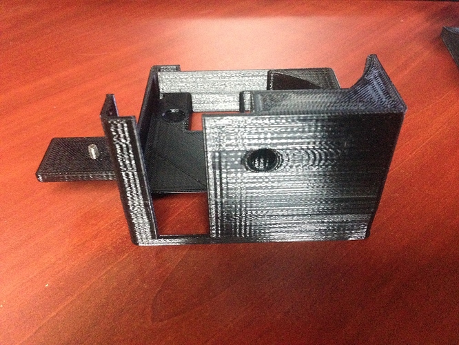

This thread goes along with my post about [TAZ 5 PLA random clogging issues and a solution.](https://forum.lulzbot.com/t/taz-5-pla-random-clogging-issues-and-a-solution/1661/1) I needed to create a way to provide a serious amount of cooling for my TAZ 5 / Hexagon hotend. The little “squirrel cage” fan was just… cute. No offense to the Taz designers! I LOVE my machine 🙂 But seriously, that small fan was way too small, and it was actually really noisy. So, as all good do-it-yourselfers would do, I designed and printed my own along with a Filament Tube Retainer.
The Filament Tube Retainer is a modified version of [http://www.thingiverse.com/thing:766614](http://www.thingiverse.com/thing:766614) created by Wolfie, and the fan shroud is my original design.
The intent of the shroud is to provide as much air flow across the cooling fins right above the heater block in the hotend itself, while preventing any airflow across the heater block. I also wanted to provide some additional air flow across the entire filament feed assembly, but I wanted it to look and feel as if it were a stock item. The shroud itself went great, but I realized that I wanted to keep the filament tube retainer that I had (Wolfie’s design), plus I needed a way to anchor the top of fan shroud. Slight design change = win.
As promised, here is the link to the .stl files and the Cura profile I used to print this. They’re over at [Thingiverse](http://www.thingiverse.com/thing:783515)

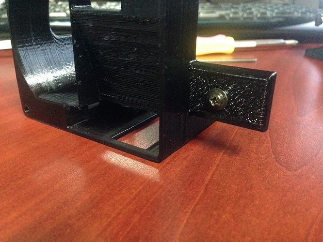

Here’s some pictures of the shroud itself. I printed it using PLA. I figured I’d really get to see if the clearance around the hotend was enough if the PLA didn’t melt 🙂

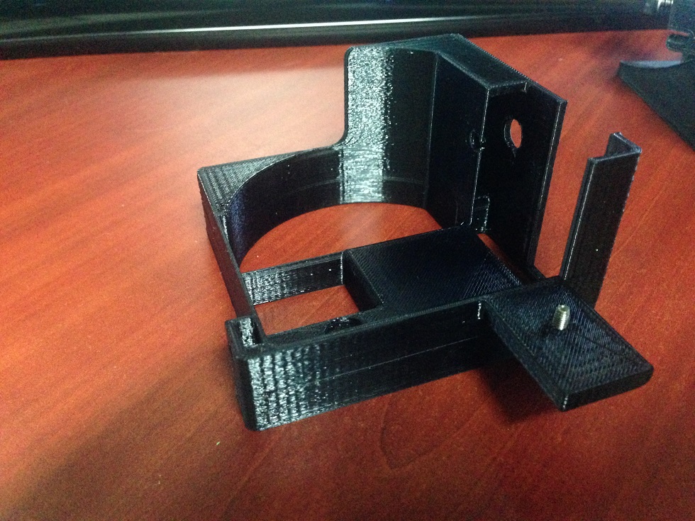

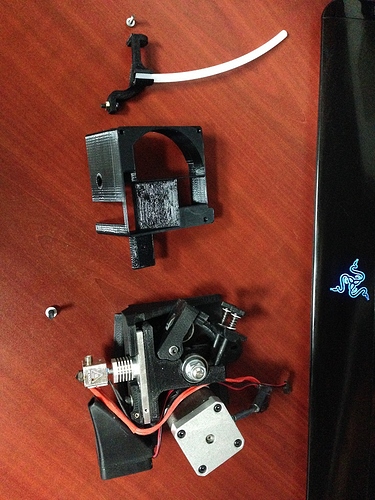

Here’s the Filament Tube Retainer on the left, the Fan Shroud in the center, and the stock extruder assembly on the right.
 ![Parts.JPG](https://us1.discourse-cdn.com/flex020/uploads/lulzbot/original/2X/2/223c398313e1fe9dc94d53197f264afd41eabaa7.jpeg)

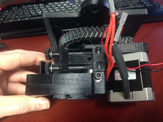

And here it is assembled:
 ![Assembled Shroud.JPG](https://us1.discourse-cdn.com/flex020/uploads/lulzbot/original/2X/1/1bcac4655063c4c0db41b4186e1ffc5dbe8333fe.jpeg)

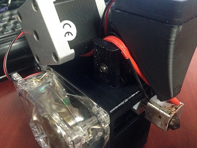

The mounting points of the fan shroud are 3 existing points on the extruder assembly. The stock “squirrel cage” fan will need to be removed completely, and is no longer needed.
The first one is the small unused threaded hole just above where the “squirrel cage” fan was.
 ![Mount Point 1.JPG](https://us1.discourse-cdn.com/flex020/uploads/lulzbot/original/2X/1/1f7eac91e6cc086d646cddc71fea4b88492bdba8.jpeg)
 ![Screw In Place 1.JPG](https://us1.discourse-cdn.com/flex020/uploads/lulzbot/original/2X/e/e46bbea84af61ca533207c7743a4fcb529f63eb2.jpeg)
The second uses the stock bolt the holds the hotend base left side:
 ![Mount Point 2.JPG](https://us1.discourse-cdn.com/flex020/uploads/lulzbot/original/2X/a/a3a314335298758ad70ca71eb9eb5dc59cc4ee4b.jpeg)
 ![Screw In Place 2.JPG](https://us1.discourse-cdn.com/flex020/uploads/lulzbot/original/2X/3/3d70cf989987c1013f66a7f2afe128b024f120a3.jpeg)

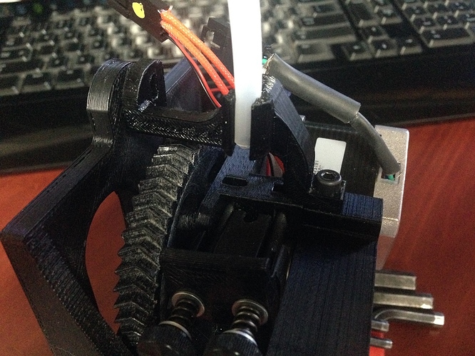

And the third attaches to the filament tube retainer:
Showing where the filament tube retainer mounts to the stock extruder assembly
 ![Mount Point 3.JPG](https://us1.discourse-cdn.com/flex020/uploads/lulzbot/original/2X/8/8063acfe80c43f6fe6659bb64b6605341d470a35.jpeg)
Showing the mounting bolt (on top of the fan shroud) for the filament tube retainer
 ![Screw In Place 3.JPG](https://us1.discourse-cdn.com/flex020/uploads/lulzbot/original/2X/0/0b61656148263b46e1d1f1475d6c4151f06a17a6.jpeg)

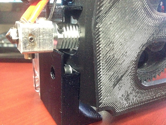

And finally (because I haven’t tortured you with a long enough post yet 🙂 ) pictures of the filament tube retainer,venting, and hotend clearance.

 ![Hotend Clearance 1.JPG](https://us1.discourse-cdn.com/flex020/uploads/lulzbot/original/2X/a/a02f45a695e55367b286051e2b8229e463c866d6.jpeg)
 ![Hotend Clearance 2.JPG](https://us1.discourse-cdn.com/flex020/uploads/lulzbot/original/2X/4/4423fd6860d95b4200271dda353c33f62b468e48.jpeg)
 ![Hotend Close-up.JPG](https://us1.discourse-cdn.com/flex020/uploads/lulzbot/original/2X/6/693ee2f56291c4dab1a975bfce0923b0efba031e.jpeg)

And finally, the whole assembly.
 ![Fan Mounted 1.JPG](https://us1.discourse-cdn.com/flex020/uploads/lulzbot/original/2X/0/01fee2cad9e51e8a58f76aa974d54dfe708aab2e.jpeg)
 ![Fan Mounted 2.JPG](https://us1.discourse-cdn.com/flex020/uploads/lulzbot/original/2X/d/d7d08143f6ba436fa1bd88ce7a49b5dea798a584.jpeg)
 ![Fan Mounted 3.JPG](https://us1.discourse-cdn.com/flex020/uploads/lulzbot/original/2X/a/aff611195a207ab33b0aad8faa65bb6e28d21de7.jpeg)

I think you could do a slightly improvement on the fan holder by extending the pointed part 25mm towards the hotend… this would avoid air getting into the hot end itself, constraining it to the cooling part…
 ![improvement.png](https://us1.discourse-cdn.com/flex020/uploads/lulzbot/original/2X/b/b076553e830f10c436a2bd758d8dcc6ba5b2eb50.png)

Great point! I’ve had a couple others suggest that for “Rev. 2” as well 🙂
I did the design in Solidworks, and I’m using GOM Inspect to convert the .stp file to a .stl file. There’s a couple other things I’ll be changing in the next version.I want to make more clearance for the small knob that tightens the filament bearing, and I’ve been considering a change to allow for either a left side (mirrored) nozzle cooling fan assembly, and/or a special cooling manifold design I’ve had rolling around in my head.
Thank you for the suggestion on the changes! I think since that’s what it needs most, I’ll make that change first, and work on the rest after that’s been improved. I’ll make sure I update the thread when I get the new file(s) put on Thingiverse.

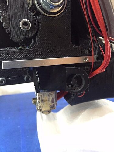

I was having PLA heat creep problems as well… found this thread, BUT didn’t have a 80mm fan laying around and needed to finish multiple large print ASAP.
The solution I found:
Take a 2" long piece of electrical tape and put the tape on the edge of the OEM micro fan (taz5) and continue to wrap it about 50% around the heatsink. This forces the air to circulate better around the heatsink. It seems like the OEM fan is just blowing on the left side of the fins, where as adding a simple piece of tape forces the air in a semi-circle.
Just printed a few 20 hour prints, no problems - where as before I couldnt get more than a few hours in.
I have a ton of large prints coming up. I’ll report back if I run into further heat problems…
Cheers.

I did this as a quick fix. My PLA prints kept jamming abour 2-3 hours in. Quick tape mode and I finished two 7 hours PLA prints with no problems.
