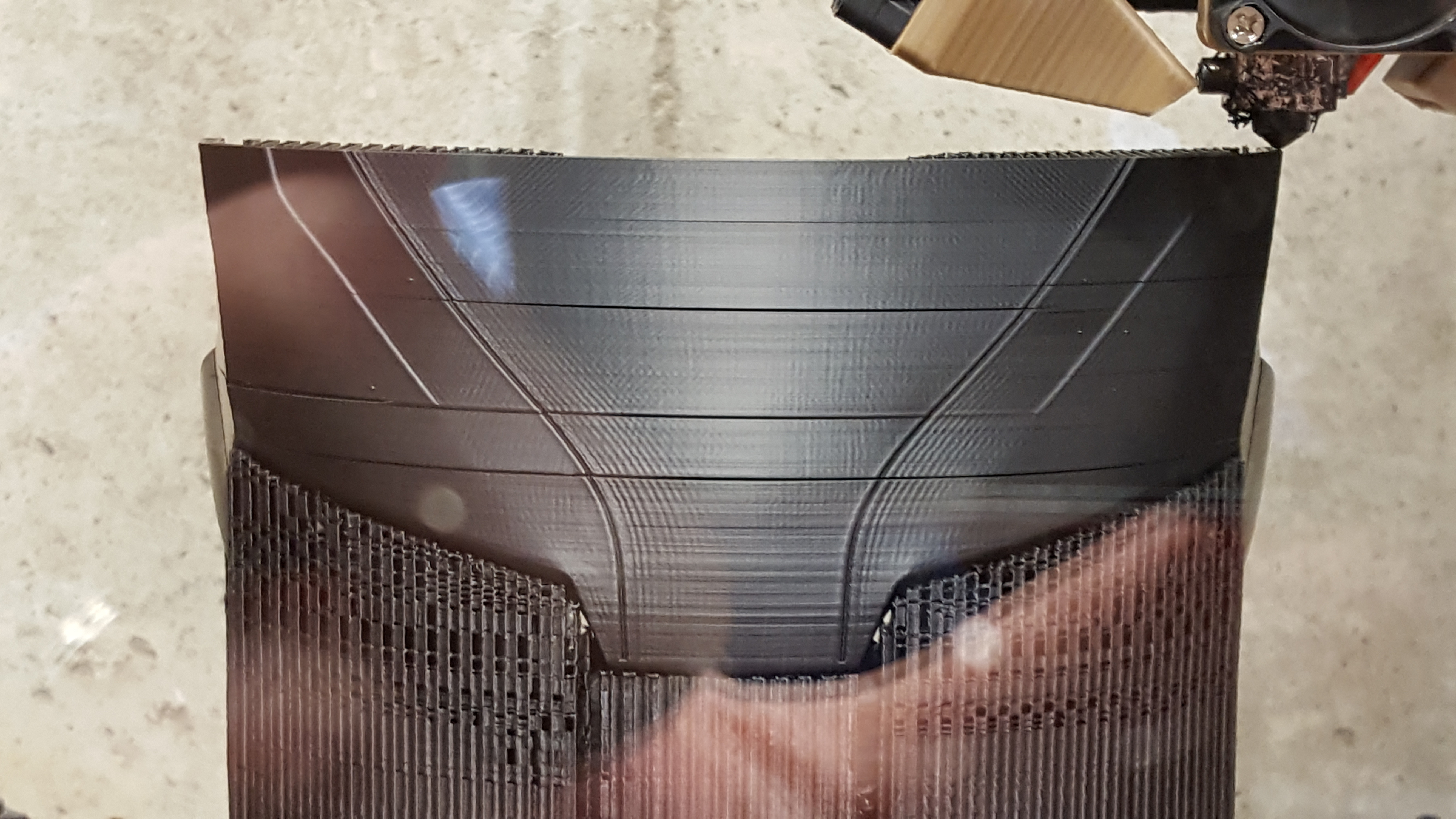

I’ve been having issues with ABS cracking on large prints. I’ve built a cat guard that seems to be helping some but I’m still not getting the desired result. The picture attached shows the issue. I’m printing fairly slowly at 75% infill. Should I turn off my extruder fans and try again? This print has taken almost 2 days to reach this point (using the abs fine profile from the lulzbot site) with a 0.35 mm nozzle so I’d rather not start over without a solid guess on a fix. I was considering piercet’s open rail build as my next mod to see if that will help.
Also, would I be safe cranking up the speed/acceleration or should I stick with stock settings?
Thanks for any suggestions.

**Post date:** [June 1, 2016, 11:31pm UTC](https://forum.lulzbot.com/t/taz-5-abs-cracking-even-with-cat-guard-next-steps/3528/2 "2016-06-01T23:31:04Z")
The only fan that should be on is the single one blowing onto the heat break, the side ones should not. Also let your printer sit for about 10-15 minutes after it has heated up. This will allow the chamber to heat up as well. You can try increasing the print temperature slightly as well to get better layer adhesion.

**Post date:** [June 1, 2016, 11:38pm UTC](https://forum.lulzbot.com/t/taz-5-abs-cracking-even-with-cat-guard-next-steps/3528/3 "2016-06-01T23:38:59Z")
The layers at the bottom aren’t having any issues so time heating isn’t really a factor. These lines are over 24 hours into my print. And I’ve had this issue printing at both lower end and higher ends of the ABS spectrum.
**Post date:** [June 1, 2016, 11:43pm UTC](https://forum.lulzbot.com/t/taz-5-abs-cracking-even-with-cat-guard-next-steps/3528/4 "2016-06-01T23:43:55Z")
Bump your print temp up 5 degrees and reprint until it stops doing that.
**Post date:** [June 2, 2016, 12:08am UTC](https://forum.lulzbot.com/t/taz-5-abs-cracking-even-with-cat-guard-next-steps/3528/5 "2016-06-02T00:08:06Z")
Also if that is a 24hr print you are using super fine layer heights which aren’t necessarily needed for an object of that scale.

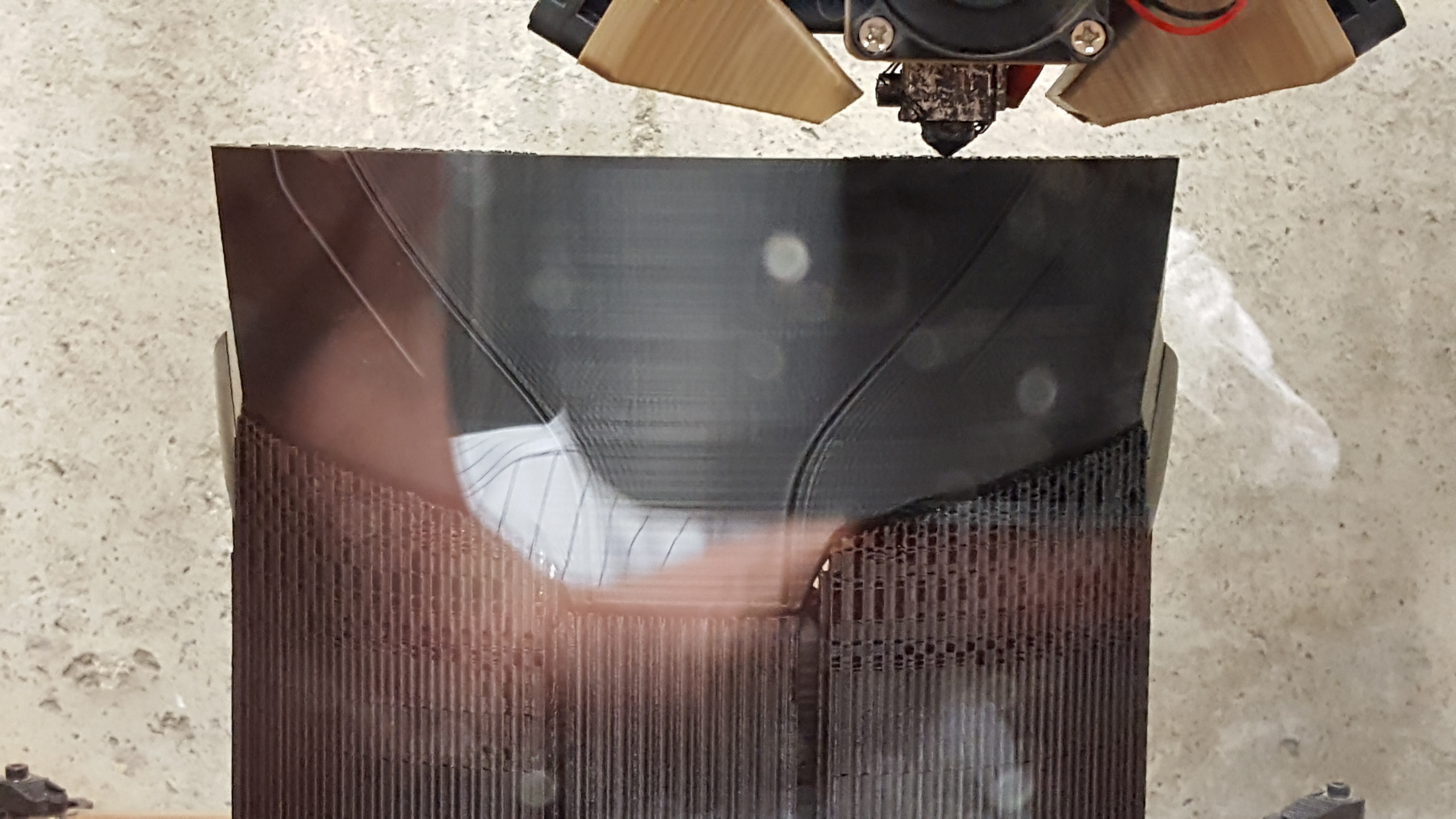

**Post date:** [June 3, 2016, 8:52pm UTC](https://forum.lulzbot.com/t/taz-5-abs-cracking-even-with-cat-guard-next-steps/3528/15 "2016-06-03T20:52:35Z")
Thanks for all the recommendations, folks. My print is now well past the point where I’ve been getting splits. I raised my temp by 10 degrees and turned off the fans. A picture with results is below. I now feel like this is dialed in enough to continue my project which will take a couple months of steady printing to complete. At least until I make some upgrades that will let me move at warp speed with less wobble like some of yours.

**Author:** ![gghouck](https://avatars.discourse-cdn.com/v4/letter/g/a88e4f/32.png) [@gghouck](https://forum.lulzbot.com/u/gghouck)\

Use thicker layers and look into acetone vapor polishing.
