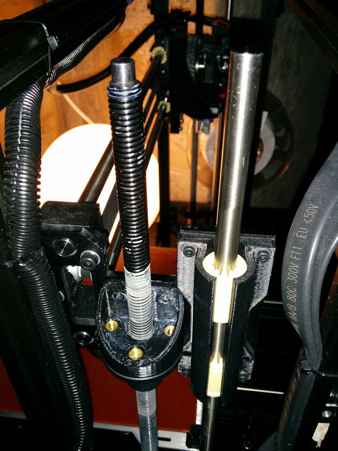

Well… I decided to remove some parts to see if the “click” would stop, I couldn´t stand it anymore.
First, I removed the top part that joins the two Z axis at the left side (one smooth, one screw). I totally would have betted that this was the part where the noise was originated, but it was just my perception, the noise continued:
 ![IMG_20151030_232522.jpg](https://us1.discourse-cdn.com/flex020/uploads/lulzbot/original/2X/d/daeed07832ec6e01ed1360dc55fd9a9f43d29371.jpeg)
So after having removed the top, I went on and removed this other part (in red). This HAD to be the source!!
 ![IMG_20151030_232529.jpg](https://us1.discourse-cdn.com/flex020/uploads/lulzbot/original/2X/6/6e28a89076c0c4700294fbe742b0cb0e9ccce827.jpeg)
And finally, the noise stopped. I carefully analyzed that part, and the only strange thing I saw was some minor errors that I removed with sanding paper. I left the hole totally rounded, in case it could be touching the screw bar when rotating (NOTE: You can notice that the noise appears when the screw makes a full round, so it made sense somehow).
I put the part back on its place with a smile on my face, screw it again and the noise re-appeared!!
There is nothing there, I swear, only lithium grease. Nothing that could make that strong, metallic CLACK sound.
I only found one similar case (the noise is the same) but I don´t understand what he says and there is no solution or something…
Someone…? Please, give me any info before I start removing other parts, break the TAZ and kill myself 😲

Well, finally the problem was found. And had nothing to do with the rod nut, my fault.
The click noise came from the left coupler on the Z axis, because it´s broken.
 ![IMG_20151104_174134.jpg](https://us1.discourse-cdn.com/flex020/uploads/lulzbot/original/2X/2/245811bfb29a8c74256eb1337f9eaded4ad04803.jpeg)
 ![IMG_20151104_174153.jpg](https://us1.discourse-cdn.com/flex020/uploads/lulzbot/original/2X/d/da56e681ae90081bbea5b9cb23284dbaec151112.jpeg)
 ![IMG_20151104_174806.jpg](https://us1.discourse-cdn.com/flex020/uploads/lulzbot/original/2X/1/1e46b71fcee9a569d1f5ee8922b0e683e1f156d8.jpeg)
I wonder how did I managed to apply so much pressure in this piece after only a month… ❓
**Post date:** [November 4, 2015, 10:01pm UTC](https://forum.lulzbot.com/t/taz-5-click-noises-on-z-axis/2399/16 "2015-11-04T22:01:38Z")
Wow, I can see the crack in that video i had you post now that I know where to look for it, but thats definitly a hard to see break. Glad you got it figured out though!
For what its worth, your motor is at a slight angle to the leadscrew. Thats probably what caused the break. It should be directly in line, and all the spring gaps should be even.
