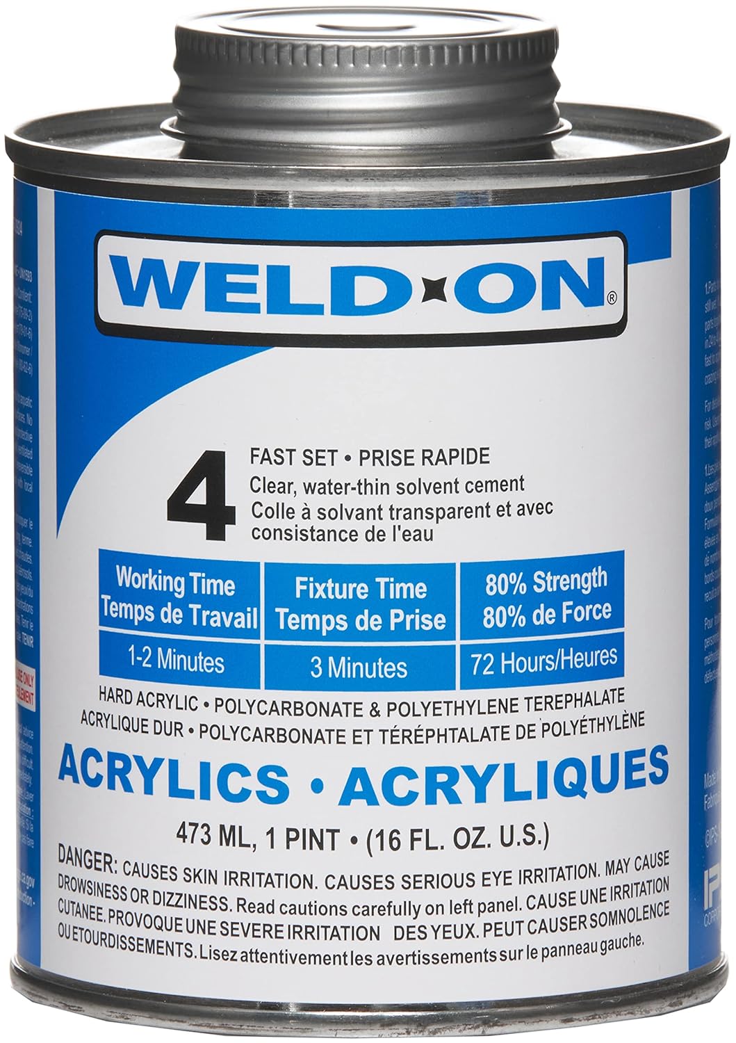

If you can’t clear a nozzle with cold pulls and you are running PLA, you can soak it in Scigrip 4 to dissolve the PLA. I have not had ANY luck dissolving PLA with anything else. Scigrip 4 is to PLA what acetone is to ABS. Use gloves and ventilation, it contains nastyness.
I just drop my nozzles right in the can with tweezers and let them soak at room temp for several hours.
> **[SCIGRIP 10307 4 Acrylic Solvent Cement, Water-Thin and Fast Setting, Clear, 1...](https://www.amazon.com/SCIGRIP-Acrylic-Solvent-Cement-Water-thin/dp/B000KZUTEM)**
> SCIGRIP 4 is a water-thin, non-flammable, moderately fast-setting solvent cement for bonding acrylic. It will also bond with other thermoplastics such as polystyrene, CAB (cellulose acetate butyrate), PETG (polyethylene terephthalate glycol) and...

Thank you for the suggestion, added that to my amazon cart and will purchase it when I buy more stuff.
