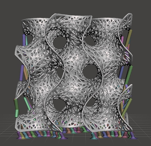

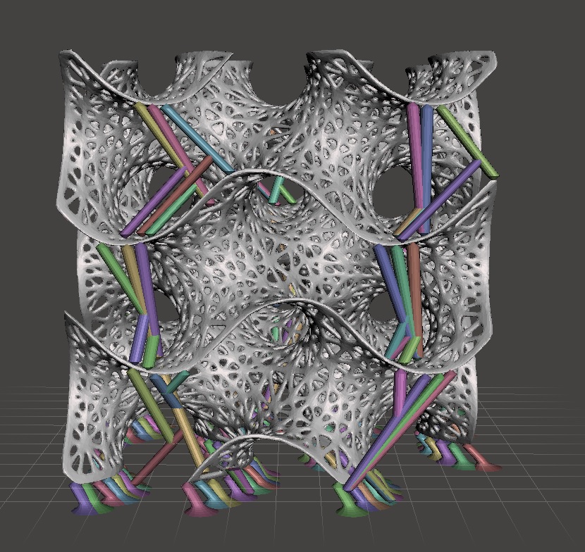

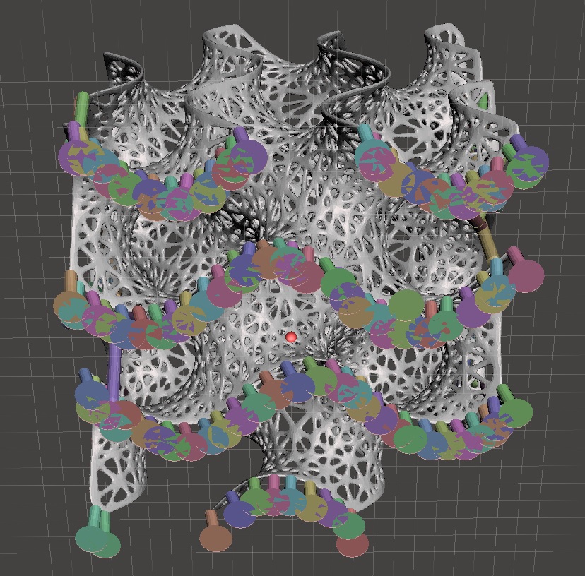

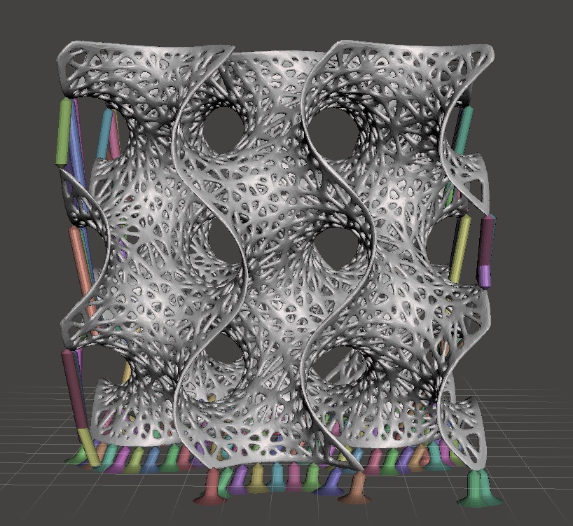

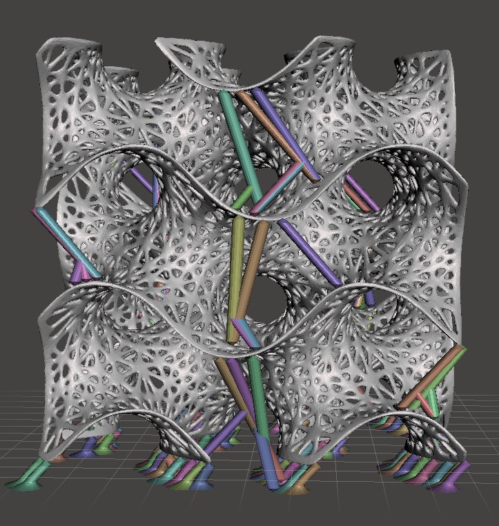

Afternoon 3D printers,
Here is a design I have recently printed. This object is called a Gyroid and was quite tricky to print due to the thin
and fragile nature of the print plus the large amount of overhang.
I tried various methods to support the overhanging parts of the structure. In the end I added custom support using Meshmixer. I
have attached a bunch of screen shots showing the support added.
The design was printed in ABS and spray finished with a bronze spray paint.
Hope you like,
Dave
